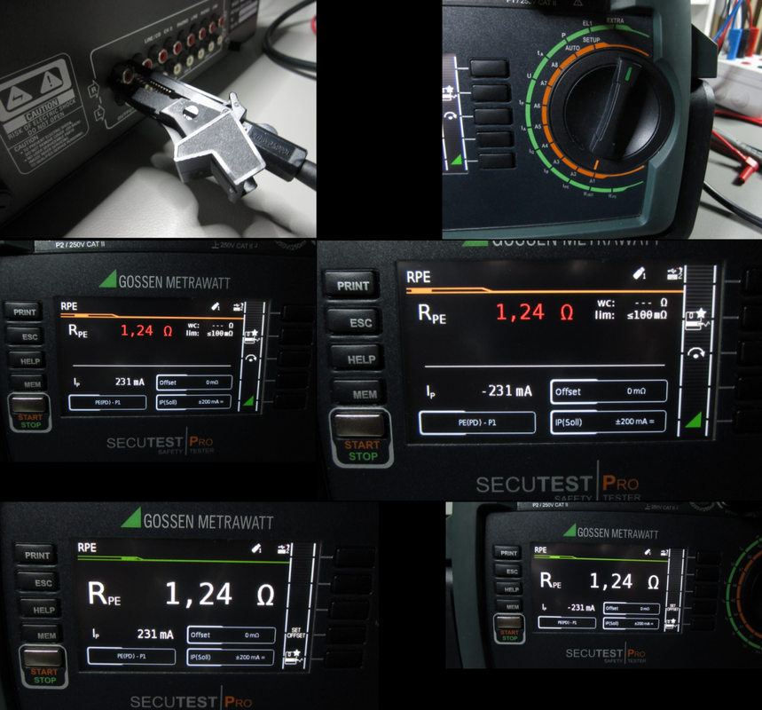

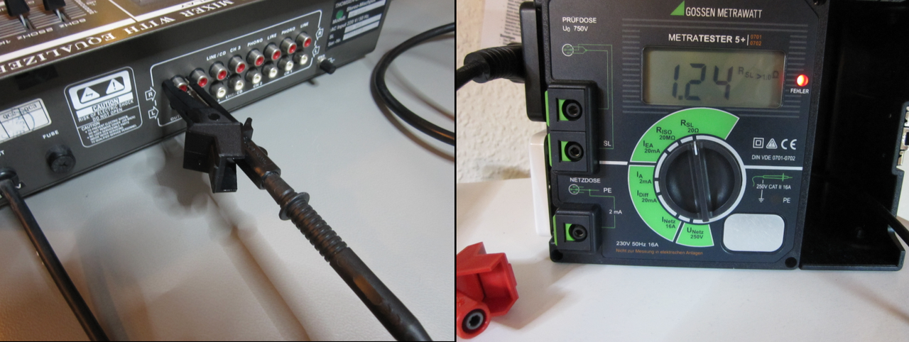

This topic is too big, to write it down in one sentence, because anyone should have a pat tester: I couldn't believe it myself, how many electrical things in my household are rubbish and does not stand the simple PE test - and here comes another one, which I have used daily so far with my computer, as it runs without a problem: My first DJMixer!
Just as an example: This DJMixer, which is Class 1, does not stand the PE test, thus it is not save to use any longer and needs a check up!
Good to see, that both of my pat testers are showing the same values:
The Metratester 5+ (the black power outlet is only for testing purposes without mains, the white is with mains)
The Secutest Pro gives you two possibilities: The "Red Ring" is for one of several automatic test sequences such as the EN62368 for instance with saved limits, here: less than 100mOhm. When the result is above the limit and therefore not shown in green but red, you have to abort the test and cannot go any further (if you want to pay an extra sum, GMC sells you the ability to bypass this, to go any further). I could change the limit, to bypass this, but does not want to, as it is not save and correct to do so...
However, the "Green Ring" is the manual test of the Secutest Pro, which can be compared with the "Metratester 5+" itself. No measured value is coloured in "green" or "red", but simply "white" and you have to estimate the result on your own or whether you want to test any further...

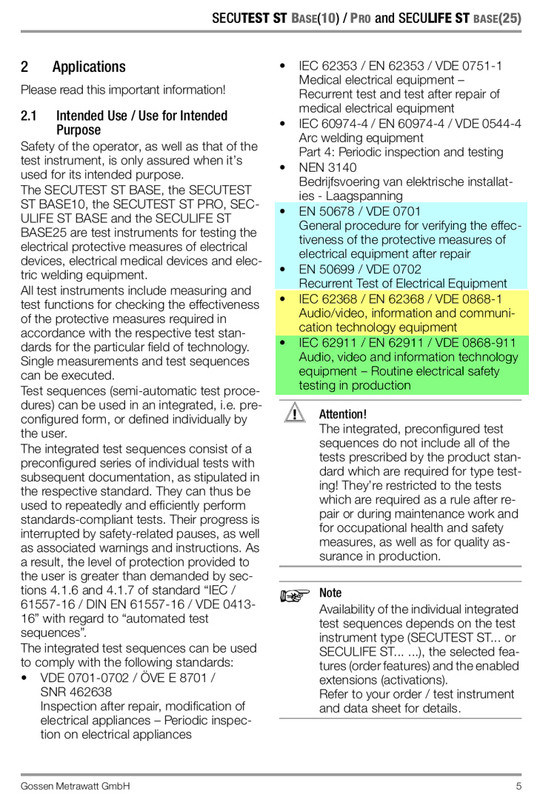

There are special European Norms for testing Audio-Equipment EN62368 and EN62911 (production line) together with the known EN50678 (after repair) and EN50699 (recurrent tests):

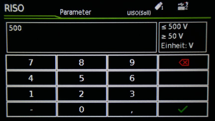

3. some pat testers can only measure with 500V (Fluke 6200-2), but other units are also able to measure with 250V (Fluke 6500-2, Benning ST 725) or the way you want from 50V to 500V (Secutest Pro), to treat sensitive components with care

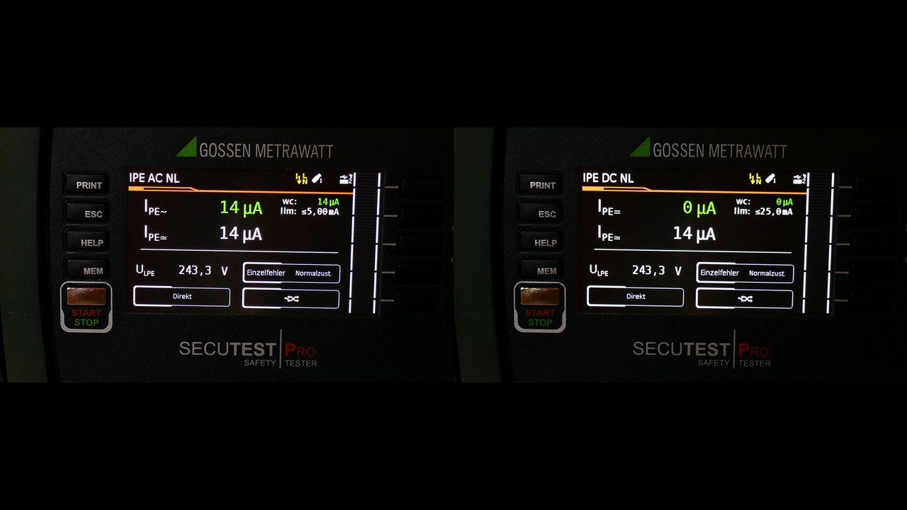

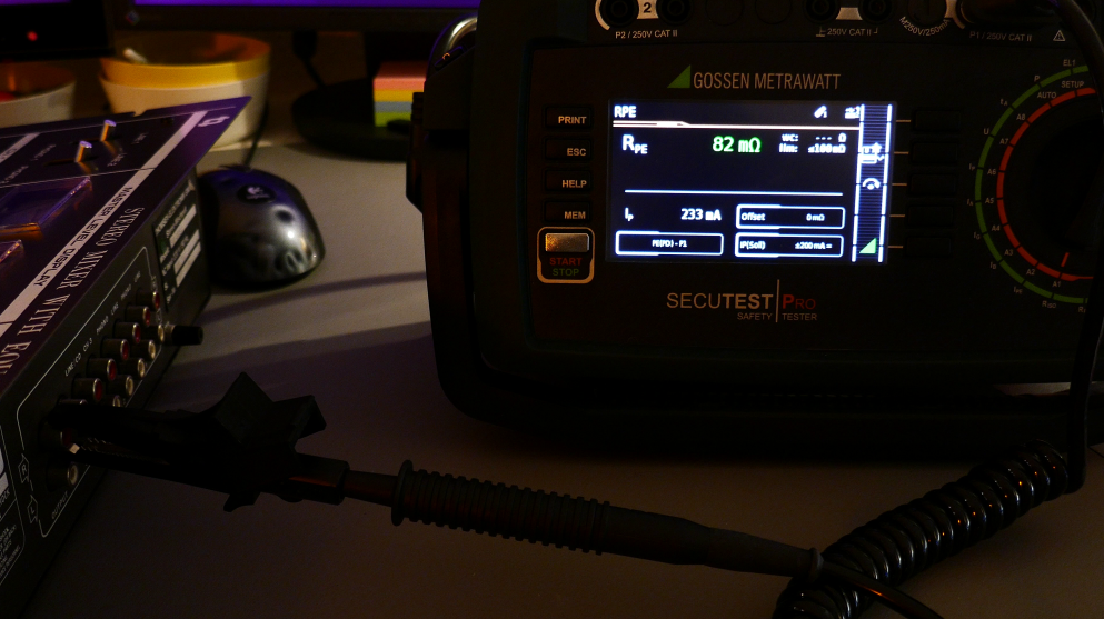

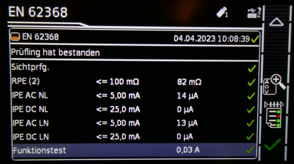

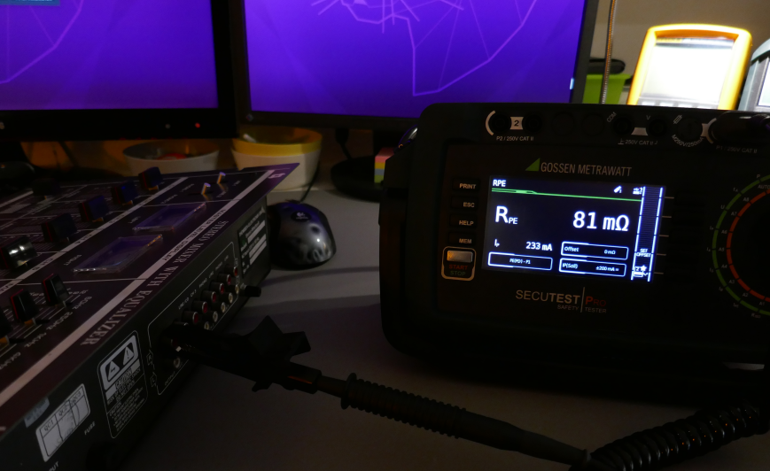

As my DJMixer is +30 years old, I was surprised, that the power cord with its poor quality, togteher with a bad earthing point, was the reason for the bad PE resistance test. After solving these issues, I can now show the rest of the EN62368 testing procedure, since the value is now smaller than 100mOhm...
Manual measurement of R PE - showing no limit:
..., before starting the auto test sequence EN62368, so that you know, that it will most likely succeed...
R PE - now with limit:
I PE AC NL & DC NL:

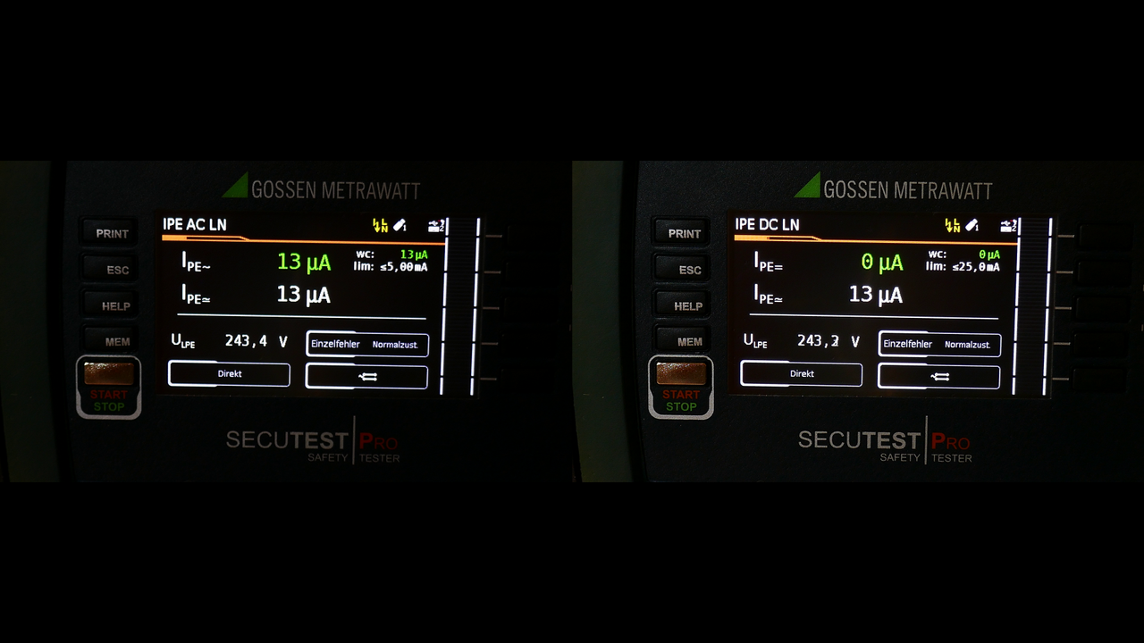

I PE AC LN & DC LN:

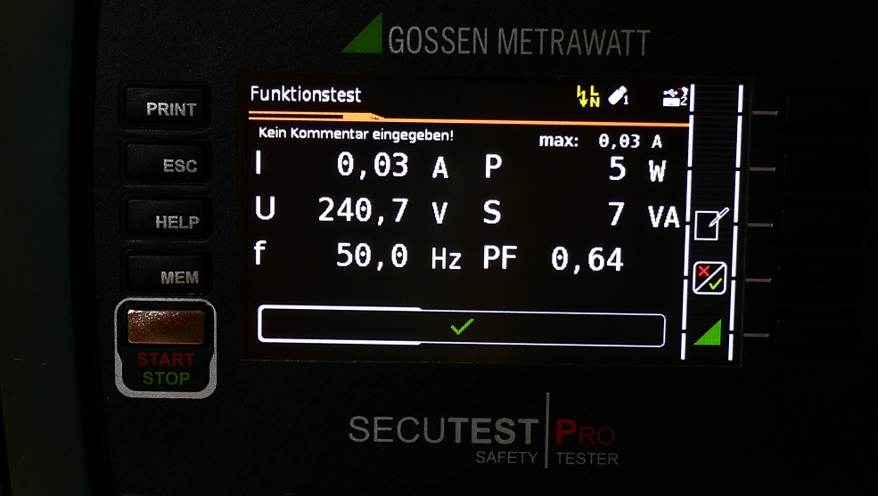

Function test:
Summary of the result:
Cheers!  ;)

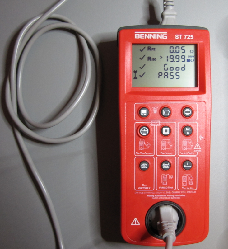

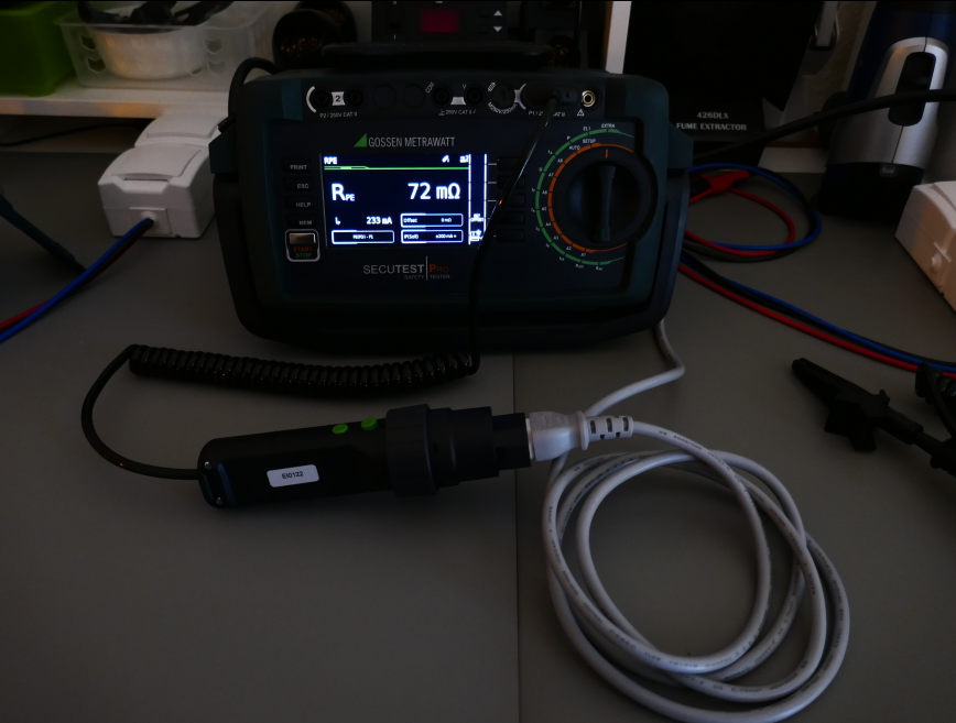

Yes, money is always the decisive factor! However, even more important is the wording: Don't save at the wrong end! "In german we say: Nicht am verkehrten Ende sparen!"

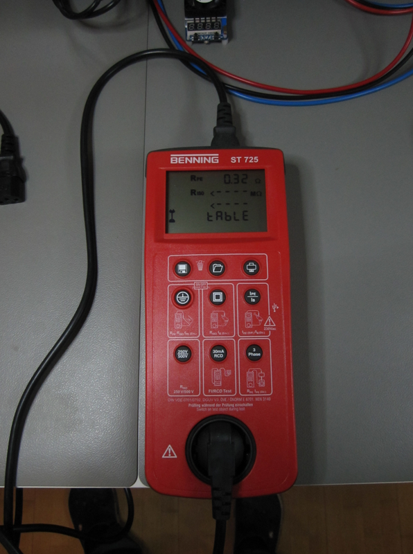

My example: As I wanted to save money I bought the cheap ZD-915 desoldering station from a german reseller for about 80 Euro. You cannot expect any build quality for this price, BUT you should at least expect promised material with 0.75mm² copper inside, to ensure safety. I have never ever seen such a bad PE resistance for such a short length of power cord shipped with this package...
With this power cable it is impossible to pass any test and this does prove, that any sticker, which should guarantee safety is bullshit! The cable is marked 0.75mm², but this cannot be the case with 315mOhm:
When something goes wrong, it is always a chain of unhappy circumstances, but when it happens, you would like to be on the safe side!
This power cord is from my Weller Solder Station and has the same length and thickness, but only 72mOhm:

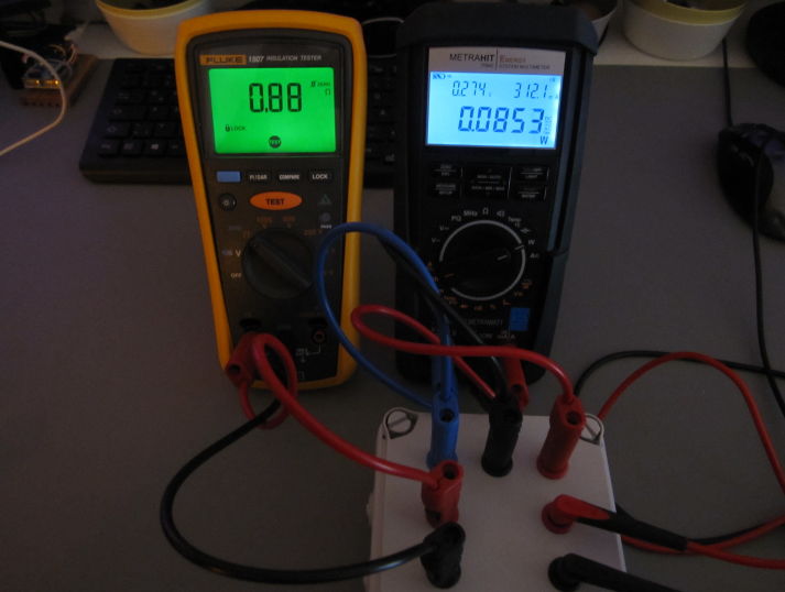

A cheaper possibility to be on the safe side, is to use an Insulation Tester. However, this testgear measures with +300mA (here: 312,1mA) in the low Ohm setting, so that I don't know, if this is still OK, when it comes to a problem or an accident with your audio equipment:
My piece of copper is so thick, that is has a good connection inside the plug and does not play any role as I wiggled around to get a good connection point. Compared to the 315mOhm from above 320mOhm is a good hint, that the values are at least plausible and therefore right:
...and just as a comparison, that it is always better to build your own power cables with 1.5mm² thickness: This testing cable is 6m long, has a switch, a power outlet, 1m long testleads and several wago inside, together with the usual spring connection points and has only 74mOhm:
Cheers!  ;)
So it is 0.75mm² or not ? Measuring resistance of the cable and calculating resistivity of copper, but what if it is aluminium or iron or other cheaper metal, but still 0.75mm² ?

As long as the measured values are within its limit, it is fine, which is obviously not the case in my example. Some pat tester such as my already sold "Benning ST 725", gives you even a hint, when you measure PE resistance of a cable (it is the same cable from my desoldering station, as I keep it as a bad example) and you are over 300mOhm (here: 320mOhm, by the way it is the same value as shown by the Fluke 1507): in this case "table" means, that there is something totally wrong...
...and you should check the list of values, as there are no exceptions allowed, when you want to be on the safe side, because 300mOhm is the limit and worst scenario, which means, that you always and forever have to be way under this value and should not pass 150mOhm in the extreme case:
When length and thickness would also give a good value and they are within its limit, the producer will obviously choose the cheapest possible material.
However, as far as my measurements are concerned, most chinese producer even don't pay attention to safety issues and when your house burns down due to overheating, it is your problem, as long as you or your family will survive the fire.
My example and measurements do prove, that this becomes totally normal, so that it is up to you, to check any cable and/or testgear before using it - the safeyt stickers are useless and that is why I wrote in my first post, that anybody should have or at least use a pat tester!
This cable, for instance, was from my first 15 Inch Eizo Monitor and I have never ever seen such a good value of 50mOhm anymore, which underlines my observation...
Cheers!  ;)
