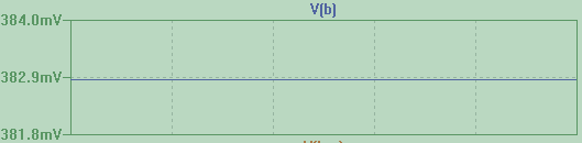

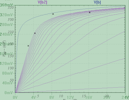

This is LTSpice's simulation.
https://i.postimg.cc/Yqsn1PDV/screenshot.png
https://i.postimg.cc/T1SVWz2J/screenshot-2.png
(the reason for the tran plot is that I also simulated the effects of capacitive coupling with the mains line, to explain the negative measure obtained by userxxxx in this post on SE:  https://electronics.stackexchange.com/questions/655771/what-will-happen-if-we-give-voltage-to-a-transistor-bjt-across-emitter-and-col)
I am usually diffident of simulations with floating terminals, but in this case it appears Mike Engelhart (always be praised) got it right. (Microcap provides a similar result, even if with a smaller VBE). I am not sure what you are referring to when you say that the voltage across the base and emitter terminals should be zero. This is not what theory predicts. At room temperature it should be some 230-250 mV and thermodynamics will be very happy with that. Loosely speaking, the voltage comes from ICEO.
(As I wrote in my comment on SE, you can imagine two diodes back to back: the lower diode will be biased by the leakage current and will show a voltage across it; the transistor is more complicated because of the shared base but the need for a voltage there is clear).
EDIT: oh well, and now I do not see the images even on my smartphone. Ah, the evolution of the web: taking it all away one piece at the time... I added the direct links.
As you should be if you expect your simulation to reflect any actual reality.  I tried your circuit with two high-impedance meters, on selectable for 10M or >10G, the other >1G.  I used a 1N3904 since I didn't have 2N2222 handy.  The result was that the >1G meter showed a very small voltage, a few millivolts (often negative) and a bit of noise.  Interestingly it behaved differently if I measured the 8V first and then the base--it then would measure -1.6V.  The other meter in 10M mode showed nothing but some noise but in the >10G mode, it showed varying voltages of 10s and 100s of millivolts, almost always negative.  So clearly all of these are dominated by the meter characteristics and external noise that is being rectified.  Your circuit is essentially an untuned receiver and I think you'll have a pretty hard time finding a place where the external noise is low enough to see the effects you expect.  You might add to your simulation by putting very high value resistors across the base and emitter to account for the voltmeter so you can tell us what currents are expected in each situation.  The meters will have input currents in the single-digit nA or less by spec, most likely a lot less in reality.

The emitter and collector current in the simulation is 1.4 nA and yes, if I simulate with a shunt resistor the voltage drops to a few millivolts with a 10 meg resistor and even with a 3 Gohm resistor. I had it simulated before my first measurement in the cold of the night and I went out there just to prove I would only read a few millivolts (and not the minus 0.6 V of userxxxx on SE). And I was surprised to read hundreds of millivolts, in the ballpark of the simulation with an open base.
I also ran a simulation stepping Rshunt and only when it reaches several teraohms the simulation gives a VBE of hundred of millivolts. This is a voltage that should require an electrometer, and that is why I was surprised of being able to read it with bottom of the barrel instrumentation (the UT139C is a 50 bucks DMM!)
I am still left with the doubt I cooked the transistor because - ahem - before connecting 8.2 V between collector and emitter I placed 8.2 V between emitter and collector and the little guy got lukewarm.
In a few hours I will go out and risk my life in the abysmally low temperature of + 10 °C and try to measure a couple of untouched transistors.

I read about 240 mV at 19.5 °C. (which I was not able to read last time - mind you this is the opposite side of the table)
LTSpice says 328 mV, while Microcap says 215 mV (yes, I know there are variation just like in beta - I use simulations to get an idea of what I should see in the real world - few millivolts, tens of millivolts, hundreds of millivolts...).
Now I'm wondering: is this another coincidence, the third one?

In your simulations with the 10M and 3G resistors in place, what is the leakage current then?  Still 1.4nA or does removing that tiny bit of current from the base reduce it?
Without base resistor, 1.359 nA for IE and IC, with IB = 0A
And VBE = 383 mV at 0°C
With 10 meg base resistor to gnd
IB = -7.9998 pA        it's getting out of the base, into the resistor
IC = 8.0024 pA         but the current in the RC resistor, which shoud be equal is 7.9936 pA
IE = 0.1974 fA
With these values VBE is 79 uV. Microvolts!
It's basically skipping the BE diode. And there are numerical errors here and there.
(with 3 gigaohm VBE becomes 24 mV)
With 70 gigaohm resistor to gnd
IB = -5.072 pA        out of the base, into the resistor
IC = 422.196 pA
IE = 417.119 pA
With these values VBE is 355 mV, almost there to the open base value.
« Last Edit: March 09, 2023, 02:01:16 am by Sredni »

Thanks for the heads up, but I don't think the meter is the problem here. The (absence of a proper) measurement procedure most surely is. I don't think the meter is giving erroneous values on its own. I measured 0.7 mV both on the UT61E and the UT139C and they both agreed.
Right now I am mostly curious about how on earth I was able to get those two series of fast, clean and repeatable measures the first and second night. It is clear that the meter needs some 10 minutes to stabilize the reading, but I am absolutely certain the measures I did in 0°C and 4 (or was it 7)°C were very fast, but they shouldn't have been.
I tried again, same place, same time of the night (but different day and temperature, but most importantly different probes) and I get the same slow rising to the equilibrium value I get inside the house. I wonder if the relative humidity is playing a dominant role in this. Since the measurements are so dependent on small amounts of charges on the base, an environment that does not allow for charge to accumulate or deposit (if not driven) might explain what I saw, but ...
To add to the list of coincidences, here is a plot showing how - in numberland - the simulated BJT VBE with an open base changes with VCE, while stepping the shunt resistor from 1gigaohm to 71gigaohm in 5gigaohm steps. The first curve on the left is the simulation for actually open base at 18°C.
https://i.postimg.cc/jS5kcmz6/screenshot-10.png
The dots are the measurements I took with 2.9V(*), 4.36V, 8.3V, 16.3V at 19.5°C. Of course there are errors associated with each measure and the actual VBE, like beta, would be different in simulation and actual transistor but... I am getting a trend with VCE that mimicks what should be expected.
(It's true that all exponentials look alike and this might be a different exponential process, but... another coincidence?)
(*) the 2.9 VCE measurement was not exactly reproducible. I was able to get this trend starting from 0 and then going up in voltage, but when I got back (by switching batteries by hand, therefore messing with charges in the worst possible ways) reducing the voltage, the higher voltages were close to the ones shown, but the 2.9V VBE was much higher than that shown.
I plan to redo this measurement with appropriate shielding, clean probes, shorting all terminals before each measurement and in an electrically quiet environment to see if I can get a reproducible curve that fits the expectations. I would appreciate if someone in this forum, with better instruments and setups could try to see if this is a feasible measurement or not.
