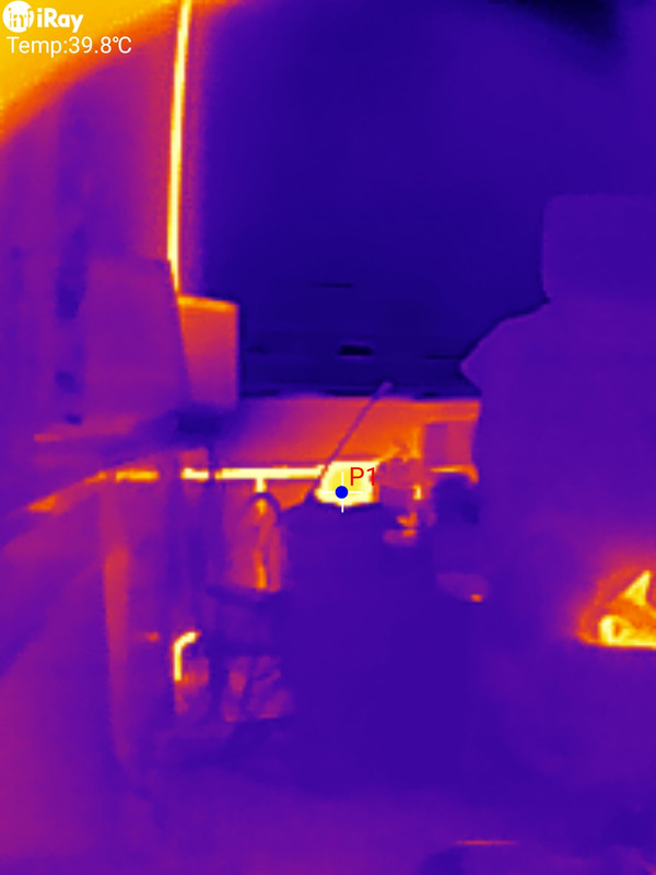

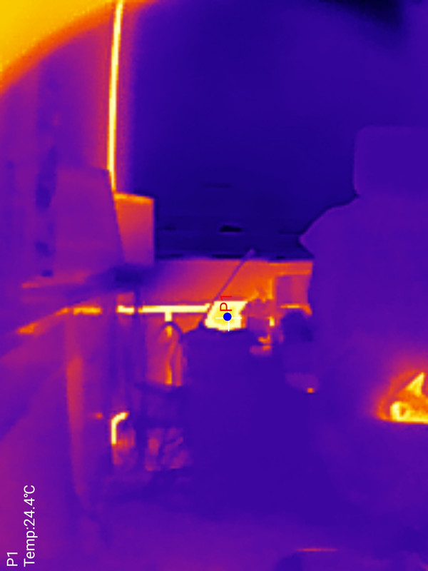

P2Pro app on Android v1.1.3.240316 as all others since release have this bug where if you place marker to show temperature then open the same image with P2Pro app edit mode, the temperature for new placed marker will be 2x lower
Original 40C
Opened for editing 24C
Furthermore how come clicking edit in the P2Pro app deletes all markers, and shows image without any. is this bad joke. Infiray does not fix there reported multiple times problems, or is it just me?
yes that is true, but I think the real errors are not as easy as a factor of 2. It is a complete mess. I made a small web app to analyze the images of the P2pro without such errors by reading the raw temperature data from the jpeg files. You may try it out here:
https://p2proviewer.streamlit.app/
https://github.com/ks00x/p2proviewer

Wow this is well known problem, if you made an app to fix this somewhat. Yes the temperature error is non linear, usually around x2. If you contacted Xinfiray what did they reply to you? Why they do not fix this?
Clicking edit in the P2Pro app deletes all markers, and shows image without any. is this bad joke. Infiray does not fix there reported multiple times problems. I used CAT S62 Pro the FLIR app is way way better, but framerate is a joke, unusable for electronics repair, not to mention non existing close-up.
