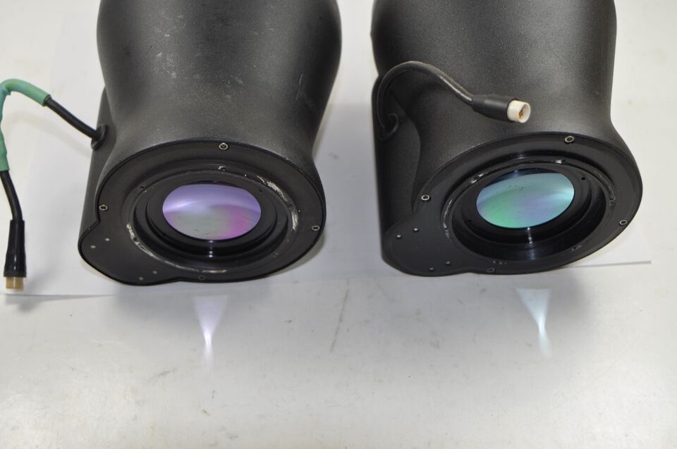

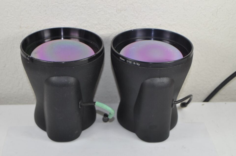

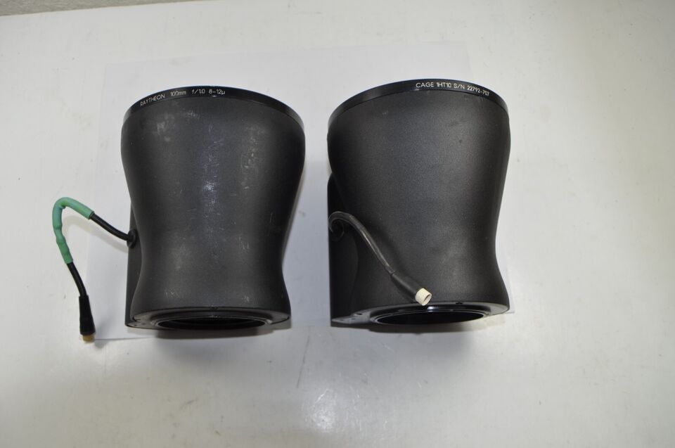

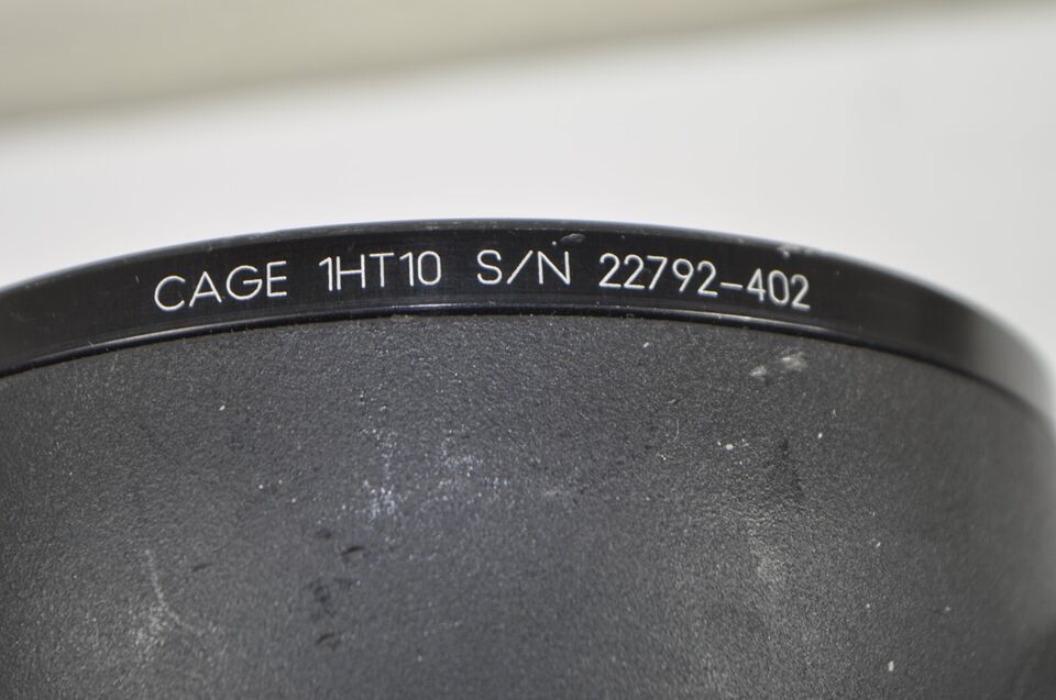

I have acquired, for cheap via eBay, this pair of identical LWIR lenses that appears to have been OEMed by General Dynamics Global Imaging (CAGE code 1HT10) for Raytheon:
Does anyone recognize these? We are looking for specs (e.g. BWD) and info on how to control focus and zoom.
All clues and guesses welcome! Thanks!

These are for Raytheon palmir 250d or their module cameras like 300a, but bayonet mounts are missing. No zoom control of cause, focus is controlled via buttons on body of 250d) I saw hunters drill hole in a protruding rear bump and make mechanical knob for focusing. bwd is sufficient, 10-15mm)

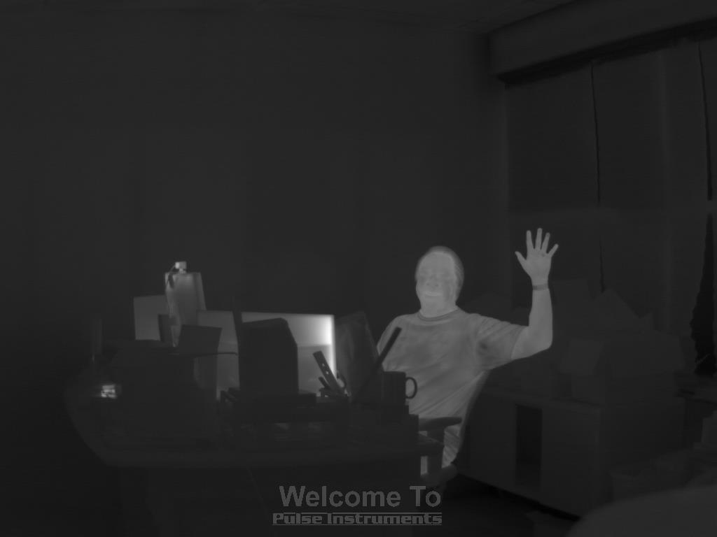

Thanks! Here's the lens, precariously balanced on my optical setup, just in front of the FPA:
It's not quite centered, nor quite coplanar, but I can sort of get it almost focused by hand. Here I am, sitting about 12' away from the test rig, through my 25mm Strix lens:

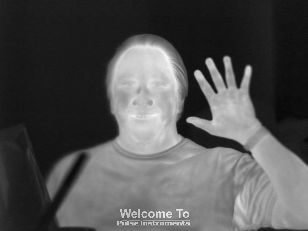

and here I am through the Raytheon 100mm lens:
It's interesting that this lens is so big, when the FPAs in the PalmIR were 320 x 240. Were they giant pixels?
This 1024 x 768 is 17 µm.
The following users thanked this post: Fraser

And here's that 100mm lens, as viewed through a 25mm lens!

And since I have two of these 100mm lenses, here's one lens as seen through the other:
You can see my eye, blinking!

Does anyone have a drawing or model of this lens? Or even know the model number so I can search?
I'd love to mount this on my rig and get it properly aligned and focused.
