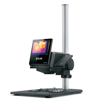

This slipped through under the radar! Looks to be quite useful if you don't already have an E4 hacked to E8
FLIR ETS320

It is about time that we saw a thermal microscope ! They have been used in industry for many years. Maybe a bit specialist though ? As a dedicated tool it will not gave the wide appeal of a handheld thermal camera so is likely aimed at the production and research markets ?
Watching ants and insects through a thermal microscope can be fascinating. You can see their tiny muscles creating heat as they work. Bee's warming up their wing muscles are a great subject for such a microscope as well.
Fraser
Offline Fraser
  • Posts: 14434
Re: New Flir products
« Reply #589 on: April 24, 2017, 10:57:10 am »
I just took a look at the specs......  what a disappointment !
45 Degree FOV with fixed focus of 70mm +-10mm !
Sadly this is not a thermal microscope as I mistakenly thought. Just a close up camera with fixed 70mm operating distance. Unimpressed.......it could easily have been made so much more versatile. At the very least it could have been offered with interchangeable lenses and a true microscope X15 lens for really small regions of interest.
As Chanc3 stated, an E4 can likely achieve the same with a ZnSe close up lense attached. With those you have a choice of 25mm, 50mm, 63mm and 100mm FL. Very shallow DOF though. Alternatively, adjustment of the E4 lens focus enables pretty good close up capabilities.

ETS320 is priced at approx $2500
https://www.testequity.com/products/33467/
