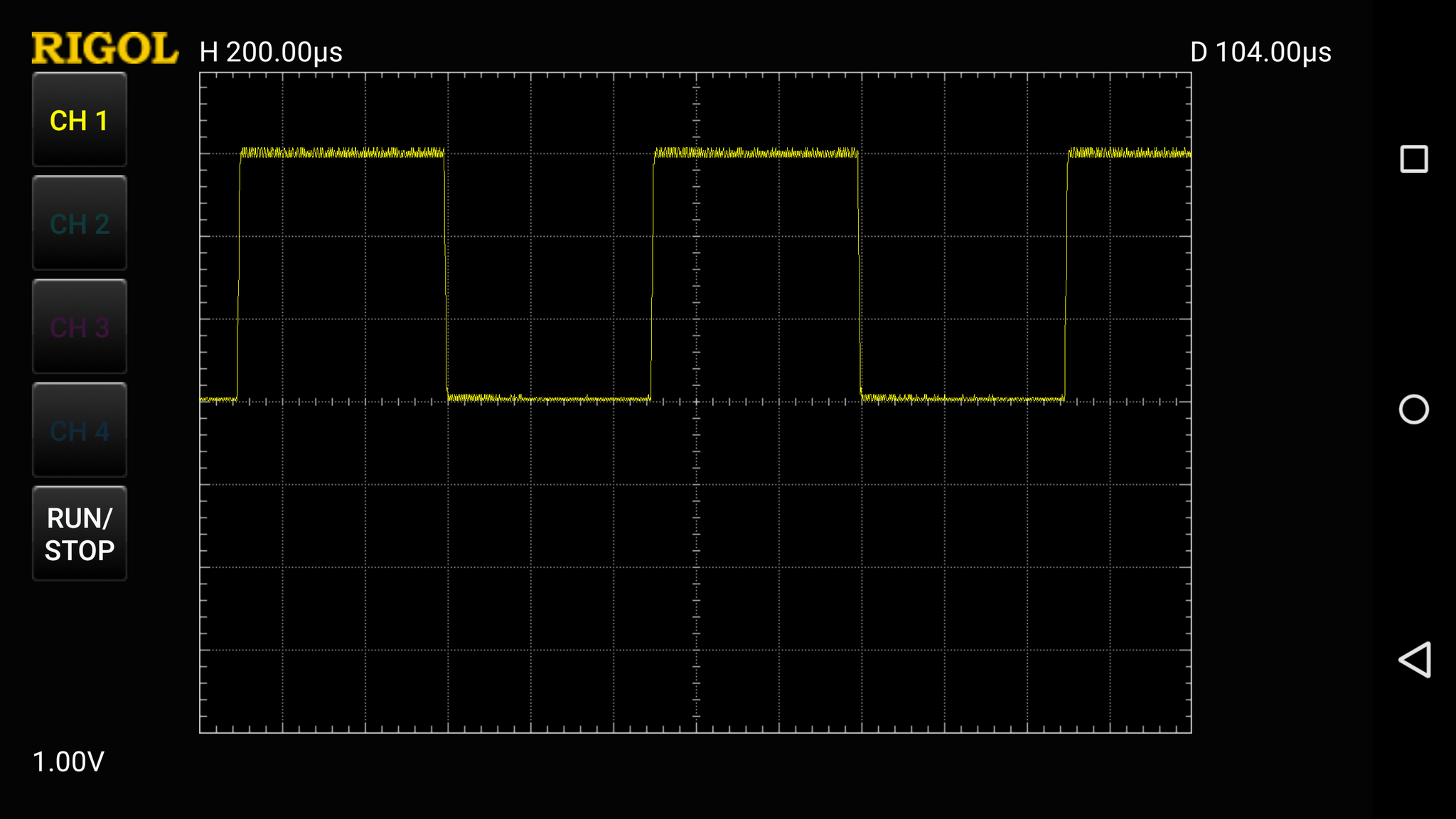

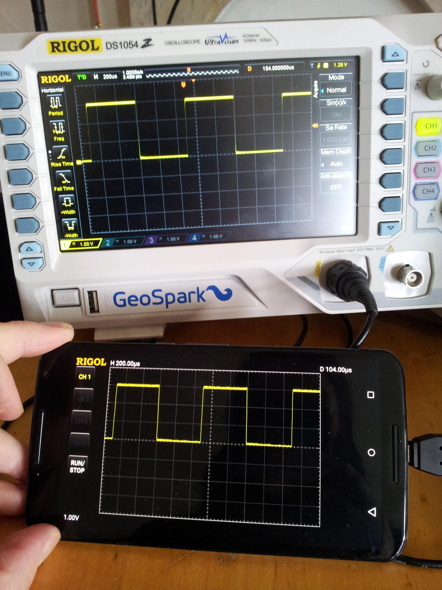

I took delivery of my shiny new Rigol DS1054Z the other day, and being a programmer first, ee second, I decided to see if I could get some data out of the 'scope and on to my Android phone. My main motivation was curiosity, but I justified it to myself by thinking that if the DUT is in an awkward place relative to the 'scope, and moving your body to better see the 'scope could move the probes, a remote display would be useful.
So, I tinkered around at the weekend and came up with Scoperoid! The code is open source and can be found here: https://github.com/MerseyViking/scoperoid
And this is it in action:
And a screenshot:
It pulls the data off via USB, but I am considering playing around with the Ethernet port so I can use WiFi. Check out the readme on the github page for some more information.
So would people find this sort of thing useful? I don't plan on it competing with marmad's excellent UltraVision Utilities (unless someone pays me of course  ;) ), it's just a bit of fun at the moment, and not ready for prime-time.
