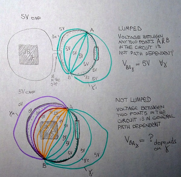

Voltages ARE path-dependent. What you fail to see is that in order to see the path dependency you have to enclose a variable flux region between the paths. In the case of Lewin's ring
https://i.postimg.cc/VvFWycbH/Voltage-can-be-path-dependent.jpg
you are just considering two green paths which give equal voltages and come to the conclusion that all paths always give equal voltages.
When you cannot physically put your wires inside the dB/dt region, you are left with two possible sets of paths (the green and purple ones) that give two possible and different values.
Here, a few more pictures:
https://electronics.stackexchange.com/questions/551244/what-would-a-voltmeter-measure-if-you-had-an-electromotive-force-generated-by-a
« Last Edit: January 03, 2022, 01:13:24 am by Sredni »
Yes, the voltage generated in the voltmeter test leads depends on the path--i.e. where you put them.  >:D
The following users thanked this post: jesuscf
Offline Sredni
  • Posts: 746
  • Country: aq
Re: #562 – Electroboom!
« Reply #789 on: January 03, 2022, 02:38:45 am »
Well, I would have drawn that purple, to match the picture below but... what do you think you have accomplished pointing that out?
The circuit below already showed path dependent voltages. That you have drawn is  a 0V path - it is measuring the voltage along the transformer coil. I simply reused a previously linked figure but if you wish you can draw ten more 0V path. What's your point? As I wrote above, in order to see path dependency you need to enclose the dB/dt region inside your paths.
So you are saying - to measure voltage for given path, one shall route voltmeter leads along that path? In case I have only one voltmeter, I need to place voltmeter and it's leads on right side of Lewin's experiment to measure voltage on right side resistor, as soon as I move voltmeter and leads to left side - I suddenly measure voltage on left side resistor? This is not because of electromagnetic induction but "path dependency"?
I wonder - how one can practically demonstrate path-dependency using transformer with let's say, 100 turns of secondary? He shall wind 100 turns of voltmeter leads on transformer core or what? Would be good to get description of experiment so those who are interested, can repeat. Thank you.
Offline jesuscf
  • Posts: 503
« Reply #794 on: January 03, 2022, 06:04:40 pm »
You make a very good point here.  Sredni's "path dependency" is less and less noticeable the more turns on the secondary.  I did the experiment with a three turn secondary and posted the results in this forum.  Sredni almost calculated the voltage between nodes A and D, VAD but suddenly realized that if he did the calculation he would show that KVL works perfectly, and backed up quickly...  Cyriel Mabilde in Youtube did a similar experiment too with a five turn secondary and also demonstrated that KVL works perfectly.  Now I am waiting for some insight from Sredni of what would happen if we replace the resistors in the loop with capacitors, but he is MIA...
You clearly have a very fuzzy recollection of those events.
I computed all the values in your silly circuits in less than 15 minutes and got the results right. Including the voltage along a diameter in the case of perfectly circular and concentric geometry.
You still cannot understand that voltage IS path dependent.
Mabilde, from the depth of his garage, is another KVLer who cannot imagine a path dependent quantity. And this is an old movie that is being rerun over and over. The KVLers propose their 'killing' experiments that should make us "Armchair Nobel prize physicists" fly away to another galaxy. Then we post the solutions according to classical ED (it's not 'our' theory, it's plain old classical electrodynamics) and you fade to silence for a while, except coming back with muddy recollections of events.
It happened with the 'two secondaries is series', it happened with the straight partial coil, it happened with the multiturn coil, it happened with that sentence by Belcher (Jesse is still touting it in his boilerplate answer on his channel and he is forced to ban users who do not agree with him to make them 'fly away to another galaxy')...
...and now we are at the ring with two capacitors. As if these capacitors could change something.
So, here, are the results for the following values of capacitors
    C1 = 4.7 uF , C2 = 22 uF
    freq = 50 Hz
    emf = 374 mV
I get - from simulation and without even invoking MEAS, just by eyeballing the plots
    VcapL = 308.5 mV,           VcapH = 65.5 mV
Guess what I measure with a true RMS multimeter?
    VcapL = 308 mV,            VcapH = 66 mV
And nothing, ok almost nothing, in the copper joining the caps.
So, what are the revolutionary results that you said were bad news for 'team Lewin'?
I am saying that when I measure a voltage I want to make sure there is not a variable magnetic flux region inside my measurement loop.
When I measure from the outside of the ring, since the dB/dt is well inside the ring, there is no dB/dt region inside my measurement loop, so if we look at it in 2D in the area enclosed by the loop voltage is not path-dependent and the value along the branch I test is ALSO the value across the branch I test which is ALSO the value across the probes and voltmeter, which is ALSO the value shown by the voltmeter.
I wonder - how dB/dt discerns between wires of resistor and voltmeter leads? You think that EM induction miraculously stops at first wire it encounters, acts only on circuit but not on voltmeter leads? Then please explain how multi-turn transformers work? Also you did not answer my 2nd question: how one can practically demonstrate path-dependency using transformer with let's say, 100 turns of secondary.
I wonder - how dB/dt discerns between wires of resistor and voltmeter leads? You think that EMF miraculously stops at first wire it encounters, acts only on circuit but not on voltmeter leads? Then please explain how multi-turn transformers work?
It doesn't.
Maybe one day you will learn about current dividers.
Try to compute the current that will flow in your 100meg (or even 10meg) internal voltmeter resistance when you shunt your voltmeter with the branch you are measuring (900 ohm or 100 ohm in the case of Lewin's ring).
The measurement loop that does not include the dB/dt region will give you the correct voltage (EDIT: with a nanovolt order-of-magnitude load effect).
The measurement loop that include the dB/dt region will give you a measurement that is the voltage of the distance branch plus (or minus, depending on orientation) the linked EMF.
Another killer question, I suppose.
I did it for a generic autotransformer. You probably have to look in the last 30 or so pages to find it.
When you measure from the outside you can look at the measure in two ways:
the voltmeter shows the actual voltage in the gap between taps
the voltmeter shows the voltage along the portion of filament between the taps (which is the ohmic drop that is nearly zero volts) plus (or minus depedending on orientation) the linked emf (emf of one turn times integer number of turns linked).
« Last Edit: January 04, 2022, 05:27:38 pm by Sredni »

The voltage the voltmeter shows depends on the induced emf in the probes of the multimeter.  Is that what you call path dependent?   The voltage at the tips of the voltmeter probes, the ones connected to nodes A and D, VAD, is not path dependent because the ring circuit is neither changing nor moving!  You don't seem to understand that Vvoltmeter_screen != VAD. Unless you get rid of the induced voltage in the voltmeter probes or account for it somehow (using KVL of course) you'll get the wrong value for VAD.  Nevertheless, that should not prevent you for calculating the voltage VAD correctly
All of these are trivial experiments, that show that KVL works perfectly.  Also, what is wrong about doing experiments in your garage?  Both Mabilde, I, and probably you too, have equipment at home to do this experiments that is several orders of magnitude better than all the equipment the big wigs of physics had in the 19th century when doing similar tests.
    freq = 50 Hz
    emf = 374 mV
Everything is bad news for team Lewin, because team Lewin is convinced that the induced voltage in an arbitrary length of wire is zero.  Can you show us your calculations or are you using a circuit simulator?  Did you measure VAD?  Any pictures of your setup?
Do you think there is an induced voltage in the capacitors via Faraday's law?
