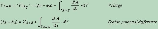

On voltage and scalar potential difference
This is the definition of voltage as work done per unit charge to move from point A to point B along a given path \gamma. It is also the convention adopted by the IEC and it requires one to compute the path integral of the TOTAL electric field along the path \gamma from start point A to endpoint B (fun fact: the reason for the inversion of B and A in VA->B = VBAgamma is that when the electric fields admits a potential function we have E = - grad phi and the two minus signs cancel themselves, the rest is basic integral calculus)
Since the TOTAL electric field is in general non conservative, the path integral will in general depend on the particular path joining A and B. Therefore there is not a potential function V(P) such that the path integral can be expressed as the difference between the values assumed by V in the endpoint and startpoint (which, considering the minus sign would have given an expression of the form V(B) - V(A) = VBA ) .
In this context I am using the notation "VABgamma" enclosed in quotes with the addition of a reference to the path \gamma to remind us what that voltage would be called IF we could treat it as a potential difference.
By the sheer power of superposition, we can mathematically decompose the total electric field Etot into its two components Ecoul and Eind.
Etot = Ecoul + Eind
The first is the conservative (or irrotational, or laminar) part that is due to the coloumbic force, while the latter is the nonconservative (or rotational, or solenoidal) induced electric field associated with the changing magnetic flux. Since integrals are linear operators, we can split the path integral that expresses voltage in two contributes
Now, the conservative part of the electric field Ecoul admits a potential function that we call the electric scalar potential phi (I am using this notation on purpose to make it clear it is not the non-existent potential function for the total electric field Etot), so we can express that component of voltage as a scalar potential difference phi(B) - phi](A) = phiB - phiA = phiBA
Here I made the signs explicit, so that it is clear that the actual path-dependent voltage V - the one Ohm's law works with - is the sum of two components: the path-independent difference in electric scalar potential phiBA and the contribute of the inducted electric field (that can be expressed as a function of the magnetic vector potential A).
The partial component phiBA is the voltage that KVLers believe is the real and true voltage, and if we express it in this way
it is clear that we are subtracting a partial component from the actual 'full' voltage. VA->B = VBAgamma is the voltage that gives the full picture as it is expression of the one and only total electric field Etot that electrons and other charges can sense. While phiBA = phi(B) - phi](A) is just a partial component that gives you only half of the story.
As a side note, if we wish to make use of the magnetic vector potential A, the formulae become:
and (spoiler alert!)  this is the key to understand where that 'tiny batteries' model comes from.
Yeah, yeah, it's voltage sources since they are generally time-varying, but if we fix a particular instant in time we can represent them with battery symbols, they make it easier to see the polarities without cluttering the drawings.

KVLers, on the other hand, believe that the scalar potential difference phiBA is the only one and true voltage between points A and B, and that if you obtain a different value then it must mean you are committing a probing error. No, probing has nothing to do with the fact that the scalar potential difference alone only gives a partial description of your physical system when variable magnetic fields are present. This partial description is also what is represented by the 'tiny batteries' model of inductive components. This model and why it represents only half of the story, is the subject of another post, but a sneak preview is contained in this picture:

Of course. The MIT is notoriously known for its scarcely prepared professors of physics and engineering.
Here is yet another professor who does not understand the basics of electromagnetism!
Shame on you, MIT!!!
Listen to the guys in a garage, instead. They have an oscilloscope, so they clearly know what they are talking about.
When measuring, the voltage the instrument displays depends on the path of the instrument wires, but that is not the voltage VAD, it is the voltage at the instrument!  With that understanding it is a trivial task to find the correct and unique voltage between nodes VAD which is independent of the path of the instrument wires.  So, how do you find the correct voltage between nodes 'A' and 'D', VAD?  Using KVL of course!
I would love to see you get the voltage on the conductors that join the resistors in this square ring, asymmetrically placed inside a square toroidal core, by simply using KVL.
Keep in mind that the induced field Eind is no longer directed along concentric circles, and your ring is now square.
Good luck using KVL.
