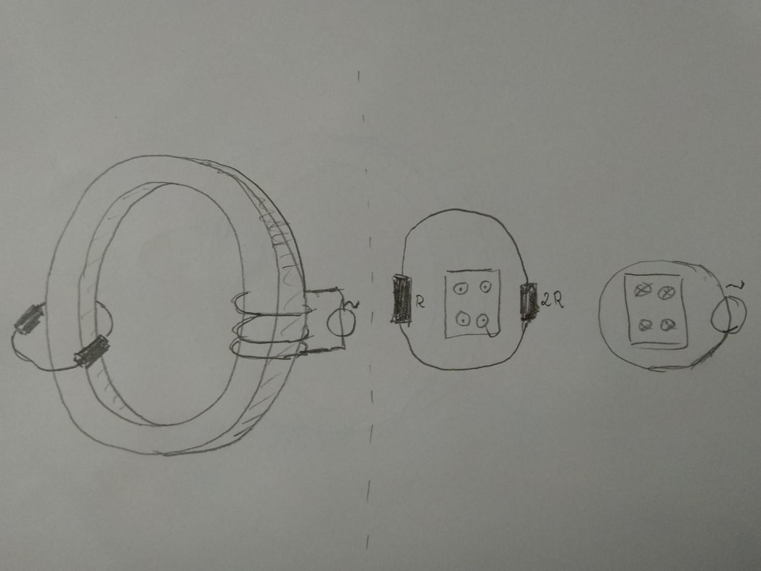

This is what I came up with when thinking about this circuit and when KVL holds and doesn't hold.
In figure a) the circuit is inside a magnetic field, the voltage between points A and D depends on path, it is not possible to create a lumped model for the source creating the 1mA current, and KVL doesn't hold.
In figure b) the circuit is only partially inside a magnetic field creating a transformer with a single-turn secondary, thus it is possible to create a lumped model for the source creating the 1mA current like in figure c, and KVL holds.
Figure c is a lumped model for figure b with a (voltage) source creating the 1mA current when the magnetic field is increasing, and KVL holds.
Is my reasoning correct?
Edit: Added some clarifications.
Absolutely correct.
Yes. There is only one fine point that require some annotations.
Technically the lumped circuit model requires for the circuit to be shrunk (or to be 'shrinkable') to a point. It's a way to make sure that the circuit path itself does not participate in any phenomena that is related to geometry. The variable flux 'exploited' by magnetic components requires a finite area - you cannot shrink your circuit to a point if it has to contain a finite area; likewise, charge separation and accumulation that is exploited by electrostatic devices requires... space. So, if your circuit path can be thought as an elastic band that can be shrunk to a point, you are guaranteed you exclude these effects from the 'inside' of your circuit - they can only be 'provided' by the components.
This is why when dealing with lumped circuits, the lumped components are sometimes shown to offer their terminals close together. All the pairs of points on the circuit path corresponding to every lumped component do not interfere with the shrinking of the circuit path. In reality, if you have a component that doesn't offer terminals side by side you can choose: extend the component's terminals or extend the circuit as I have shown in a post a few pages prior. This leaves some leverage to argue about the lumpiness of either the component or the circuit. Considering components with terminals separated by a very small gap avoids this controversy entirely.
Then, of course the symbol of a battery for the lumped component signifies that you are considering a specific instant in time (the linearly increasing flux is a didactic tool). I too, prefer to use battery to represent the contribute of the inductive EMF, but sometimes it is better to remind it.

Question: In the following diagram, in a real life physical lab test performed with real (time synchronized) volt meters with a real transformer and real resistors CONNECTED AS SHOWN, will the readings of all the volt meters sum to zero, within the accuracy and resolution limitations of the volt meters? YES or NO.
(Or if you believe SOMETIMES is the answer, then explain one scenario for a YES condition and one scenario for a NO condition WITH THE VOLT METERS CONNECTED AS SHOWN - Running additional conductors through the transformer core is not allowed - nor is removing existing conductors from through the transformer core!)
You do realize that this is not a circuit that is equivalent to the "Lewin Ring", or equivalent to the circuit I gave you to solve, right?
Of course! "That" is a simple circuit that can be easily constructed and measured by anybody.
I was hoping we could find some common ground there and at least agree that KVL appears -- and perhaps does - hold on the above topology.
But like all the others, you are afraid to answer either because you don't have what it takes to test reality, or you know that your answer will undermine your belief.
That was my challenge to you, the task was to find the voltages across the resistors and the wires:
And that's what you came up with:
Which of course brings up the question why you found it necessary to add a "transformer secondary" to find the voltage across "2R".
You call it an "added secondary" but it MEASURES AND MODELS the exact same as if the right hand volt meter was instead on the left. Doesn't matter where it is. It doesn't loop through the core, which means it's not another winding.
Remember, KVL requires two-terminal elements. If we're not using a two-terminal element, OF COURSE kvl isn't even applicable.
You want me to run a volt meter lead through the core which effectively adds another secondary winding, making it into a 3 terminal element, and as such, it's no longer applicable for KVL.
By having only ONE PATH through the core, we effectively have what MODELS AND MEASURES as a black box 2 terminal element, which is what KVL requires - and we can unambiguously measure the voltage across THOSE TWO TERMINALS and KVL holds.
Remember, a toroidal transformer MODELS AND MEASURES as if the entire induced voltage takes place at the plane through the center of the core.
How and where it is actually induced is irrelevant to KVL so long as an unambiguous voltage measurement can be physically obtained. By modeling the core as being a mythical fluxgate or stargate or whatever you guys called it, then we get a physical unambiguous voltage measurement and KVL holds.
So how about it? A yes or no on the top picture question in this comment?
Dude, you know the answer is yes, KVL will measure to hold. We should be past this. This is an easy one!
Talking about the open ended air core transformer and it's half turns would be much more interesting!

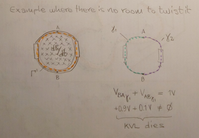

As I repeated about a dozen times, if a circuit is lumpABLE and you choose the circuit path in such a way that it does not include a variable magnetic field, then you can consider all voltages between any two points on that circuit path as if they were path independent. The circuit can be considered lumpED and KVL works.
IF the circuit is lumpABLE.
There are in our universe, circuits that are not lumpable: I call them UNlumpable circuits.
They are circuits where you cannot find a circuit path that does not encloses the variable flux region.
Lewin's ring IS such a circuit because it REQUIRES the two resistors to be on the opposite sides of a variable magnetic flux region.
You think Lewin's ring is lumpABLE?
Well, PROVE IT.
This is Lewin's ring: two resistors in a single loop that goes around a circular region (let's consider it of the same size as the loop, so you can see there is no 'room to twist' the wires) of variable magnetic field. The resistors are required to be on the opposite sides of the variable magnetic field region.
link https://i.postimg.cc/pLmfyHxZ/Lewin-ring-is-unlumpable.jpg
Please, show everybody you can draw a circuit path (make it green, meaning it's 'flux-free') that joins the resistors' terminal to the "lumped transformer secondary" terminals and DOES NOT INCLUDE the variable magnetic field region in its interior. Like I did for the lumpABLE circuit I decided to see as lumpED (in my post "Lumpable (lumped and not lumped) and not lumpable circuits for dummies").
In addition, you can also show everybody you can draw the path inside your "lumped transformer secondary" that DOES INCLUDE the variable magnetic field region (make it orange) but IS NOT part of the green circuit path.
I will show you that if you can do that you will run into contradiction.
