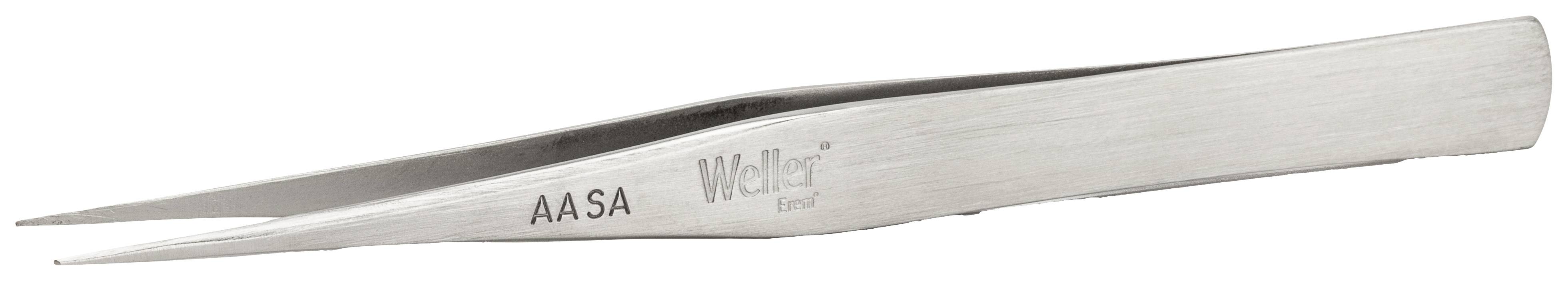

At work I tend to use mostly Erem tweezers, often rebranded as weller tweezers. Really happy with them.
Erem tweezers, like these:
Are they good to bend wires of through hole components?
Weller owns Erem now, so they’re all being branded as “Weller Erem”. I concur that they’re the best I’ve ever used.

Thanks for the links! Do you actually use them to bend parts' legs? Like 1/4 W resistors legs? or BJT in TO92?
No, using any of the high quality tweezers above for bending through-hole component leads will immediately twist the tips and ruin them.
Fine nosed electronics pliers are the tool for that job.
