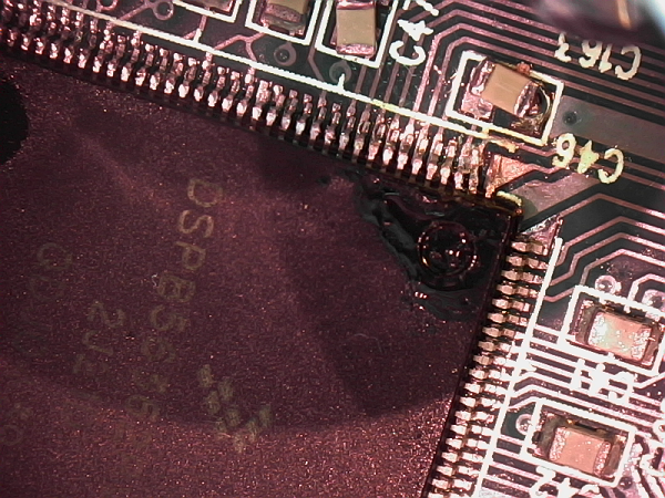

I had my first stab at soldering a 140 pin quad flat pack 0.5mm pin spacing chip. I put on too much solder and had to remove most of it with solder wick. I was at it for quite a while and somewhere in the process I bent one pin - probably the wick was still attached when I removed it. I've tried to work carefully but I just couldn't see enough. So I am now shopping for some magnification (100,= euro budget tips?).
My attempts to straighten the pin back have failed. I have tried to use the top of my fine tweezers to wedge between the bent pin and its neighbor but I could not get the solder iron in to melt the solder and I did not want to force it...

I have tried to take a picture but it's just too small for my camera to pick up in any detail.
Pin pitch is 0,5mm.
The pin is bent such that it now contacts the neighbor's pad.
I will try the blade tip after I get some magnification...
This is how it looked. (I got an USB Microscope that could take pictures like this.)

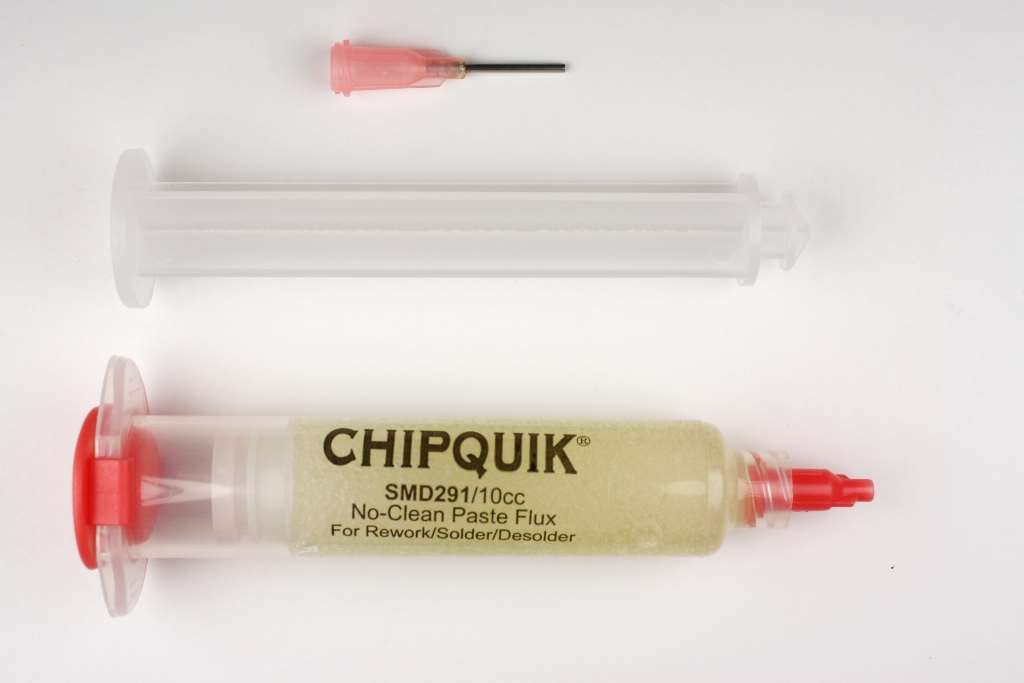

When hand soldering packages like this one, flux is your friend, especially that tacky kind (I am using ChipQuik). It is also useful to remove bridges and extra solder. You apply the flux liberally and drag a clean solder iron tip along the pads.
A thousand times this. You just cannot put too much flux. I personally find flux pens pretty useless for soldering chips, you need actual thick "gel" flux. I've been using some "Amtech" flux from eBay that comes from China, I really doubt it is actually "made in USA" but seems to work great...

No, it's just flux, no solder, but in a gel form. Being gel it's stay in place better than the liquid flux.
I am using this one
http://amzn.com/B001KADQZU . Recently I changed the needle to one with smaller ID for more accurate dispensing but the stock needle should be just fine. Drag soldering is done well with 'hoof' shape tips. Some tips are even concave so they can hold more of the extra solder, but again, not required.
