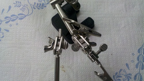

Third hands aren't bad, its like having an army of munchkins holding things.  If you need a vise, get a vise.  I use the 3rd hand to hold wires while soldering, and their metal hands take heat very well; Panavise are far more costly and its all plastic construction is a bit more frail that the steel hands.  The hands also act as heat sinks when soldering items, pulling heat away if you need them.  You can use them to hold items while you blast them to heat shrink tube them and not worry about heat; you can put them inside a DUT, to hold things for you.
If you do get one, spend the extra $1 to get the better made clone with arms that are thumb screwed versus snap on.  There are so many copies, the bad ones are much worse.
Cheap clone on the left, note the alligator is just snap on, versus held with thumb screws on the right.  The hand on the right is 20+ years old, cost about $7, the one on the left is newly made clone, about $3.  Note the diameter of the shaft and thicknesses of the metal, the clone is about 1/3rd thinner.
If you worry about the alligators scratching or biting things, just insert a guard, a penny or washer between teeth to provide a flat surface, or insert a folded U shaped sheet of thin rubber.
