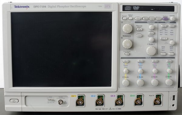

Hi-end scope repair project looking for a new home, as I'm going to optimize my project list and this need some careful repairs. Perhaps somebody need parts for another DPO7104/7254/7354 fix.
Up for sale is 11 year old Tektronix DPO7104 (non-C version) with 2SR option (doubled to 40 GS/s sample rate). It is NOT WORKING, due to ADC chip failure (custom ASIC which is shorted to ground). Same Tektronix ASIC ADC likely used on another Tek DPO scopes, such as MSO/DPO4000/5000 series, but I'm not sure.
There are no mechanical damages, buttons, connectors, chassis are all in good condition.
Internally nice and clean. Heatsink retention clip for northbridge chipset on PC board is separated, as it was loose when scope was delivered. It is bundled together in bag.
Touchscreen display, x86 PC, power supply and interface board all working good. Scope boots native Tektronix Windows XP, loads Tektronix Scope applications with power on diagnostics error.

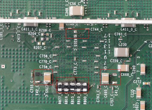

Here's acquisition board and damaged ASIC location. Bottom side has burnt traces and removed power bypass components at affected ASIC. No attempt of any BGA rework was done, board still AS IS, as I have no donor chips or parts to proceed on this.
Diagnostics error:
* Processor - PASS, 0 failures
* Registers - Error 223, 3 failures
* Acquisition - Error 311, 5 failures
* Trigger - Error 411, 6 failures
Since scope use all ADCs at all times in interleaving, none of the channels can perform the waveform capture.
Selling for what I got it for, $2700 USD.
Scope located in USA, payment over PayPal.
Sold AS IS, no returns. No accessory or probes included, only the scope.

Without a working acquisition board it is just an outdated PC in a box with excess knobs. Repairing the acquisition board will be very difficult for various reasons.  I think it will be better to get a donor acquisition board from somewhere but that might give problems with mismatching serial numbers. I'd keep it and hunt for a replacement acquisition board.
BTW: did you remove the capacitors or did you receive it this way?

Sure, but maybe somebody need just that for their DPO project repair project. PSU, interface board, chassis parts are still custom Tektronix stuff, not that commonly available.
Burnt resistors that were there originally near the dead ASIC felt apart during cleaning and troubleshooting. I have no time nor desire to store this unit, waiting for lucky day, and rather give it up to hands of more motivated/equipped hobbyist, at cost.

Looks like a nice Louis Rossman job (with good margin if sold), if someone manages to find another broken one cheaply.  Otherwise expensive paperweight.
It also might help if you remove the heat sink from the broken ASIC, so people can read the number and see wether their broken scope has some similar ASICs

ADC Board DEAD
That can not be fixed ....
Total value practically zero

Well, IMHO, you just made an horrible deal. How are you imagining one of us repairing that front-end? Requires BGA soldering, maybe? And troubleshooting will be a nightmare (I imagine it is not just the ADC, but other more things that need repair/replacement).
If it was working, or needed minor repair, I would say you've had a great deal. But the scope is useless. Sorry! It is what it is.
To add, you'll be lucky if you find a replacement board that works out of the box. And by the way, at a good price.
Kind regards, Samuel Lourenço

Indeed. At least he was honest about the problem. Anyway, "broken" items on eBay are always suspicious. The best way to filter these is to ask the seller for photos of it working or not working. It is a mistake to ask what is broken beforehand. Then you can judge yourself if it is worth buying or not.
But, nevertheless, repairing BGAs is impossible to the average user (speaking by myself). It is not the kind of repair to be done inside a kitchen oven (like those guys that heat Xbox motherboards that way to "fix" them for a time). But I guess that oscilloscope is not for the average user either.
