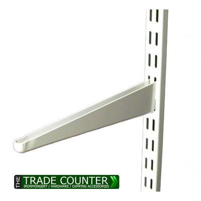

I would rebuild with something like these.
These 8" by 10" brackets will support 320 lbs per pair.  I used the bigger brothers to build my 'L' shaped desk and they support 600 lbs per pair.  They are available at Home Depot.

Yeah when i build shelves i just get metal brackets for the job and put a good strong piece of wood on top.
I use this design a lot. Comes very usefully when you want multiple shelves on one wall since the height can be adjusted on the fly to the requirements. And they come in pretty beefy versions that can carry a lot of load. I mount the rails onto solid brick walls with plenty large screws into inserts and its rock solid.
