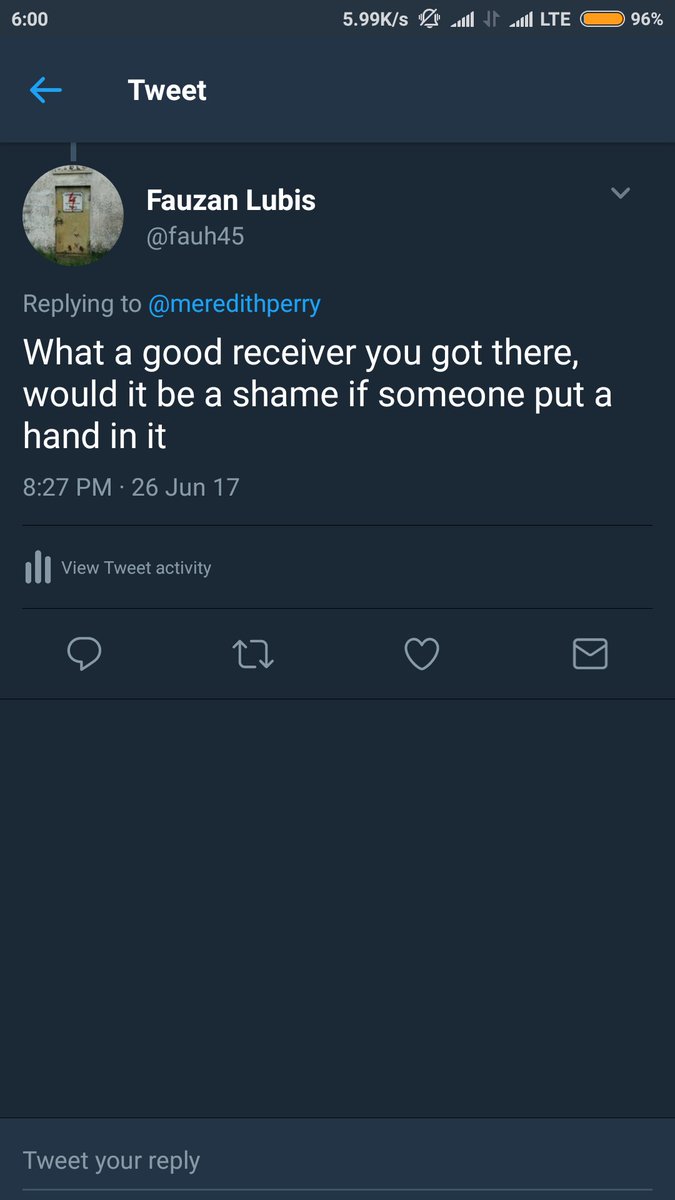

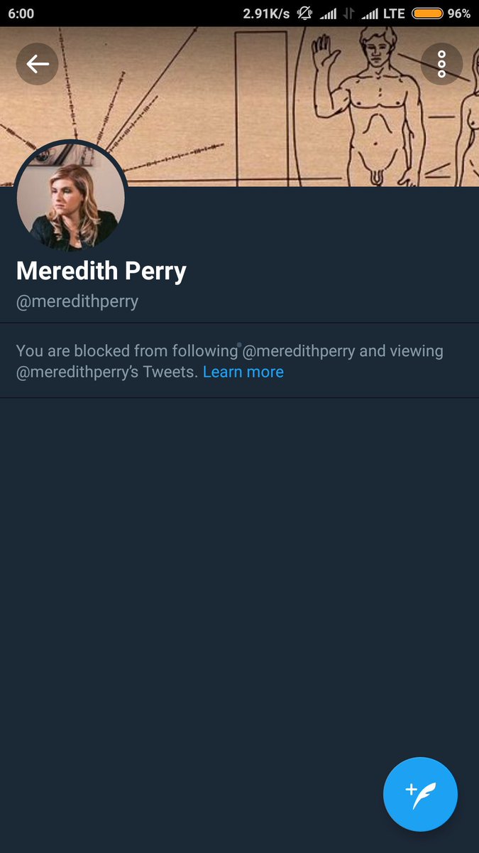

OK, so we now ask Meredith why she banned a guy simply for asking an obvious question.
