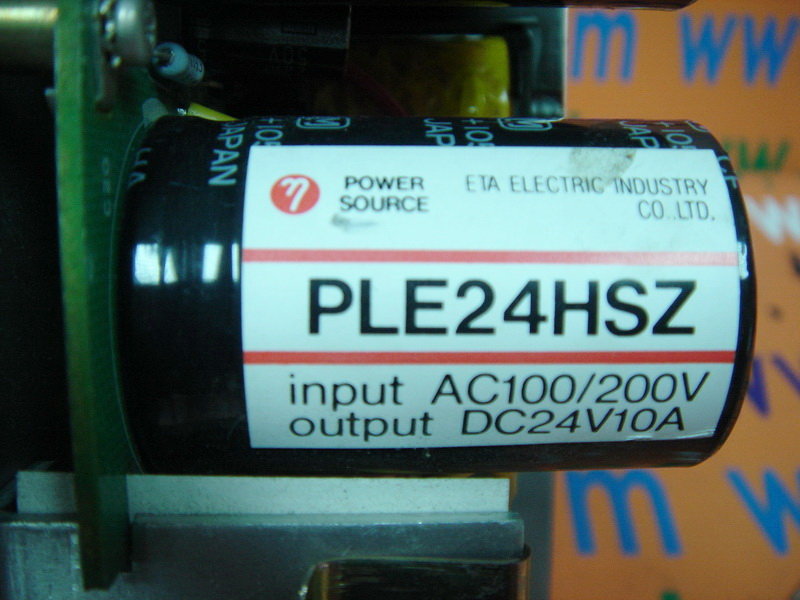

Need help to identify this IC
« on: June 16, 2026, 08:06:31 am »
Hi, can someone tell me what is this IC for ? I seach the internet look for the datasheet but only found a datasheet for different device.
« Last Edit: June 16, 2026, 08:13:28 am by Icuol2218 »

Re: Need help to identify this IC
« Reply #1 on: June 16, 2026, 08:08:21 am »
this?
Online squadchannel
  • Posts: 1268
  • Country: jp
  • deepl translate user
« Reply #2 on: June 16, 2026, 09:17:37 am »
Custom module. Switching controller. There's no datasheet.
made by Eta Electric Industry. already bankrupt.

Offline fzabkar
  • Posts: 3247
« Reply #9 on: June 18, 2026, 01:03:26 am »
This listing suggests that the manufacturer is Nichicon:
https://www.aliexpress.com/item/1005009749808503.html
I don't believe it, though.
This would appear to confirm @squadchannel's post:
https://www.yuyiplc.com/products/9317/image/ETA%20ELECTRIC%20INDUSTRY%20POWER%20SOURCE%20PLE24HSZ_2.jpg

Offline amyk
  • Posts: 9171
« Reply #10 on: June 18, 2026, 02:14:54 am »
What's the machine it's found in? It appears to be of Japanese origin; they were well known for using hybrid circuits in SIP packages like that.
Online squadchannel
  • Posts: 1268
  • Country: jp
« Reply #11 on: June 18, 2026, 02:35:01 am »
It's Eta, it must be a SMPS.
Looking at the photo, it seems like there’s just an IC and a capacitor.
probably something like the SO-16 type. so if you soak it in acetone, it might be able to figure out what it is.

Offline Icuol2218Topic starter
  • Posts: 4
  • Country: my
    • n/a
« Reply #12 on: June 26, 2026, 04:53:44 am »
Yes, it is ETA
