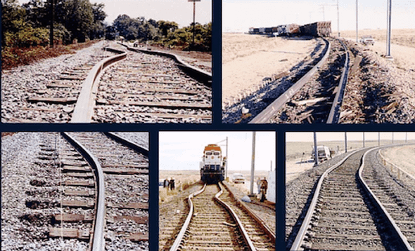

How much do these tracks move during the summer/winter?

Rails don’t move like that. That’s an optical illusion brought about by using a telephoto lens
A zoom lens warped the middle of the screen not the edges? :palm: Oh yes they can move, badly, they are called "sun kinks". They expand 1ft for every 1800ft when hot. They can get shoved by several feet in turns if there is any ballast issue. In either of these cases, normal rail ties usually survive. No way in hell would solar panels take even the relatively small strain each tie takes, unless you added flex points at the connections to tne rails, which means more $, and causing more vibration issues, meaning you'd have to dampen it, meaning even more $ for a tiny panel.
https://www.businessinsider.com/why-train-tracks-buckle-in-extreme-heat-2013-7
Ah yes, more "lens effects". ::)
