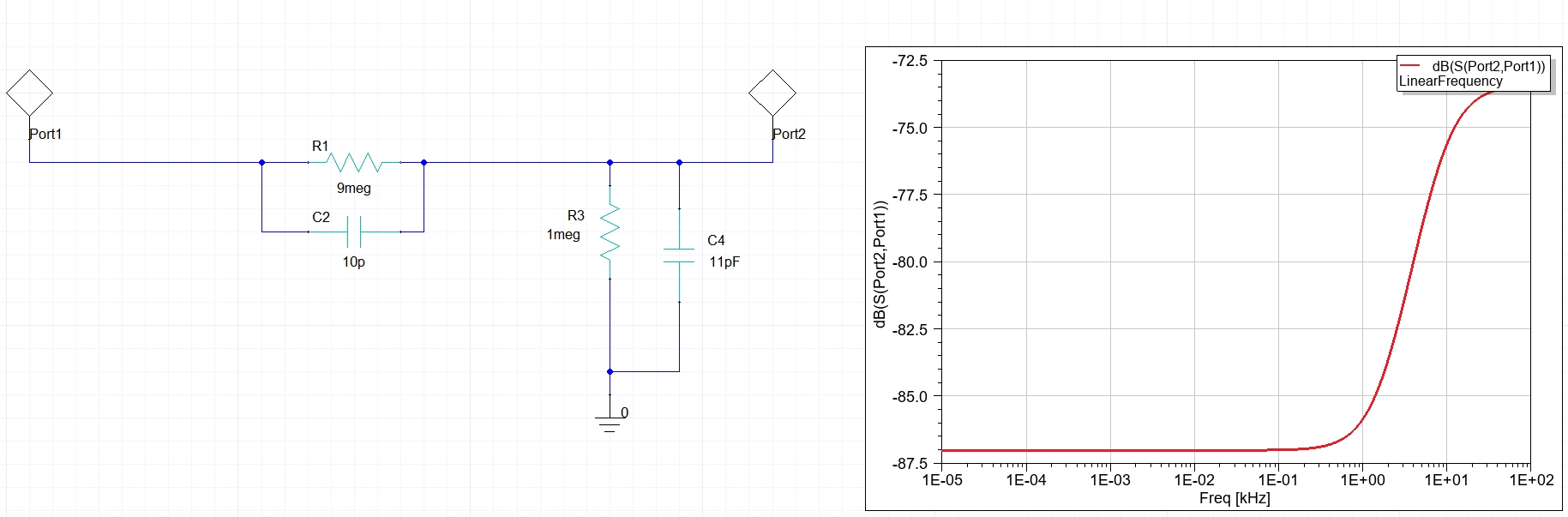

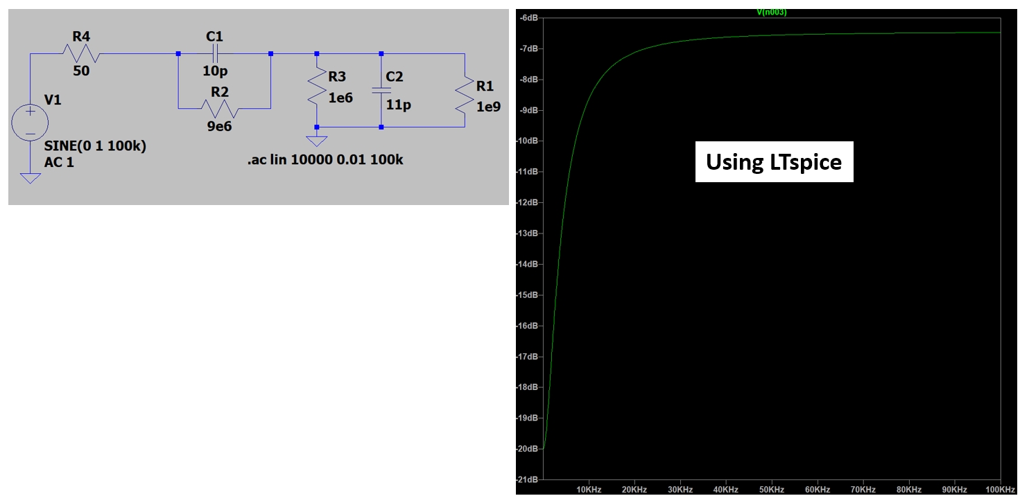

I've been trying for several days to simulate the frequency response of the circuit below using ANSYS Circuit.
First, here's what I get with LTspice:

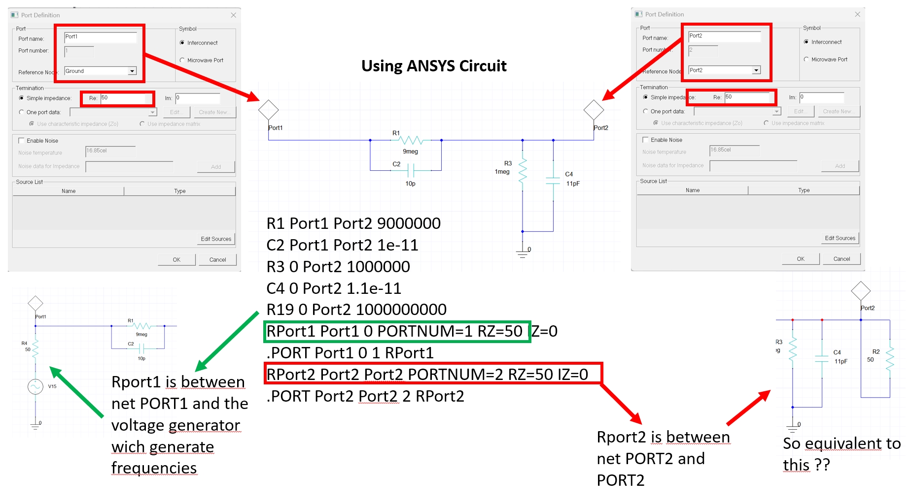

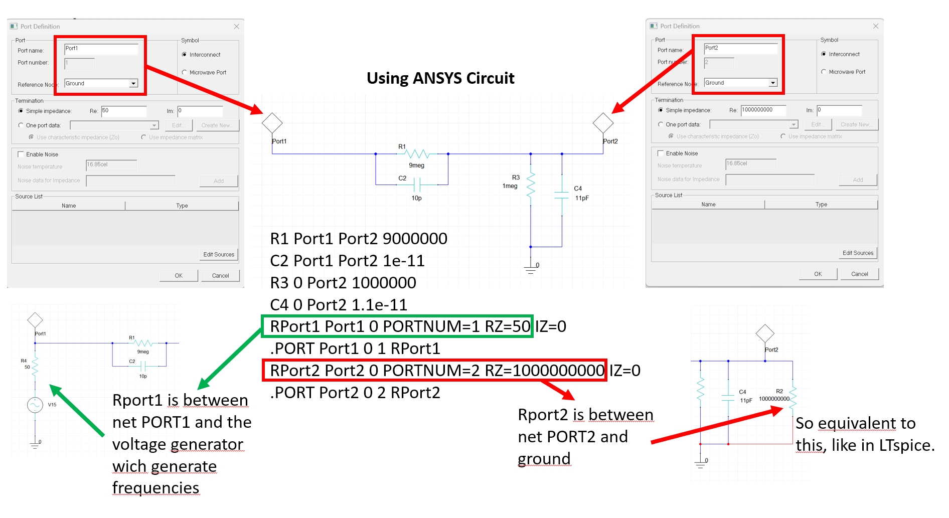

With ANSYS, I have to use ports. For what I understand, but certainely i'm wrong,  is when voltage is injected during a LNA, the voltage generator is in serie with the port impedance. If I configure them like this, here is the netlist it gives me. We see in the netlist that port2 impedance is between net PORT2 and ground, like in LTspice.
Unfortunately, this doesn't work and I get the following result:
Regarding the netlist, it should work no ?? Can someone explain me what is going wrong ??

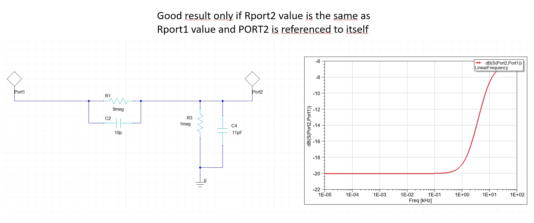

To get the right result, I need to configure port2 with a value of 50 ohm, and referenced to itself. The resistor value need to be the same as the one in port1. For example, if I use Rport1=50, I need to set RPort2=50 to get good result.
When looking at the netlist, what I don't understand is why it only work for Rport2=50, because Rport2 is shortcuted regrading the netlist no ?? So any value for Rport2 should work no ???
I think all this is related to S-Parameters I use for tracing Gain Port2/Port1 and both port need to be same impedance to match. Is this the explanation ?

Use a source and a voltage probe and you should get the same results.
Offline RFDx
  • Posts: 268
You are plotting power gain instead of voltage gain. Leave the source (50 Ohm) on the load (1 GOhm) port as is and just add another trace that shows voltage gain.

Using a linear frequency axis in spice and a logarithmic frequency in ansys also makes the graphs look differently and much more difficult to compare.
