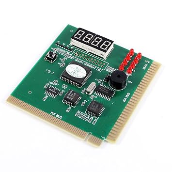

Hahaha I know all about those. Interesting fact: my father actually designed and sold the first third party POST card on the market in the early 1980s. All it did was listen to writes on IO port 0x80 and latch it onto the display. It was all discrete 74LS logic. Made a killing out of those. He went to Taiwan and got it produced there and imported a whole container of the things into Europe.  Next thing he knows they were on the clone market for a couple of dollars each less and everyone was selling them :palm:.
Our house was a warehouse for about 10 years with thousands of imported IO card stacked up everywhere

Yep, I even have a couple variants of those myself, hardly ever used them, infact the last time I relied on of those was so many years ago I have forgotten how to use it even  :-DD :-DD
Edit I still think its more power supply then anything else, shame you don't have a known good one to swap it out with to prove it either way.

Offline magic
  • Posts: 8072
Re: PC power up / unreliable startup debugging
« Reply #24 on: November 04, 2019, 05:16:07 pm »
Try less RAM or at least take it out and put back in, maybe in different slots :-//
And what the heck, try it with a POST card.
