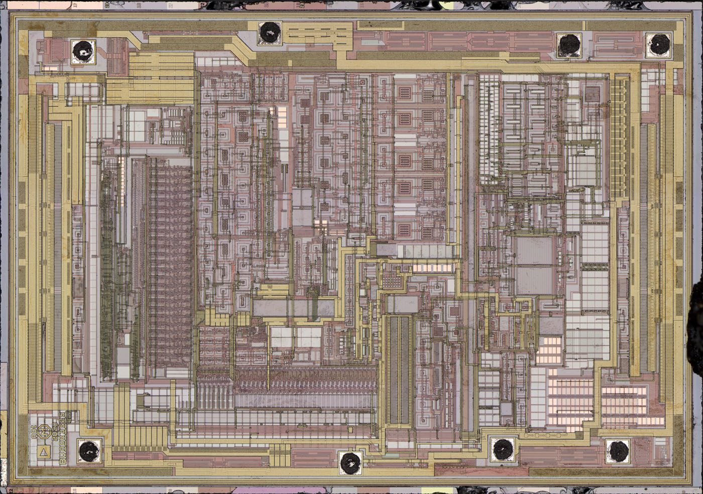

The ADR3625 is a voltage reference with an output voltage of 2,5V. The ADR3630 (3V) and ADR3650 (5V) belong to the same family. The maximum current consumption is 90µA. The ADR3625 can source up to 70mA and sink up to 20mA. Analog Devices sells an A-grade and a B-grade. Unusually, the output voltage of the B-grade has the lower initial error with a maximum of 0,04%. The output voltage noise is specified as 7,5µVpp. The typical temperature drift is 2ppm/°C. With the A-grade, the value remains well below 3ppm/°C.
The datasheet contains a block diagram. It is very similar to the block diagram of the ADR3525. The only difference is that a large number of protection diodes have been added. While the ADR3525 datasheet refers to a special operating mode of the bandgap reference, there is no mention of this technology in the ADR3625 datasheet.
The die of the ADR3625 measures 2,20mm x 1,55mm, making it significantly larger than the die of the ADR3525.
This image is also available in a higher resolution: https://www.richis-lab.de/images/REF01/54x03XL.jpg (37 MB)
The design dates back to 2020. BV most likely stands for Beaverton, an American location of Analog Devices. The full designation ADR3625 is shown here. This could mean that the various output voltages are set via the metal layer. However, it is equally conceivable that the present design can represent all three output voltages and will be configured appropriately after production. REV-F shows that the circuit has been revised several times.
The letters and numbers are all connected to each other and even contact a deeper layer in the lower right area. This ensures that no errors occur due to electrically isolated islands during automated design checks.
The circuit is quite complex and therefore cannot be analyzed in detail. However, it appears to be fundamentally different in design from the circuit in the ADR3525. The most striking feature is the output stage, which has been divided into two blocks. These blocks have been placed on the left and right edges. Due to the high output power of the ADR3625, a lot of power loss can occur in the output stages. By placing them on both edges, they heat up the die more evenly.
The ADR3625 datasheet mentions that it is configured using the DigiTrim process at the end of production. In the vertically arranged block shown here, you can see the circuit components of 25 fuses. To the left of this is certainly the control logic for this configuration option. The large horizontal block at the bottom edge appears to contain 32 switchable current sinks, thus representing a type of DAC. However, control lines to various other circuits can also be seen.
The circuit block with the fuses is reminiscent of the integrated circuit in the ADR3525, but is not completely identical to it.

Does DigiTrim use memory cells? I couldn't find the patent.
"Digital control of adjustment currents through logic circuits and weighted current sources."
"DigiTrim adjusts circuit performance by programming digitally weighted current sources. In this patented new trim method, the trim information is entered through existing analog pins using a special digital keyword sequence. The adjustment values can be temporarily programmed, evaluated and readjusted for optimum accuracy before permanent adjustment is performed. After the trim is completed, the trim circuit is locked out to prevent the possibility of any accidental re-trimming by the end user.
The physical trimming, achieved by blowing polysilicon fuses, is very reliable. No extra pads or pins are required for this trim method and no special test equipment is needed to perform the trimming. The trims can be done after packaging so that assembly related shifts may be eliminated. No testing is required at the wafer level assuming reasonable die yields. No special wafer fabrication process is required and circuits can even be produced by our foundry partners. All of the trim circuitry scales with the process features so that as the process and the amplifier circuit shrink, the trim circuit also shrinks proportionally. The trim circuits are considerably smaller than normal amplifier circuits so that they contribute minimally to die cost. The trims are discrete as in link trimming and zener zapping but the required accuracy is easily achieved at a very small cost increase over an untrimmed part.
The first part to use this new scheme is Analog Devices AD8602 dual, low cost, rail-to-rail CMOS amplifier. The offset voltage is trimmed for both high and low common-mode voltage conditions so that the offset voltage is under 500 µV over the full common mode input voltage range. With a bandwidth of 8MHz, slew rate of 5V/µS and current consumption of only 640 µA per amplifier, this part will support a variety of high volume, cost sensitive applications from bar-code scanners to GSM phones.
The DigiTrim approach could also support user trimming of system offsets with a different amplifier design."

I haven´t found very much information about the DigiTrim technology either.
Reading what is public shows us they use polysilicon fuses. Whether there are additional volatile memory cells is not clear. But it would make sense because I assume it´s easier (faster) to tune the correction values when you can toggle the bits more than once. Time is money.
In my view the circuit around the fuse is big enough to contain one volatile memory cell for each fuse.

These trim methods use volatile memory cells that get loaded with the states of the fuses and are fed into a DAC upon power-up. It doesn't take anything more than a simple flip-flop to hold the value; you only load the fuse states once on each power-up and don't care if those lose the information on power-down. Next power-up they will reload.
The time is spent in the ATE to go through and trim parts after assembly. Trimming at wafer sort requires as much time (or more) as post-assembly trimming and you widen your distribution if you trim at wafer sort because of stresses involved in packaging. Wafer sort now becomes a simple functional test (which is quick) and the digital logic inside the chip gives you fairly fast tuning of critical parameters at final test. The way it often gets done is to make a measurement or two, load a first "guess" into the volatile memory, then see the result. From there, it doesn't take a lot of additional time to try several of the trim codes around that guess point to find the best one. Once it's known what the best codes are, the associated fuses can be blown and finally the chip can have the trimming locked down.
Yes, time is money for all of this. But the tradeoff is that you can spend an extra penny or two in ATE time to get a part with better specs that can be sold for an extra five or ten cents.
The old metal fuses could not be done in a molded package. Zener zaps required significant current and voltage. Laser trim had to be done at wafer sort and was very slow (not to mention adding extra process steps). This method of post-package trim gives a better product at a cost of the die area for the digital logic.
The interesting thing about all of this loading of fuse states into memory is that you don't need to simply restrict yourself to trimming analog circuits. I've seen serial numbers locked into chips to track trim values from one test point to another, not locking down final trim values until the last test point was done. Saving that data together with the lot codes meant any returns from customers could be looked up to review individual part test results before sale.
