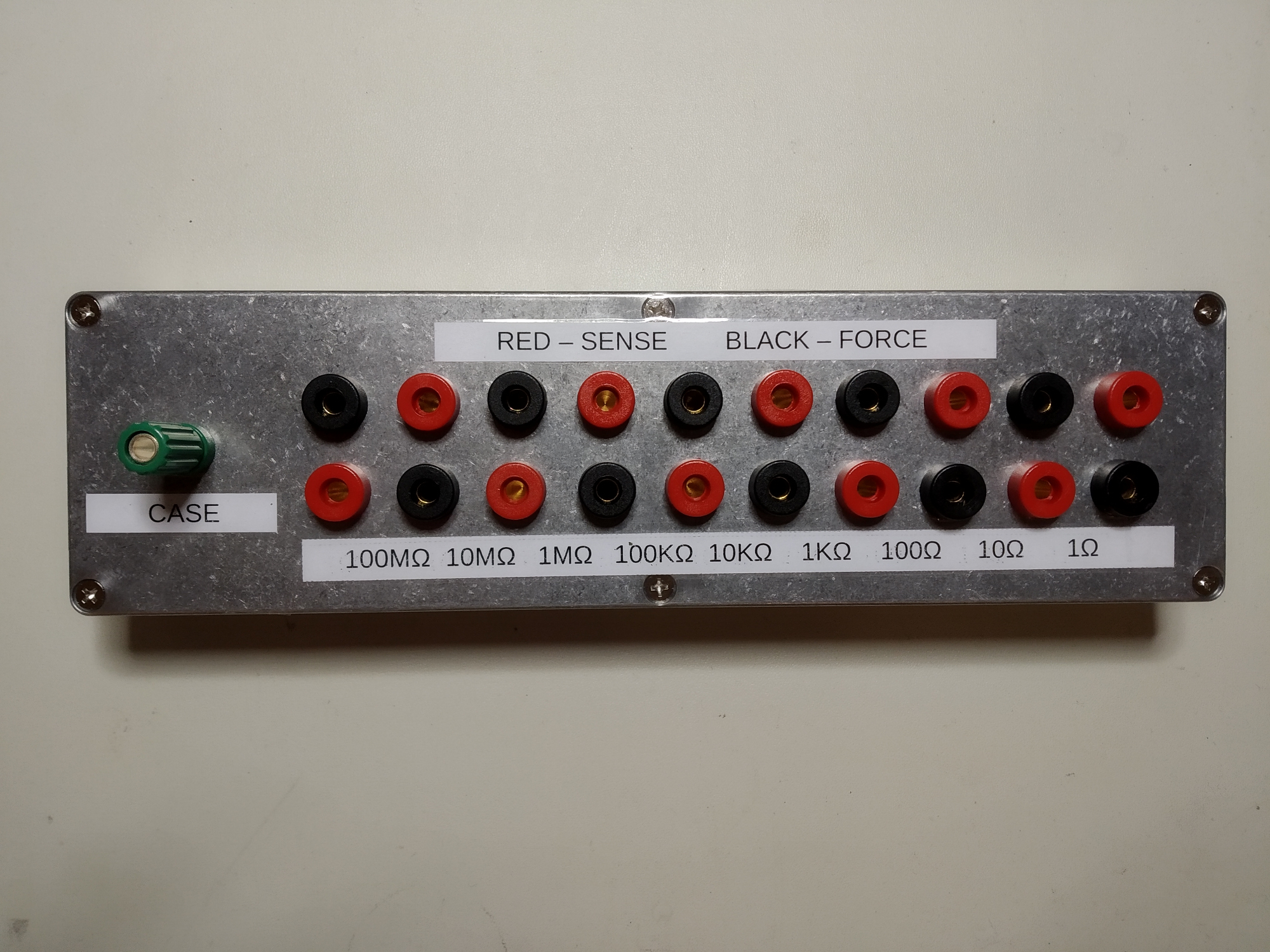

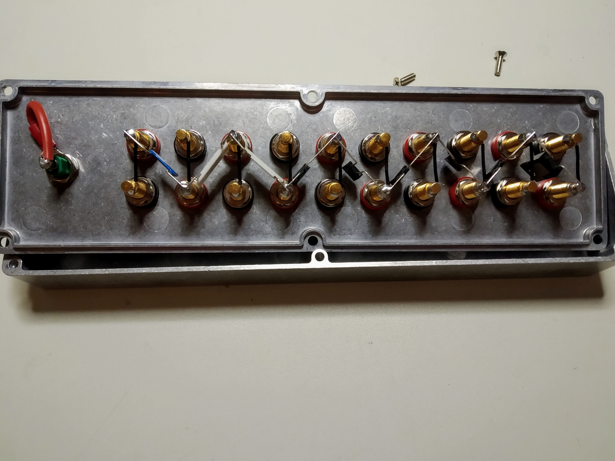

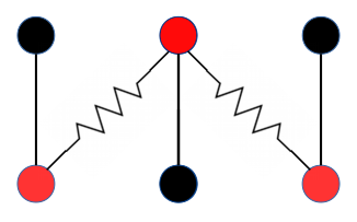

A much better way of installing your resistors in a box is to arrange them like this:
Black terminals are force and red are sense. You eliminate the extra wiring over and above the resistor's leads this way and you can extend such a layout as you wish by flipping the arrangement horizontally. The layout also ensures that there are two soldered connections for both sense and force.
The result looks like this:
Calibrated values are on the back:
And internally, it looks just like the the layouts above:
The box is built from a Hammond aluminium case and a reasonable selection of precision resistors with 1% to 0.005% tolerances and as low TCR as I could reasonably buy. The 1Ω resistor is from Bourns, mid values from Vishay, the 1MΩ and 10MΩ from Caddock and the 100MΩ from Ohmite (that's the one with 1% tolerance). When I was at a cal lab earlier this year, I had them measure all of the resistors with their 8.5 digit Fluke meter and then measured them with my 7.5 digit meter just after they had calibrated it. Thankfully, after installing all the resistors in the box, none of them had changed resistance as far as I could see to 7.5 digits.
The box will shortly be filled with silica gel desiccant and sealed with silicone gasket material. I just want to give it a couple more measurements before permanently sealing it. I'll send it off to the same cal lab next year and get a second calibration to update the label on the back.
Like RoadRunner, I also looked at the Pomona 3770 binding posts but they were prohibitively expensive (just the posts would have cost €200!), so I settled on some gold plated brass banana sockets instead. The resistors in the box probably cost around €200 in total and doubling the price for the box seemed excessive. The result is something which is perfectly acceptable for my needs.

This is a very nice optical practically assignment of the sense and force. But does this also make sense from a metrological point of view compared to central soldering?

Another remark regarding connectors for resistor boxes, also to save space and some money, not saying it is better:
I've found it is quite acceptable to use a single binding post for both force and sense connection.
This only works when both connections aren't touching each other inside the binding post, i.e.
use a banana on the inside and a fork or copper wire on the outside.
Any contact resistance is then out of the equation, the only parts that become part of the total resistance path
are the butt-end of the binding post and the solder connection to the resistors leg.
Before I build my r-box with single heavy duty Hirschmann pki10 au I've
tested measured this resistance with two small/used/cheap/crusty binding posts soldered butt to butt together,
just repeated the test today, its still around 0,0003 Ohm and unlikely to change with time and temperature,
the Hirschmann's where even much better but cant remember the exact number and don't have spares at the moment to test.
Ok, worst-case situation, we use our two crusty binding posts for a really nice 1 kilo Ohm resistor,
so instead of 1000 Ohm the total resistance becomes 1000,0003 Ohm, perfectly fine because we calibrate it as a finished product, but after time in a unlikely way the resistance of our binding posts changes with 10%, shifting our resistor value
from 1000,0003 Ohm to 1000,000033 Ohm that's still a 0,03 PPM error worst case,most people can live with that.
For higher resistor value's the error becomes even lower, and single binding posts are also more desirable to help reduce leakage current (less surface area).
For lower value high precision resistors a proper 4 terminal kelvin connection is more suitable, also to take as most of the resistance of the resistor legs out as possible, or even connect to dedicated terminals on the resistor body.
Just my humble 2 cents.
Inside construction:
Separate force (10mA thru spades on the outside) and sense (4mm banana on the inside):
edit: larger pictures

Isn't the best way to solder one pair of terminals (typically Force) to the ends of the resistor leads, and then solder the other terminals (typically Sense) to points part way up the resistor leads?
I thought that was the proper way to do true Kelvin sensing. It avoids the force current and sense potential sharing any solder joints.
Yep, but not absolutely mandatory for higher resistance value's.
Yes, agreed. You could probably argue that it is a possible improvement the Thermal EMF perspective though. If you swap the force and sense terminals in my description above (so that the, hopefully closer spaced, sense terminals connect to the ends of the resistor leads) then there is only one solder joint on each lead, rather than two.
It would also allow the force terminal connections to be extended with short lengths of wire (from the force terminal to the mid the point on the resistor lead) to cope with the resistor leads being too short to span 4 terminals. Additional Solder joints and wire length in the force circuit are of minimal importance.
Just thinking aloud.
