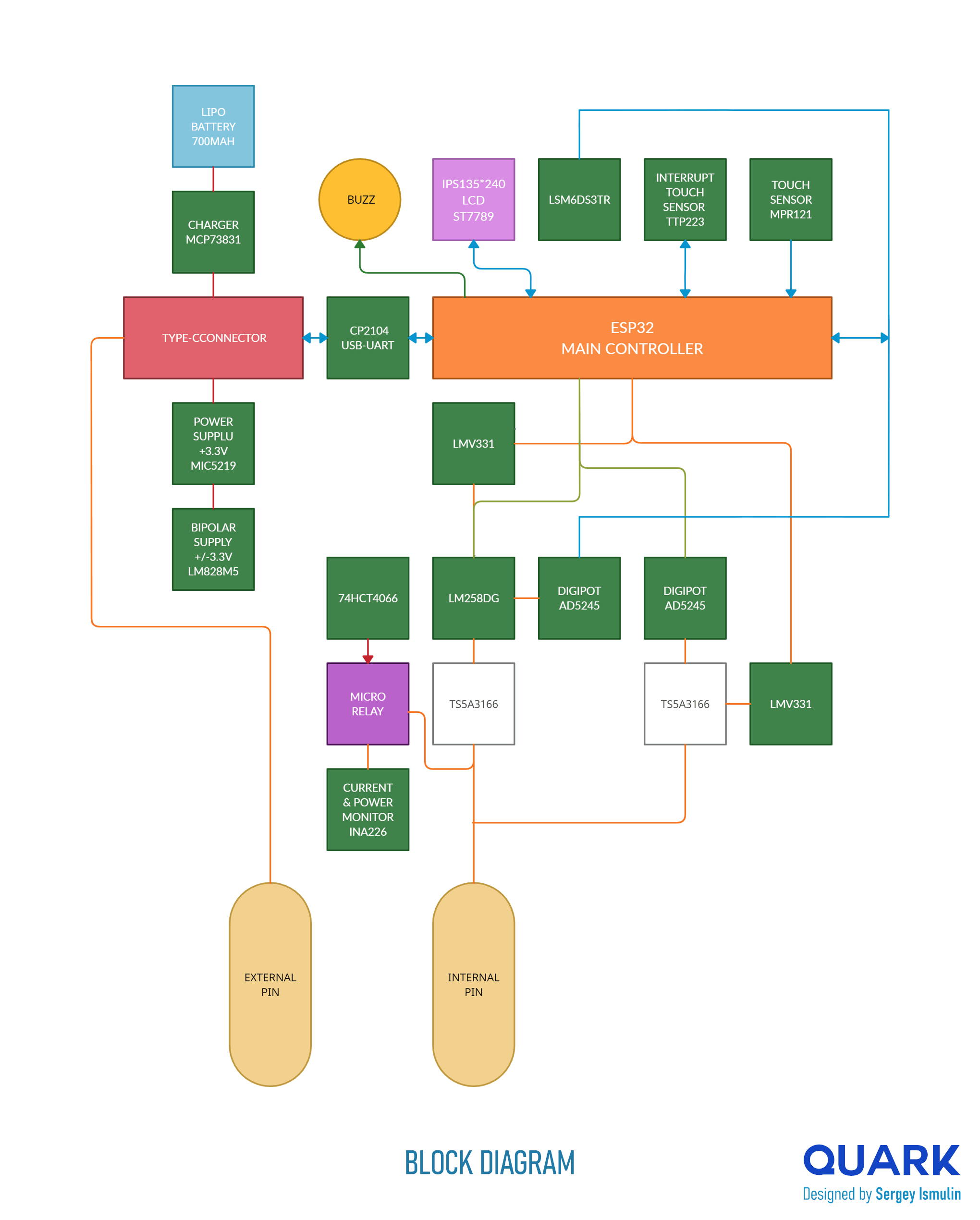

I got this project: it looks very interesting.
https://www.crowdsupply.com/mulin/quark

That sharp end will either break off, or stab you when you are least expecting it, etc... They need to make it retractable or removable/replaceable.
Also, the grounding - this happens through the USB port? 3.3A?

The input does not look very fast, so the long ground lead may not be such a problem.
The display at the end of the probe can still be a bit unconvenient - you just don't see the tip anymore. With a wireless display it may be OK - though more like a tiny, limited frequency scope and not a DMM replacement.
The still have to invent the wireless ground lead.

Ground is likely (high impedance) ac coupled thru the operators hand.

Measures voltage from 0 to 26 V
Measures current from 0 to 3.2 A
Measures resistance from 0 to 2 MΩ
Measures capacitance from 2 pf to 1000 uF
Measures inductance up to 1 H
Oscilloscope has a sampling rate of 400 kHz

Not if it does more than only producing wobbly lines on a tiny screen.  :-//

This is one of those objects that are useless without extra things that completely break the design.
