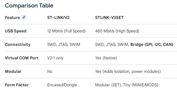

Anyway, I went to look for the V2 to V3 differences (because I've been using V3 for years) and actually they are insignificant for the vast majority of projects:
I am fairly sure though the V2 / V2-ISOL did not support the SWV ITM debug channel. But the current info claims it does.

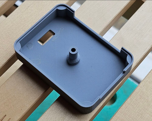

The V3 ISOL has a problem in that ST never produced the "filler section" to close the huge hole around the isolation board, so I got some 3D printed. Actually there are loads of sellers of these in China...
whereas the V2 ISOL is all one piece and enclosed.
