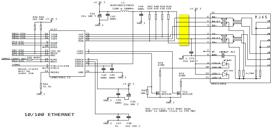

In one project I have 1cm PHY-CPU and then 1cm PHY-RJ45. So that should be good :)
In this next one, the CPU and the RJ45 are about 10-15cm (track length) apart.
What this comes down to, I think, is that for either the RMII tracks or the MDI (?) tracks I have complete freedom to create the correct transmission line properties. So surely it must be possible, one way or the other. Most of the distance will be on a single PCB, 1.6mm, and this can be 6-layer, so I can use an impedance calculator to do it correctly. I even looked at Rogers material but apparently this is wasted for these frequencies.
FWIW, this whole thing will be in a metal case, all six sides conductively anodised and electrically connected. Obviously this will almost eliminate radiated EMI but not conducted. But also I do not want to radiate excessively internally, which is why I can go to 6 layers for the PCB and run these tracks between layers.
What impedance should I aim for for the PHY-RJ45 tracks? Presumably the best one is the differential pair to be adjacent tracks and between layers, but none of the online impedance calculators make it clear how to achieve this.
« Last Edit: July 18, 2026, 03:13:11 pm by peter-h »

Yes. But keep in mind the magnetics where at the edge of the board. Not near the phy. And yes, this product passed CE and FCC testing with the lowest limits for consumer / industrial products.
For the PCB design the single ended impedance should be 50 Ohm and the differential impedance 100 Ohm. What can make 10/100 Mbit challenging are unused pairs in the ethernet cable. If you can, use the Bob Smith termination to terminate unused pairs. The typical 10/100 Mbit magjacks have this internally.

For RMII (10/100 Mb Ethernet PHYs), placing the PHY closer to the magjack can be defended, although 15 cm is starting to be a bit on the long side. I have seen numerous app notes indeed suggesting to place the PHY closer to the magnetics, but they rarely deal with such long distances between SoC/MCU and PHY.
If it were RGMII (1 Gb PHYs), I would definitely consider 15 cm to be too long.
I think it's reasonable to place the PHY closer to the MCU and carefully route the MDI lines, which are differential pairs, to the magnetics. You'll have to use controlled impedance to maximize your odds of passing EMC.

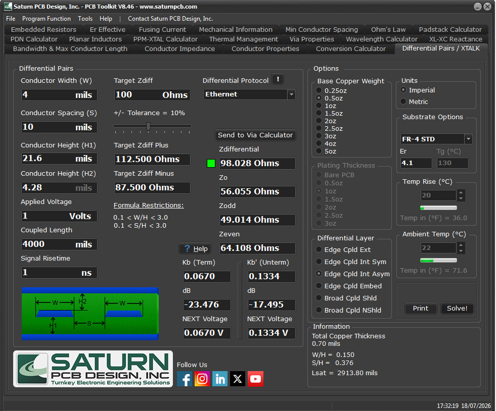

Right. This is what I arrived at
The stack-up is JLCPCB's, with very unequal dielectric above and below the signal tracks, and actually slightly different Er too.
« Last Edit: July 18, 2026, 04:46:35 pm by peter-h »

I'd investigate whether you can get to a diff pair with less space in between. Putting the traces on the top or bottom layer might be a better option. The rule of thumb is to keep diff pairs apart 5 times the spacing for the pair. That is going to take quite a bit of space.
« Last Edit: July 19, 2026, 10:02:26 am by nctnico »

What kind of line driving resistors should be placed into the signals going from the LAN8742 to the integrated-magnetics RJ45?
The signals are "analogue" so should not be square wave at this point.
I would think probably nothing should go in there. But is there really no harmonic content?
