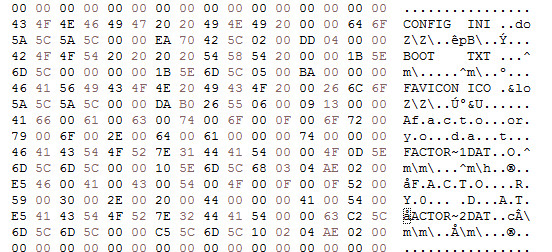

I have an embedded target which has a 2MB FAT12 USB MSC drive which is visible to the internal firmware with FatFS which has LFN (long filenames) disabled so all files are 8.3 only. The firmware can be updated by dropping a file factory0.dat into it and rebooting. It looks for a file factory0.dat.
From windows, you can drop in a file
factory0.dat
FACTORY0.DAT
and it works. The file is written into the directory as FACTORY0.DAT which is right for 8.3. The dir entry is uppercase.
I know windows is "not case sensitive" but it is still an interesting observation that windows maintains the case in its filesystem, but when asked to write the file into another disk which is FAT, the destination directory entry is uppercased. I tested this with a FAT32 flash stick. But somehow windows displays that filename in lowercase - how does it know?
Now the fun bit. When I use android (USB OTG) to write that file, it ends up as FACTOR~1.DAT. I am using the MLUSB app to mount FAT12 drives. In other words, even though the file can fit into 8.3, the host wrote it as LFN. And this is true regardless of its case on the source drive.
Is this a bug in MLUSB or even android? I thought that if a filename can fit into 8.3 it should be thus written, for FAT drives. It should not be written as a LFN.
It might mean that for these kinds of firmware upgrades to work, the device (FatFS) needs to look for both the 8.3 filename and its 8.3-compacted LFN version.

This also means that from Linux/Android, you'll want to name the file as FACTORY0.DAT before dropping in to the VFAT
I did that but it still ended up as FACTOR~1.DAT in the directory sector. And no other directory entry, which I think is wrong because if you have an LFN you should also have the mangled 8.3 version.
FatFS will open a file with any case filename, for sure if LFN is disabled. I have tested this many times.
The above unix mount link suggests that a FACTORY0.DAT (i.e. all uppercase) should not get mangled, but it does.
Anyway, I solved this with a rename of any factor~1.dat to factory0.dat at startup :)

Can you show me the mount options (the relevant line in /proc/mounts), when the drive is mounted?
No idea where this might be, on a non rooted android phone
Also the context is this
https://www.eevblog.com/forum/microcontrollers/any-way-to-do-a-fat16-usb-msc-drive-in-2mb-flash/
where android does not see FAT12 at all and I have to use the MLUSB app to access the drive.
Also remember that if you already have a file named FACTOR~1.DAT with a long name factory0.dat, Linux VFAT will always use the long name if it exists.  Thus, you need to delete any existing file before dropping in a new one.
Interesting... but actually I did delete existing file before the write.
There was another issue which I suspected might be doing this: I was using dropbox to transfer the file to the phone (to storage/temp or some such path; this is not a rooted phone because a lot of apps check for that) and when downloaded from dropbox it ended up as factory0.dat.pac which I then renamed (in a proper file explorer, not the crippled MyFiles) to remove the .pac, and yeah you can guess... So I repeated this by copying the file to the phone via USB and this prevented the .pac rename. But same result in the FAT12 drive.

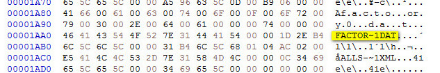

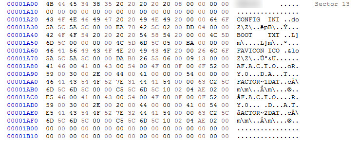

The more basic point is that when I am seeing FACTOR~1DAT in sector 13 (above screenshot from HXD) which presumably is an attempt to create an LFN, I am not seeing any other entry for that file. There should always be the 2nd entry, FACTORY0DAT, no?
« Last Edit: March 13, 2026, 09:54:02 am by peter-h »
No, FACTOR~1.DAT is the short FAT file name entry.  It is always 11 bytes, padded with spaces, with implicit . after the eighth character.  If I understand correctly, you want only the FACTORY0DAT entry.
The LFN uses UCS-2, so the long filename entry for factory0.dat should be
    66 00 61 00 63 00 74 00 6f 00 72 00 79 00 30 00 2e 00 64 00 61 00 74 00 00 00
as a single (not split) 13-character/UCS-2 slot.
I wonder if renaming the file to FACTORY0.DAT in Android, after transferring it, makes any difference?
Also, if you have the time, could you check if using (incorrect) name FACTORYO.DAT, i.e. use letter O instead of zero, makes a difference?
It is possible the logic for uppercase/lowercase-only name detection is wonky in the filesystem driver, so that all filenames with non-letter characters are treated as neither uppercase nor lowercase, b0rking the long filename selection logic.  If so, I can see if I can find and fix the bug in the filesystem driver causing this.  Otherwise, it is a bug in MLUSB application, specifically long filename support — but I do believe it simply uses the kernel mount interface, instead of implementing a full filesystem driver.
Yes.
Renaming the file (in MLUSB) didn't help with the filename, but it created what looks like a Unicode name
Under windows the directory looks like this
No difference in that FACTOR~1DAT is still produced. How can it be the same, when 0 was changed to O?
The point is that windows and linux both produce FACTORY0DAT in there and no other entries...
This could be quite a rabbit hole. I always thought that if a filename can be represented as 8.3 it is stored (in FATxx) as 8.3 only, and only when LFN is required then you get LFN and the crunched 8.3 version.

Long filenames are simply "magic" VFAT directory entries (compare to FAT directory entries) that encode the long name, with up to 20 directory entries chained for a single name.  Their type is volume label (and filesystem drivers will create a volume label if there is none and you create a long filename in the root directory).  There are some rules on how filesystem drivers need to handle missing and deleted names, but that is about it.
Thus, whether a filesystem driver creates long filenames or not, is up to the driver.  It can choose to create a LFN for a file whose name is perfectly okay 8.3 name, or not; the use rules (always use LFN first if it exists) allow it both ways.
Because the issue is that your Android filesystem driver/app always creates long filenames, unlike the Linux fat/msdos/umsdos/vfat driver.
If the standard Linux fat/msdos/umsdos/vfat driver was used, the shortname= mount option controls this, and the only possibility is that somehow, the filename is not recognized as uppercase 8.3 format.  Again, when the default shortname=mixed is used, this driver creates only the 8.3 name if it is uppercase and fits, and a LFN in all other cases.  I supposed it was possible that a zero, not being a letter, throws it off, but looking at the Linux kernel sources (fs/fat/namei*.c), I don't think so.  Ergo, I think this is a bug in the Android MLUSB Mounter you're using.

I still don't get how the FAT12 (or FAT32) can remember the 8.3 filename case
Since Windows NT, bits 3 and 4 at offset 0xC in the short name directory entry encode the case.  If bit 3 is set (0x08), the base name is displayed in lower case.  If bit 4 is set (0x10), the extension is displayed in lower case.  Otherwise the shortname is displayed in uppercase.
So, if the factory0.dat directory entry is
    46 41 43 54 4f 52 59 30  44 41 54 20 00 ?? ?? ??
it will be shown as FACTORY0.DAT, but
    46 41 43 54 4f 52 59 30  44 41 54 20 18 ?? ?? ??
as factory0.dat.

I got a reply from MLUSB:
As a quick follow-up, I checked the directory sector dump (sector 32).
The long filename entry for "factory0.dat" is present in the directory, but
the generated short filename is "FACTOR~1.DAT".
So your observation appears to be correct. The file itself is written
correctly, but the short filename generation behavior differs from Windows
(which generates "FACTORY0.DAT"). This is likely something that should be
improved.
I had not checked further along the disk to spot the LFN. And LFN is disabled in FatFS in my case.
