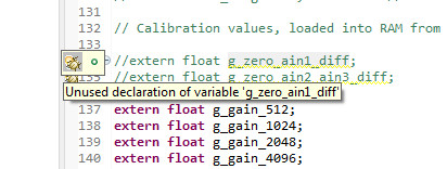

Indeed, one does not have to upgrade the editor or the tools. GCC is pretty mature now and it is hard to imagine a scenario where a later compiler would be needed.
Just come across a weird one: these warnings are generated (or stuck from a previous build) even if the code is commented-out
I got rid of them by cut/paste of the offending line(s).
For some reason I have not had this before.
Did you try closing the IDE and opening it again? Bugs like that are common in almost all IDEs. Just had to "reboot" VS code today because it tried to parse // comments as code - while still coloring those as comments, except a few words in the middle. It's one of the mysteries of the human kind - why IDEs are buggy crap, much more than e.g. compilers, web browsers etc.

No I just did a cut/paste of each offending line. Good point though.

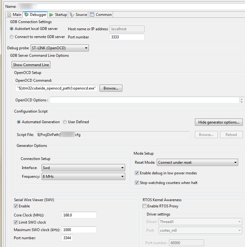

AIUI you can use any editor outside Cube IDE.
Cube has a config option to check for updated files, which IME "mostly" works, so external editing is fine. I still do a Project/Clean Project when importing a load of edited stuff, plus an index rebuild, just in case.
The long term hassle with Cube IDE has been losing the debugger interface, especially when left in running mode (with or without breakpoints). People have advised spending 3+ digits on a Segger but then you lose the integration. I found a huge debugger interface reliability improvement by using the OpenOCD debugger mode (with STINK V3) rather than the GDB Server mode
