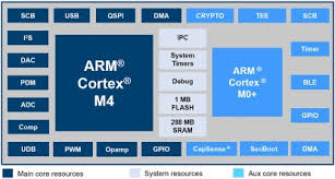

Author Topic: PSOC 6 Dual Arm Core embedded  (Read 8178 times)
Offline danadakTopic starter
  • Posts: 1875
  • Reactor Operator SSN-583, Retired EE
« Last Edit: March 20, 2017, 01:29:48 am by danadak »
Love Cypress PSOC, ATTiny, Bit Slice, OpAmps, Oscilloscopes, and Analog Gurus like Pease, Miller, Widlar, Dobkin, obsessed with being an engineer
The following users thanked this post: evb149, newbrain
