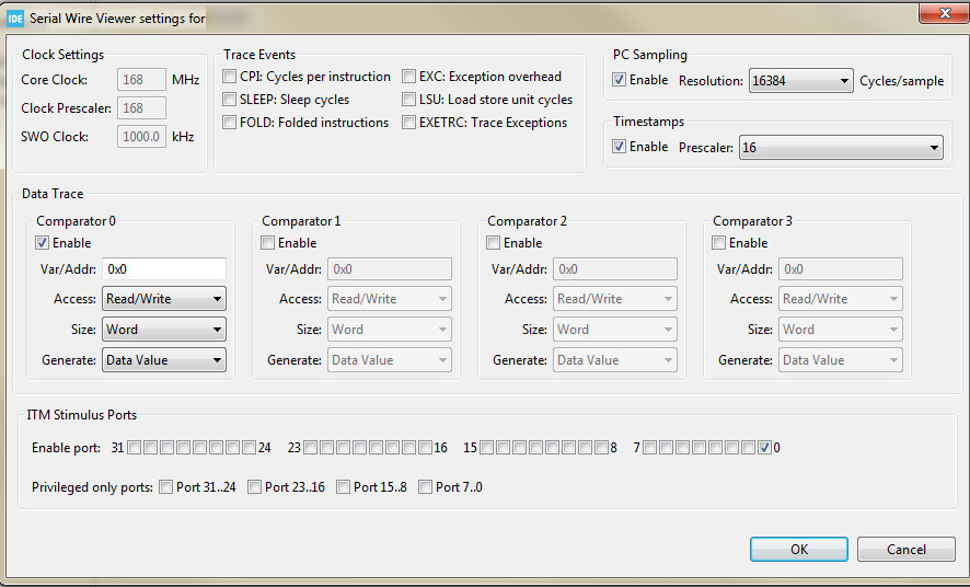

I have been investigating why most (not all) STLINK V3 debuggers are persistently unreliable, in the SWO feature, which they call SWV ITM debug. It is a high speed UART which comes out on the SWO pin of the SWD interface.
On a scope, I see the data coming out on the SWO pin going into the debugger, so it is apparently nothing to do with the source code. The first mystery is that in all the ST example code there is no config for this feature. So initially I thought they just rely on power-up register values.

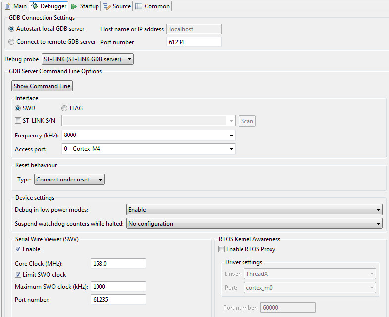

As regards Cube IDE config for this, the debugger config (under Project Properties Debug etc) looks like this, and one can control the SWO speed so e.g. this
produces 1MHz. One can check this with a scope.
But still Cube IDE shows no data, even though the scope shows the bits 1us wide. So I wondered if the UART has the right config...

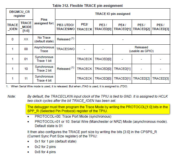

so the debugger actually sets up all this, by writing into the relevant CPU registers!  So no wonder that ST do not provide SWO setup code in their code examples...
As to what data the debugger is then looking for in the way of data format, I can't find this but since there is no clock signal coming out, I would expect SWO to be straight NRZ like RS232.
This whole thing is a mess. Fairly obviously, if you include any code to configure this SWO feature, that will execute after the debugger has configured it, so now Cube needs to be configured to match your software config.

This is expected behavior. Debuggers will configure relevant debug peripherals whoever is appropriate for the current settings. Debuggers can't expect your code to configure the hardware correctly. They are used to debug potentially buggy code. There are tools that are just trace receivers. They will not configure anything and will expect you to provide configuration details.
In some device those components will not even work unless debugger presence is detected.

This is the other Cube IDE config. I don't think comparator 0 does anything but most people have it ticked
BTW after doing the Cube config in post #1, one has to exit Cube and restart it before the /168 clock prescaler etc shows up correctly above. One of many gotchas...
« Last Edit: September 30, 2025, 05:39:34 pm by peter-h »

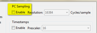

  • Posts: 6016
Well, bloody hell, it looks like it is this
Must be disabled!

If you don't want extra data in the trace, then also disable the "Comparator 0" or you will get events every time address 0 is accessed.
But all those things are kind of the point of the trace. If you just need UART - use UART.

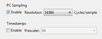

This is weird. Some years ago I used PC Sampling to get a graph of where the CPU spends its time.
I think I must have used it to get the data for this
https://www.eevblog.com/forum/microcontrollers/freertos-where-should-the-cpu-be-spending-most-of-its-time/
But now it breaks it. May be something in the clock config e.g. I am running SWV ITM at just 1MHz. But nothing I tried makes any difference.
It looks like SWV ITM, and SWV Statistical Profiling, are mutually exclusive. For the former you must disable PC Sampling, for the latter you (obviously) need it. Jesus... But I now find statistical profiling is extremely flakey. It works but only over a very small address range; just the bottom 32k or so. Never mind.

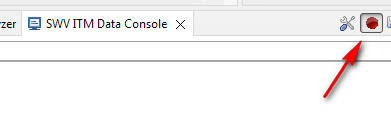

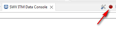

Another issue, which I found a long time ago, is that this button must appear like this, and then you click on it, and only then the SWV ITM works.
When it is ready to receive the SWV data, it must look like this
With both versions of the button, hovering over the button says Start Trace ;) Stupid software...

EDIT: above now verified across 3 machines, win7-64 and win10. PC Sampling must be disabled for SWV ITM console to work, and the red button operation as described above.

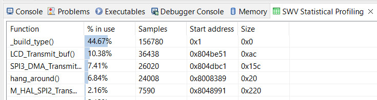

And statistical profiling is dud. I can sometimes get some data, but only from the boot block (bottom 32k). That data looks correct, but the behaviour looks like the data collection is limited to the bottom 32k of the address space.
This stuff is so weird.

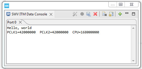

I found something useful: if you "detach" the SWV ITM Data Console window, so it looks like this
then it comes up always ready and you don't need to fiddle about with the above red button!

Setting both the SWD speed to auto, and the SWO speed to auto (comes up at 12MHz, 12x faster than my usual setting), makes no difference. Enabling PC Sampling totally blocks the SWV ITM debugs.
Sampling rate is the slowest available: 16384 cycles
BTW, one has to exit and restart Cube IDE after each change to the debug settings page, for it to be reflected in the config page of which the above is a small bit.

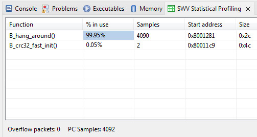

The statistical profiling function is almost useless no matter what I do. It did work a few years ago...
Now, when I pause the target after some mins, all I see is
and those functions are in the 32k boot block. This is after the CPU has run billions of instructions from the main FLASH. It is as if there was something in my main() (which is located just above base+32k) which blocks the data collection. That is very possibly where changes have been made since a few years ago, but there is so much stuff...

Unless someone comes up with a way to lift the ~4096 packet limit, I will give up on this. I have a working solution for SWV ITM debugs...
FWIW I have reverted to this code for enabling CYCCNT
// Enable CYCCNT as a free running counter, for various timeouts where we
// don't want to rely on interrupts.
// Runs at SystemCoreClock Hz AFTER this is set up.
CoreDebug->DEMCR |= CoreDebug_DEMCR_TRCENA_Msk;
DWT->CYCCNT = 0; // start it at zero
DWT->CTRL |= DWT_CTRL_CYCCNTENA_Msk;
EDIT1: switching to the OpenOCD debugger mode (still using STLINK V3) briefly worked for both profiling and the SWO debug. Bloody hell! Well, for about an hour, then it all broke. I am testing concurrently on two machines, too... I've not been able to get anything working in the OpenOCD mode since. It appears that maybe the PC needs a reboot too, to recover the USB port into some working mode, or the debugger needs a power cycle. 100% definitely Cube IDE needs a restart after any change in the config (either of the two screens). This stuff is really shitty. Maybe the €1000+ Segger boxes are better.
So I went back to STLINK GDB Server mode, to get SWV debugs coming out, because those are sometimes really needed. One could use a UART in a dumb polled mode for those, actually, but SWV can run a lot faster, and doesn't need a separate means of data reception, and I am already using all four pin-accessible UARTSs under interrupts.
The OpenOCD mode, even with same speed settings, is much more reliable than the GDB Server mode, for SWV ITM debugs which crash with the latter after some minutes of continuous output. That may explain why I only ever got a little bit of statistical profiling data with GDB Server.
One funny thing I noticed during when the profiling worked: some 40% of the time was spent in a function called _build_type() and the name was not recognised by Cube (normally you can flick on the names) whose base address was 0x1. This is nonsense; the code starts at 0x8000000. I would expect that much time to be spent in the RTOS Idle thread, as was found previously.
EDIT2: Using a freshly rebooted win10 laptop I managed to use OpenOCD mode and grabbed this profiling, before it stopped:
You can see the weird 0x1 address line 1. No idea what it means. The idle thread uses a WFI to reduce power, in vApplicationIdleHook. That may be confusing the data collection.
Further testing confirms the thing stops working after one capture session, until the debugger is power cycled, and then you can do it again ;)
There are issues with statistical profiling reliability. Testing suggests that with PC Sampling enabled, Cube leaks memory at around 100k bytes per second. It starts at around 700MB and when it reaches 1500MB it hangs. So if one just wants SWV ITM debugs, it is better to turn off PC Sampling. There seems to be no way to run Cube for hours with PC Sampling enabled.
« Last Edit: October 03, 2025, 10:01:55 am by peter-h »
