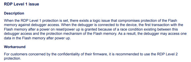

Sure, but the guy in the 32F0 attack did publish it. Actually the first two URLs in my post above are the same paper, from roughly 2017.
How old is the 32F0? In particular the STM32F051R8T6 ? The DS is 2017 but that's just the last revision.
The errata for this chip
https://www.st.com/resource/en/errata_sheet/es0202-stm32f051x4x6x8-device-errata-stmicroelectronics.pdf
under 2.2.2 shows ST addressed the specific race condition referenced in the attack paper. So perhaps that attack - quoted all over the place - is no longer viable. ST fixed it in 2016. Interesting they think L2 remains secure:

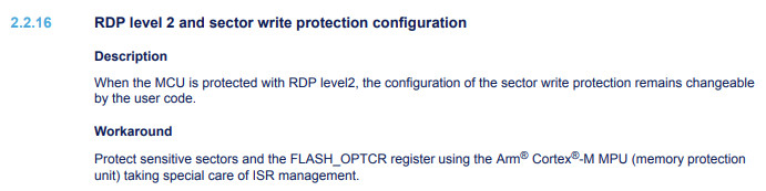

Now for the 32F417VGT6
https://www.st.com/resource/en/errata_sheet/es0182-stm32f405407xx-and-stm32f415417xx-device-errata-stmicroelectronics.pdf
My reading of the above is that L2 is defective in that it can be (in effect) downgraded but only by internal software, which is hardly a problem because if somebody can run own code in there, they can read out the whole device anyway. Is that right?

One interesting bit is that ST document the vulnerability on the F0 and say (in the errata) that they fixed it. But there is no mention on the F4, which may suggest that it doesn't have that particular vulnerability.
Which STM32F3xx did you succeed with and did you read the FLASH or just the RAM? The errata for the 303 does not say anything
https://www.st.com/resource/en/errata_sheet/es0204-stm32f303xbc-device-errata-stmicroelectronics.pdf
