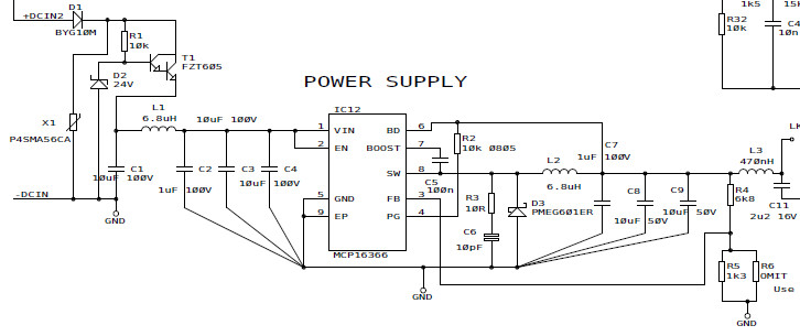

As an update, I found the MCP16366
https://ww1.microchip.com/downloads/aemDocuments/documents/APID/ProductDocuments/DataSheets/MCP16364-5-6-Family-Data-Sheet-DS20006969.pdf
which does 5V 1A and does not do the discontinuous mode which the MCP16362 does and which is undesirable in lots of applications.
Now digging around input filtering
https://www.eevblog.com/forum/projects/instability-due-to-transfer-function-peaking/msg6327816/#msg6327816

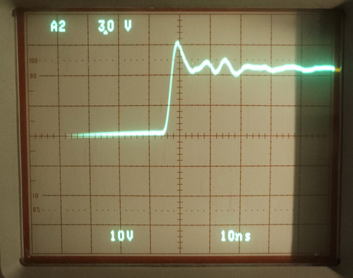

I built the PCB with the MSP16366 and wonder how the hell can one get the (anticipated) radiation down. With a 400Mhz scope, I see a < 5ns risetime to Vin when the mosfet turns on.
It is on a ground plane PCB so the bottom is shielded, and I have a metal case covering the components. So all around metal shielding, but... Rarely one sees something switch this fast!
Not much ringing
The input components are there just for protection from automotive spikes etc.
Currently I have nothing for R3/C6.
I've tried a quick hack to slow down that fast rising edge, with a resistor in series with pin 8. 1R does nothing, 10R does nothing, and 47R makes the switcher go really funny. This is measuring the waveform at the top of the schottky diode. Virtually no difference in the edge.
A zero risetime square wave voltage applied to a perfect inductor produces a current ramp but the inductor will also have a parasitic capacitance which will cause a current spike.
So I will have to live with this and hope the layout and shielding are good enough. It would surprise me if this chip was useless due to this.

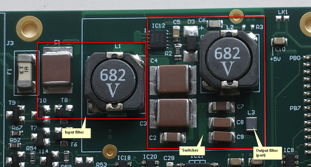

I made it as compact as possible - like the layout in the Microchip DS
and with the metal case it will be shielded on all six sides, but ferrous shielded on only top 4 sides (although the bottom will have a 1.8mm aluminium case behind it).
The D3 oversize pads are from the previous 3A design. This 1A design uses smaller parts, and higher value inductors. Actually I used the same physical size inductors as the 3A design used... lower resistance.
Vref is super accurate - I am getting within 0.1%.
The capacitors etc were as per the DS, even though most were at silly prices.

Any decent switching converter will show steep switching edges - degrading them can only lead to decreased efficiency. Instead of trying series resistors, you could have picked inductors with higher ESR, but the result would be similar: worse efficiency, higher temperature.
The MCP16366 has spread spectrum (which they call "Switching Frequency Dithering"), so that will spread the emissions over a larger bandwidth, lowering peaks for any particular frequency, which is way better for EMI. You can check it out by looking at the switching period on the scope rather than just the rising edge.
I tried inductors too but it does not help.
Yes I can readily see the frequency variation. I just did not post a photo showing that ;)
I think there is a tradeoff between higher switching speeds (and higher efficiency) and more emissions, and lower switching speeds and worse efficiency but less emissions.
There are ways to do it but they involve more components and get well away from the simplicity of these circuits. One can use capacitors to absorb some energy to slow down the edges. I used to do that on HV power supplies and it was done partly to keep the semiconductors inside the SOA region.

What exactly is the problem you're trying to solve? Fast edges on a DCDC switching node are expected in high density or efficient designs.
If layed out well its not a problem. One fun issue to watch out for is inductor inter-winding capacitance that couples that edge to the output directly: you want the highest SRF inductors with minimal capacitance to reduce that.
Yes; that is exactly the problem with fast switching.
I have an extra output filter (L3 in above circuit) which uses a high SRF chip inductor - MLP2520HR47MT0S1 which is somewhere around 100MHz. But those fast edges are still producing high currents in any loop area which will radiate out, regardless of any further output filtering. The main converter inductor is 6.8uH MSS1048-682NLC whose SRF is listed at 35MHz.
It isn't possible to do a layout with a zero loop area :)
It is for these reasons that practically all DC-DC converters (which nowadays tend to run at MHz speeds) needs loads of external filtering to meet any EMC specs.
