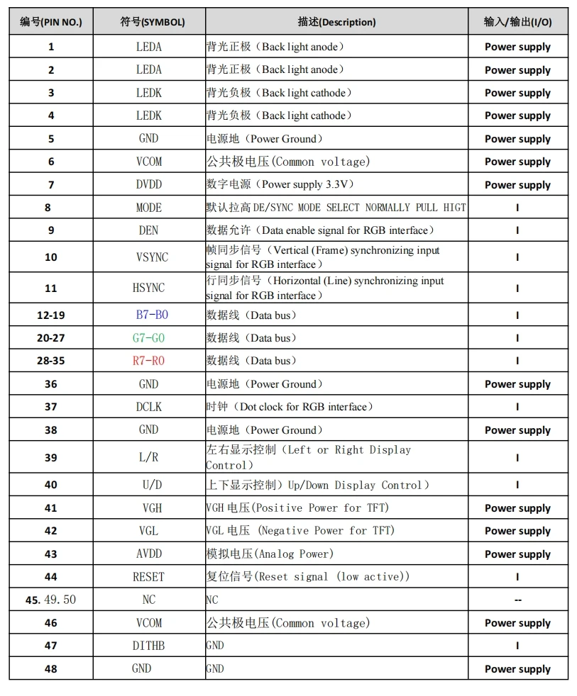

So how will you go about figuring out what the pins/connections are on that screen? As a noob all I can see is a ribbon with no idea where to start.
The datasheet.
BuyDisplay and some vendors do provide the datasheet openly.  For example, take a look at ER-TFT101B4-1, and the linked datasheet.  You can find the pinout on pages 9 and 10.  On page 11, section 4.3 Electrical Characteristics, you can find the expected voltages: VCC = 3.3V±0.3V, VGH = 18.0V±0.4V, VGL = -6V±0.4V, VCOM = 4.2V±0.4V, and AVDD = 9.6V±0.2V.  The next section, 4.4 Backlight Characteristics, tells you that the backlight (separate cable) is best run at max. 180mA – 200mA constant current, at which the forward voltage is around 9 volts; very suitable for use with my favourite backlight boost driver (from 2.7V - 5.5V supply), TI TPS92360.
Sometimes the pinout you get at e.g. this AliExpress 10.1" 1024×600 display when you expand the product description:
(click to embiggen)
can suffice.  Then, the video timings you need to use for the display are usually the standard Coordinated Video Timings, Reduced Blanking (CVT-R); hopefully per CEA-861-I.  There are online calculators for this.  Or, you can test if the ones in similar displays' datasheets work.
Without a datasheet or pinout, I would not bother.  Yes, there are lots of very nice cheap displays at AliExpress without datasheets, especially as replacements for car displays and tablets and even handheld consoles, but it is a LOT of work to reverse-engineer the pinout, and it usually involves the destructive deconstruction of at least one unit, likely more during testing.
