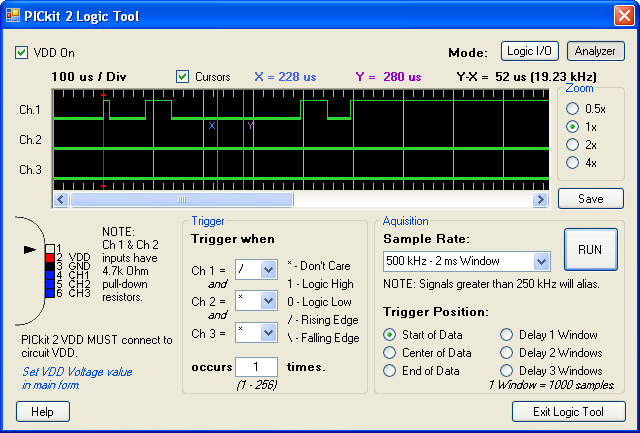

In the PICkit2 program select Tools->Logic Tool...
Set Ch 1 = / to triger on a rising edge
Set the Sample Rate to 500Khz - 2ms Window
Press the run Button
Now press the Reset Button on the Demo Board.
You should capture a nice square wave (That is why I sent a 'U" look up its ASCII Code) with the First pulse slightly stretched, that one is the Start Bit, the rest of the Bit should be identical, or reasonably close seeing as we are only using an RC oscillator.
You can play with it for a while, use the cursors to measure time and frequency etc. Mine shows a Bit length of  52uS  and a Frequency of 9615.28Hz

Switch back to the Logic Tool and press the Reset Button to capture the new waveform. If you still have RealTerm running you should see an 'A' displayed there too. My waveform looks like this:
Now Change the SER_BIT Constant to a 1 and recompile it.
You should capture a waveform like this:

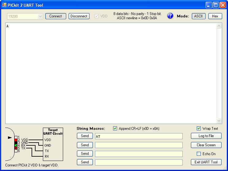

Now switch to the UART Tool, Select 19200 as the speed and click Connect.
Press the Reset button and you should get an 'A' displayed.
You now have a Software UART that can send debug messages to either your PC, with or without a MAX232 or FTDI Chip, or directly to the PICkit2 UART Tool.

In serial communications, just like comedy, timing is everything
RS232, or at least the subset that we are interested in, has no clock. In fact the acronym UART stands for Universal Asynchronous Receiver / Transmitter.  Because it is Asynchronous both sides of the link are expected to maintain accurate timing and conform strictly to the expected bit lengths. Most of the time (pun intended) we can ignore such esoteric issues when working with RS232, as both ends of the link generally have hardware to take care of it for us. In this case, however, we are providing the timing in software and we have to get it right. This issue of timing is not cut and dried either. One would expect that if the timing is wrong no data would be received, and that is generally true for major timing errors, but to make matters worse even a tiny error in timing, just a few uS (Microseconds)  will cause you the most headaches.
Unlike comedy, RS232 timing is no Joke. If the timing is out by only a few uS, 90% or more of your data will be perfect, but you will get an occasional glitch, a corrupt byte, that will show as the wrong character. Not really a problem when you are working with text, which is what Asynchronous Serial Communications and the ASCII character set were originally intended for,  but it is a major problem if the process you are controlling with your software is telling you that the temperature is 230 degrees and you receive it as 12 degrees.
Large portions of the RS232 Standard are dedicated to ways of getting around this. That is why you have things like Parity Bits and the options for hardware and/or software handshaking. The original RS232 Specification calls for a DB25 Connector and most of the pins were used. As hardware became faster and more stable a lot of them were no longer used that often and so the DB9 connector took over. Most of us, however, have only ever been exposed to Rx and Tx lines, a two wire (plus ground) implementation of RS232. That is because modern equipment has become so fast and its timing so accurate, combined with the communications software (anyone here remember Kermit or XModem?) that we use and the relatively short signal paths (RS232 Full Standard can go upto a Kilometer or more) have made most of the RS232 Standard obsolete.
If you have been trying out the code presented here you will probably have received the occasional corrupt character already (I hope it was not so bad that you just gave up, this post is going to provide the reason and the solution).  Infact if you look at the code where the timing is defined you will see:
#define SER_BAUD       50            // TMR1 (1Mhz/19200 baud) = 52
Notice how the comment says it should be 52 and I have used 50,  that is not a typo, that is the result of tweaking the timing to suit my chip.
Lets do a bit of Math, I am running with a 4Mhz system clock and Timer 1 is counting the Instruction Clock, so divide by 4 and we have a 1Mhz Clock feeding a 16Bit timer. We are only using TMR1L, so effectively we are using Timer 1 as an 8 Bit Timer (a waste I know and we will address that later when we fully understand the timing issues)  so we are counting 1uS pulses.
That means that the difference between 50 (which works well with my Chip) and 52 which the calculation says it should be is only 2uS.  Yet it makes the difference between reliable data communications and illegible junk as the screenshots below will show.
That is the result of setting SER_BAUD to 52, if anyone tried my code and got that result I don’t blame them for giving it up as a bad joke.  lets try it with 51:
That is much better, it is the same data as before but with a one Microsecond difference in timing. Notice though that it is not perfect, the second L in the third string has corrupted. Probably good enough for text communications or if we applied an error correcting algorithm, but we want to use this for debug values or reading sensors, so we have to be able to trust our results.
With a value of 50 we are finally getting acceptable results and I have used the the Capture Tab in RealTerm to run samples for well over an Hour with no errors.
So what is happening here?
This is where the Logic Tools on your PICkit2 becomes invaluable, so much so that it is worth buying one even if, like me, you also have a PICkit3 and an ICD. The more timing issues you address,  the more you will appreciate the PICKit2 Logic Tool.
And lets face it if you develop any kind of control software, even just driving a hobby servo, timing can become critical.
When Roman developed his Software he was using an 8Mhz crystal oscillator with a PIC18 device on a MikroElektronica development Kit.
We are trying to debug it on a PIC16 with a 4Mhz RC Clock on a Low Pin Count Demo board, there are bound to be differences in tolerances.
I have found a very useful table that shows the expected timing for RS232 wave-forms at various common BAUD Rates, so lets see how well our implementation compares.
We can make the assumption that our PC with its Quad Core processor running at 2.4 Ghz is at least capable of generating an accurate timing signal, so lets start by measuring a waveform captured from the PC to use as a baseline.
Attach the RS232 Adapter Board  (or FTDI if that is what you are using) to the Tx and Rx pins (RA0 and RA1 - don't  forget the Gnd connection too), then Load up the PICkit2 Logic Tool and set the sample rate to:  500 kHz - 2 ms Window (note that we get a warning about signals greater than 250Khz, but as we are only expecting about a 20Khz signal we have nothing to worry about) then Send a U from RealTerm.
We want to use our cursors to measure the Frame Width (1 start bit, 8 data bits) and a Bit Width.
Zoom in to 2x and place your cursors as accurately as possible to see what you get.
I measured 468uS for the Frame and 52uS for a bit. The table says it should be 468.75uS and 52.08uS.  But we are not going to quibble over nanoSeconds, we could never place the cursors accurately enough.
You should have captured two waveform's, the one on Ch2 is the Frame we received from the PC, the one that follows it on Ch1 is the Frame we sent back. Let’s measure that one too and compare the timing.
I measure 476 uS and 52 uS so our bit width is exact but our frame length is a little large. That is because of the Start Bit which in my case I measure as being 72 uS. Having the Start bit stretched is not normally a problem, infact stretching the start bit can sometimes be desirable as it gives the receiver time to notice it and begin reading the frame, it is the data bits that need the accuracy.
If you look at out code the start bit is is followed by:
   while(i)                  // send 8 serial bits, LSB first
      if(data & 1<<0) TxPin = SER_BIT;   // send data bit
      else          TxPin =!SER_BIT;
That while(i) construct will take a few cycles to execute before we send the first data bit. If we forked out US$500 for the Optimizer we may be able to reduce it, but as it will not really effect our data, why bother.Don’t be tempted to try and save a line of code by using:
while(i--)                  // send 8 serial bits, LSB first
and eliminating the i--; that follows the data send, that will stretch the Start Bit too much and totally ruin your day, I know, I found out the hard way.now lets repeat the measurements with the calculated value of:
#define SER_BAUD       52            // TMR1 (1Mhz/19200 baud) = 52
The waveforms look fine but RealTerm is showing Junk echoed back.  How could that be? If you zoom in to x4 and measure the bit width of all the bits you will notice that they are getting progressively smaller, ranging from 64uS which is way above the 52 uS we expect to 48 uS which is below. Without the ability to take period measurements we could have easily missed that. The result of course raises the question of how the periods can drift when the the timer value is constant.
To find the answer to that we are going to have to look at the timing inside the PIC rather than just the Rx and Tx lines.
I bet you are beginning to realise that porting a Software UART involves a lot more than just copying someone else's  code.
But that will have to wait, my supper is on the table.

Advanced Debugging with the PICkit2 Logic Tools
So far we have only used two if the available inputs on our Logic Analyzer,  in order to get a better look at what is actually happening inside the PIC in relation to the signals we have been reading on the RS232 Port we will press the third Line into service.
On the Small Pin Count Demo Board, that I have been using for this project, the ICSP header has the AUX pin connected to RA4, so I will use that as the Debugging Output. The following is added to our Pin Definitions.
#define dbOut          PORTAbits.RA4   // Debugging Output
Nothing needs to change in our setup routine as we have already declared all unused pins to be outputs by default.
We can use this output for several things, much like we would if we had an LED attached, but because it is going to our Logic Analyzer it allows us to use it the create Trigger signals and timing pulses to help us better analyze our data.
In the previous section we were looking at the Rx pin and the Tx Pin and the timing involved, but that gives us no real idea of the timing inside the PIC. It would help us better understand the inner workings if we could see how the PIC is responding to changes on the RX line and the dbOut pin is perfect for that. We will use it to analyze the receive_serial_byte() function.
Before we do that, however, as a result of our earlier tests we had discovered that our Start Bit was very stretched, I decided to address that issue before moving on to the receive_serial_byte() function as the send_serial_byte() function is arguably the most useful.
Unfortunately that opened up a can of worms that made me seriously rethink the usefulness of XC8 as well as highlighting another major pit fall in Porting C code between vendors, How Good is the Generated Assembler Code.
Roaman developed his code in MicoC, a nice mature compiler with good optimization.
We are porting it to a Free version of XC8, which in addition to not having advanced Optimization enabled in Free mode, it would appear is deliberately crippling the generated code. If that were the case I would consider it to be equivalent to extortion. But searching the MicroChip forums it would appear that it is not so much crippled as not optimized in the slightest. Not even the obvious optimization that you would expect any compiler to do.
The bottom line is that rather than having the MBA's from Marketing fired, Dave's Rant on the PICkit3 got them all transfected out of the Engineering Department and straight into the Software Tools division. I, like many others who had used XC32 - which has good optimization even in free mode,  that XC8 would be  based on GCC and that the same base code would cover both. I could not have been more wrong.
XC8 is based on HTC - Microchip Bought HiTech a couple of years ago. and XC8 Free mode is the crippled HTC that now supports all chip rather than a select few, but with all optimizations removed.
After several hours of playing with execution order and alternative logic forms, all whilst monitoring code size and Timeing waveforms, this is the best I could come up with in terms of hand optimizing the function:
void send_serial_byte(unsigned char data)
unsigned char index = 8; // 8 data bits to send
TMR1L = (256 - SER_BAUD); // load TMR1 value for first baud;
TxPin = !SER_BIT; // make start bit
while(TMR1L > 127); // wait for baud
do // send 8 serial bits, LSB first
if(data & 1<<0)
TxPin = SER_BIT;// send data bit
TMR1L -= SER_BAUD; // load corrected baud value
index--;
data = (data >> 1);          // rotate right to get next bit
while(index);
TxPin = SER_BIT; // make stop bit
TMR1L -= SER_BAUD; // wait for baud
while(TMR1L > 127);
The While Loop becomes a Do loop and the references to  (TMR1L & 7<<1) become (TMR1L > 127), why the last change makes a difference is beyond me, it should be the same thing to the compiler.  References to local variable i become index, a cosmetic change as that is more readable and indicative of its use and finally the Start Bit, the Data Shift Function and the index-- have been moved into the timing loops, after the Timer is reseeded, effectively making them free, as far as execution cycles are concerned, as we are waiting for the timeout at that point.
The Start bit is thus reduced to only 64 uS and the average bit time is now 51.5 uS which should be within the tolerance of most receiving devices.  I still have no answer as to why the bit lengths vary when they are generated in a tight loop but I suspect it is the code generated by the if Statement that is at fault here. Further optimization does not seam possible as, contrary to expectation the statement:
TxPin = (data & 1) ? SER_BIT : !SER_BIT;
Actually generates more code and takes longer to execute. That is one of the reasons I began to suspect that the generated code is deliberately  deoptimized to encourage purchase of the Licensed version. David's MBA's at work again.
TBC....

Set the Logic Analyzer to trigger on the rising edge of Ch 3 (Don't forget to set the others to Don't Care) Run it, send a 'U' and you should get the following result:
it only took 16uS to detect the Start Bit so that is OK.
The line:
   TMR1L =(256 - (SER_BAUD/2));   // load TMR1 value & offset received ~=center of RxBit
should set the PIC to sample each successive bit in the center, this is the critical part of RS232 Timing and what allows us a slight timing difference between each end. By sampling in the center  of the bit we don't care if the bit is slightly stretched or compressed, so we need to be as close to the center as we can be.
In our case we are sampling too late. Rather than adjust the timing  value which being BAUD/2 should be spot on I decided to try the same optimization as I used in the send_serial_byte() function and change the while loop into a do loop:

The result is:
A definite improvement, our first sample is at 26uS  which is within a microsecond of the center of the RxPin and the last sample is at 27us 7 samples later. I doubt we could get it better than that on an RC oscillator.
