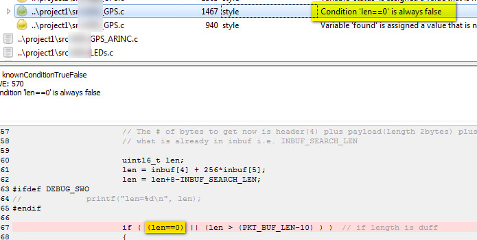

In the meantime I've had more fun with CPPcheck:
while ( (response[idy]!='=') && (idy<50) ) {  ... }
style: Defensive programming: The variable 'idy' is used as an array index before it is checked that is within limits. This can mean that the array might be accessed out of bounds.
It works but would blow up if the array happened to be at the very end of physical RAM :)
But I believe this warning is wrong:
How can they be sure len is not 0. Inbuf could contain any garbage.
And I wonder if anyone has an idea re printsize() further back...
How much is INBUF_SEARCH_LEN?
Online peter-hTopic starter
  • Posts: 5986
Re: GCC v11 32F4: compiler warning depends on optimisation level
« Reply #56 on: November 29, 2024, 07:45:44 am »
It is 7.
So if inbuf[4,5] contain 0xffff, len=0.
Admittedly if len=0xffff then the other condition will also fail :) But that is not the same thing as saying len==0 is always false.
But this isn't worth worrying about because the ==0 check is just good programming, even if some weird analysis decides it cannot happen.
« Last Edit: November 29, 2024, 10:47:38 am by peter-h »
Offline SiliconWizard
  • Posts: 17780
« Reply #57 on: November 29, 2024, 11:09:17 am »
It is 7.
The diagnostic is indeed wrong but it still points (possibly unwillingly) to a potential issue.
I guess (at least for this particular type of diagnostic) CppCheck doesn't consider the modulo (wrap-around) in C arithmetics, or doesn't properly consider the integer width here. In which case, it wouldn't see the possibility of a zero (which would mean the sum has wrapped around).
The potential issue I mentiioned is that checking the values in inbuf (so the value of 'len' *before* adding (8 - INBUF_SEARCH_LEN) ) would be a good idea (input validation) and would avoid a possible wraparound.
So I would check len before the line 'len = len + ...'. You can also check it after the sum if that makes sense for your application. But I would not potentially let the sum wrap around.
Just a question: how is inbuf defined?
If a char array has been used, does cppcheck know that, by default, char is unsigned on gcc for arm?
If cppcheck thinks char to be signed, you'll never be able to obtain 0xFFFFu from the line:
    len = inbuf[4] + 256 * inbuf[5];for semi-obvious reasons.
If inbuf is a uint8_t (or equivalently, explicit unsigned char) array, then the warning is indeed spurious, as you suggest.
Nandemo wa shiranai wa yo, shitteru koto dake.
  • Posts: 5986
« Reply #61 on: December 05, 2024, 03:48:58 pm »
static uint8_t inbuf[PKT_BUF_LEN];
and PKT_BUF_LEN is 2048 bytes.
The following users thanked this post: newbrain
