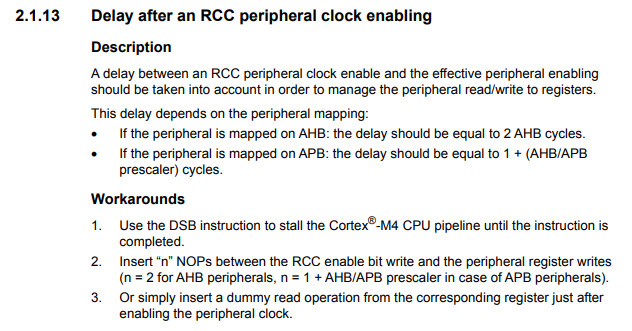

Online peter-h
  • Posts: 5996
Re: STM32: __DSB() vs reading back register
« Reply #7 on: November 01, 2022, 04:24:52 pm »
STM 32F peripherals run off their own clock which is a fraction of the CPU clock, and they seem to be asynchronous so there is synchronisation involved to prevent metastability. The CPU, having written some peripheral register, has no way of knowing what the peripheral is doing internally. This is because the various "arm32" manufacturers have licensed the ARM code as an IP block and they put their own peripherals (which they probably also bought in as IP blocks) around that.

Online peter-h
  • Posts: 5996
« Reply #10 on: November 03, 2022, 09:27:42 am »
What is interesting is that they (screenshot above) do recommend DSB as a solution even for peripherals running at a much slower clock.
This tells us that there is a "back sync" action from the peripheral.
Well, the process of a 180MHz CPU writing to a 40MHz peripheral (could be much slower e.g. 10MHz but look out; e.g. the ethernet stuff breaks, with an undocumented and recently discovered bug if the divisor is above a certain value) is probably implemented with loads of wait states - same as it always was, all the way back to 1975. So DSB will work because the wait states will stretch whatever the instruction (which triggered the wait states) was.
HAL code is good for reference and for getting started. The whole business of Cube MX generating chunks of code is pretty horrible but gets people started much faster than reading the 2000 page RM would. But it becomes clear that much of the HAL code was written by inexperienced programmers. For example look at HAL_SPI_TransmitReceive() and how they cover every possible SPI config option. You would never write real code that way. Occassionally this bloatware bites you on the bum
https://www.eevblog.com/forum/microcontrollers/32f417-what-could-stop-this-memory-spi3-dma-transfer-running/
« Last Edit: November 03, 2022, 09:29:26 am by peter-h »
