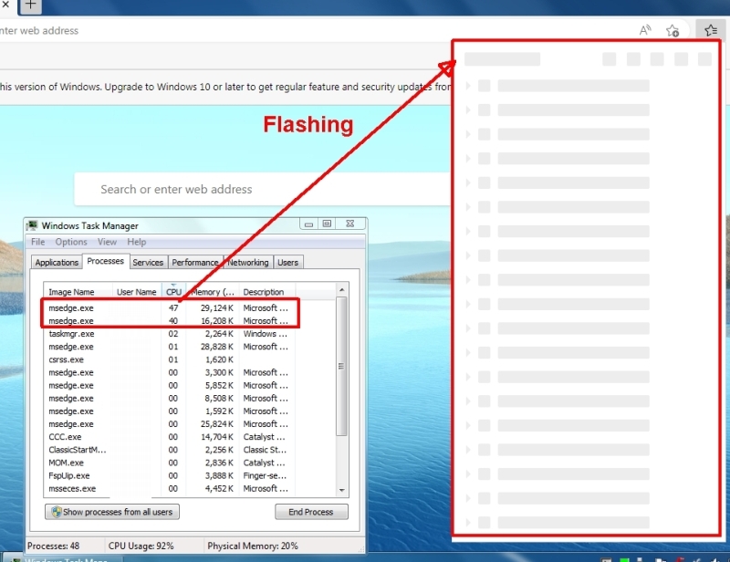

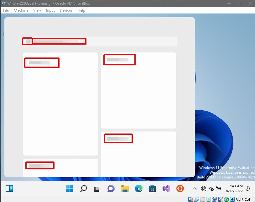

Offline MrMobodies
  • Posts: 2320
I use to use Edge for things back in the early 2020's like for Amazon Prime video. Late that year they did this rubbish in the favourites and history menu so I reverted to a backup until Amazon stop supporting that build and decided to migrate to Vivaldi for that.
I found that one someone's old laptop recently. Edge opened up and I thought I wonder if this is the later build with those stupid things it. So opened task manager, then open favourite's and yes they appeared and caused it to spike to full utilization for about 3 seconds and hardly much things in there.
The same reason why I instantly gave up on LTSC 2021 as an option and upgrade to LTSC 2019 in early 2022
as soon as I saw this crap appear and flash in new widget menu thing on the left for ages and some of the other menus where it'd become a bit unresponsive. I find that DAMN ANNOYING! as well due to the distraction seeing things flash like that especially in my peripheral vision.
If it takes sooo long to load the contents that they decide they need to put something over it goes to show they don't care about the overhead and impact on performance and also shown by how these things that they implemented above causes a massive spike to CPU usage just to display that flashing and for it to then disappear..... the stupidity! that they copied from web pages and form over function approach.
Joke: Looks to me like someone's EGO and their decorations was put to come first ahead of and at the expensive of everything else.
When I see those things they just make me mad with the combination of the annoyance they cause and the stupidity. Something like that should never be needed. If anything why not just delay loading of the contents or hide them until they are all prepared to be shown or better yet let them appear gradually which has to be better than bogging it down even more with stupid animations.
It seems to me that it's heading to the graphical designers as they are copying things off web pages and putting in parts of the operating system.
