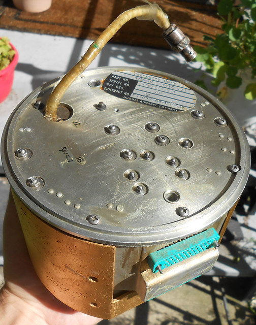

When developing anything that flies, telemetry is important.  If your test vehicle suddenly takes a nosedive into the ground, you'll want an external record of speed, control surface positions & commands, engine status, etc. so there's some hope of figuring out why.  I was lucky to find this Hughes Aircraft telemetry unit from the late 60's: everything in here could be implemented in $20 worth of parts from Digi-Key today, but it's a goldmine of fascinating historical electronics.
The "AIM-4H" referenced on the label seems to be an old missile variant that never left development (scroll up a few lines).  Considering how many different projects Hughes Aircraft was running, though, I'd be surprised if this wasn't a fairly general-purpose unit.  This was also not something that would be used on an "in-service" missile - no need to have it broadcasting unnecessary data and announcing its presence.  So just to forestall some uninformed "you're giving away military secrets!" responses and be clear about the context: this was a prototyping tool from over half a century ago, which any EE student could build now with parts from a Radio Shack if they still existed.  That's not to diminish the amount of work that went into this, though - it's full of cutting-edge miniaturization for the time, like op-amp ICs and switch-mode power supplies.
Looking inside, we can see a variety of different parts:

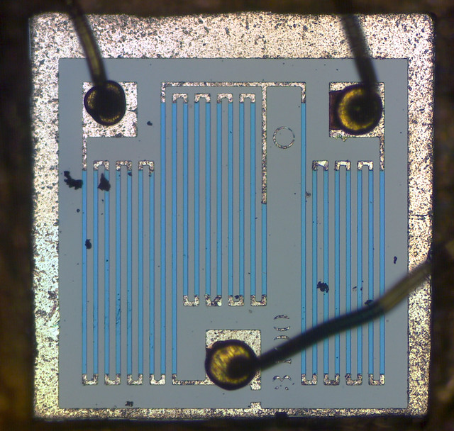

I couldn't find anything matching these part numbers, so I cut open one of each can.
The smaller one contains a simple op-amp:
The larger one contains a hybrid circuit, with an op-amp, 2 JFETs, and a resistor network:
The JFETs & resistor network form a high-input-impedance differential buffer stage which buffers the positive and negative inputs before they reach the op-amp.  By about a decade later you could buy single-chip op-amps with JFET inputs such as the TL08x to achieve these high input impedances, but when this was built these weren't yet available, and so taking a custom-packaged hybrid-module approach made the most sense.
I mapped out a couple of representative op-amp channels - they're all pretty much identical, maybe with different resistor values:
The top one uses the large-metal-can hybrid and larger input resistor values (no bad effects with the JFETs' almost-zero input bias currents).  However, they both perform the same function of: (1) receiving a differential input from the external connectors (a sensor or status output of some kind), (2) applying scaling to it, and (3) doing a differential-to-single-ended conversion to remove any common-mode noise picked up on the wiring.  There's also a positive offset added by R9/R10 & R13/R15: I'm guessing this is to make a bipolar signal fit the positive-only 0-to-VAA input range of the data encoder.

The monolithic opamp is LM101A.
The chip in the hybrid reminds me of this, but it matches neither the published schematic nor the actual circuit exactly.

Anyways, the modulated RF signal next goes to the bottom deck, where the power amplifier lives.  This is the chunkiest piece of brass as it has the most heat to conduct away into the telemetry enclosure.
The white circle is the stud-mount power transistor, a Motorola MM1558, which provides the final amplification stage.  The passives around it seem like pretty straightforward input- and output-matching plus biasing.  The output of this power amplifier goes into the shielded cavities visible here, which have multiple filter stages (probably to clean up the power amp's output and cut out all the harmonics) before exiting to the antenna-coax cable.
Interestingly, this questionably-trustworthy website lists the MM1558's ft as 175 Mhz, which is well below the 230 Mhz output frequency.  I'm not quite sure what to make of this - maybe the data is wrong, or maybe the final frequency multiplication happens at this stage by driving the power transistor hard to produce extra harmonics, and the antenna filters are selecting the appropriate harmonic.  Seems like an inefficient way to do it, but I'm not intimately familiar with the exact devices and tradeoffs available at the time, so who knows.
