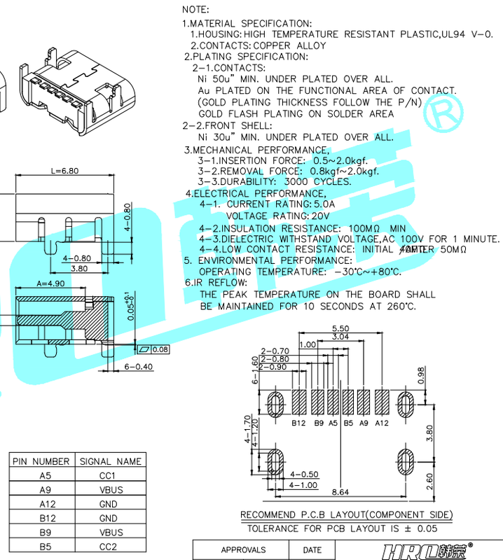

hey all I have a project I am needing to do but I'm unsure as to the best way to go about doing it.
What I am wanting to do is check to see if a tablet or laptop is pluggd into the USB-c cable so that I can have a visual repesentation of confirmation that it is connected correctly.
Most of the tablets I am using do not have any visible feature that showcases that its plugged in or not. But even if it did i would never be able to see it due to the tablets being close together.
This is what my setup I created looks like: enter image description here
When your placing the tablet/laptop into the slots from the front it's difficult to tell if it made it into the connector or missed it.
So my idea was to create a PCB that has 6 female USB-C inputs and 6 female USB-C outputs. But I am not sure what I need to test on the pins to determine if its connected to something or not? I plan on using an arduino to check the voltage and see if it drops XX amount when something is plugged in but again, there may be a better way of checking it?

Offline fchk
  • Posts: 413
Re: Creating a USB-C Passthrough with power charging detection
« Reply #7 on: April 20, 2023, 07:58:11 am »
USB-C has got CC1 and CC2 signals on pins A5 and B5. These pins are used for device detection, plug orientation detection and host/device detection. A host has pullups, a device has pulldowns. Measure the voltage at these pins with an ADC, and you should be able to detect plug-ins and removals.

« Reply #8 on: April 21, 2023, 12:14:56 pm »
fchk
That sounds promising. Would you mind drawing up a quick schematic of this? I'm a visual learner  ;D
