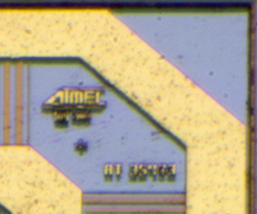

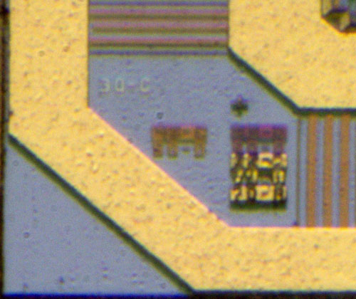

Intersil
In the lower right corner we have the mask revisions. The revision of the metal layer (6B) is moved to the part name. The B at the end of the name is probably the revision of the whole design.
This "mi" thing on the left could be a signature...  :-//

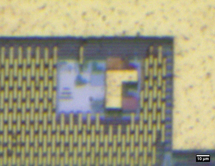

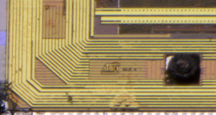

The die is 2,7mm x 1,9mm x 0,15mm. The whole area is covered with a uniform metal structure. On the left side there are four testpads and nine bondpads. In this area the structures are a little thicker. I assume there are protection structures, power supply and the transceiver.
Unfortunately the structures are a little small. It looks like 041, NXP and 2016. But I´m not sure with the last two.
A closer look reveals that the stripes of the metal layer are connected with the lower structures in a regular way. Under the metal layer you can see another layer. It consists of parallel stripes too but they are rotated by 90°.
This is a common protective feature. The uniformly structured metal layer prevents simple optical analysis of the circuit. Since the individual lines are electrically connected to the circuit, it is not possible to remove the metal layer without destroying the circuit. It is possible to create small openings and reconnect the leads around them, but this process is quite complex and time-consuming, especially if you want to contact multiple potentials.

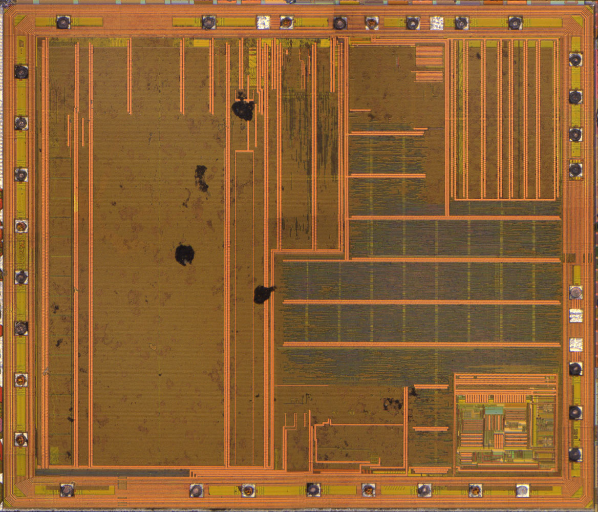

The different structures of the various function blocks quickly give a rough overview of the structure of the SVP. The I/Os extend over all four edges (cyan). At the upper edge there is a small circuit (green), where the device probably generates its clock.
The DSP can clearly be identified because of its different but in itself again regular structures (red). Directly connected to the DSP is a large memory with the typical regular structure (pink). As will be shown, there are two SRAM areas with 256*16Bit of memory each.
In the upper right corner of the die there is a ROM (yellow). It consists of two areas with 1kB each. In this memory there are for example basic instructions. In the upper left corner there is another SRAM with a capacity of 2kB (blue).
In the free area between the large function blocks there are gatearray structures (white). This gatearray contains the logic that connects the individual function blocks with each other, with the external components and the game console. The large area suggests that there are quite some function integrated into the gatearray.
In some areas of the gatearray you can see the standard cell structure interconnected with probably two metal layers.
The area at the top edge probably provides the clock for the SVP. It contains relatively large elements. The circuit is directly and exclusively connected to an external capacitor via two pins. A special clock feed from the game console is not visible. It is quite conceivable that this is an oscillator, via which the SVP generates its own working clock. Perhaps the DSP could even be overclocked by changing the value of the external capacitor or the surrounding components.
The ROM in the upper right corner is considerably smaller than the RAM. That´s because such a mask programmed ROM generally consists of just one Transistor while a SRAM generally needs six transistors.
The structures are very small, but you can estimate the memory size. The structure is similar to the MK37092 mask ROM (https://www.richis-lab.de/ROM02.htm) although here it seems that the line selection takes place at the side and the data is outputed at the lower edge.
Between the two memory blocks several control signals are fed from below (white). From there 4+2 control signals each lead to the left and to the right memory block (red). On the inside of each memory block 64 control signals are generated and a single line is activated (red). Each of the two memory blocks feeds eight data lines (yellow) independently of the other area. 12 control signals (green) allow to select one of 18 columns to each of the data lines. In total, this results in a 2kB memory.

A lot of people use the ATmega328 with a Arduino board. It is a 8Bit-µC with a nice set of IOs and bus interfaces.
The ATmega328P is the "Picopower" variant of the ATmega328 which consumes less power.
The die of the ATmega328P is 2,97mm x 2,95mm. There are 32 bondpads. All of these were connected with a bondwire. The two big frames around the die edges conduct the supply current.
The massive metal plate in the upper area contains memory. Left of this memory and in the lower right corner there are some bigger block, probably analog circuitry and house keeping. In the lower area you can see some logic.
The structures are quite small. But I´m still proud of the performance of my low cost equipment.
Here we have the ATmega328PB, the next generation. While the 328P was just a small improvement to the 328, the 328PB is a completely new µC. It has some more IOs and internal ressources but you can use the 328PB as a drop in replacement (of course it has a different device ID).
Although the ATmega328PB contains quite some more ressources the die is a little smaller: 2,42mm x 2,83mm
There are four unused bondpads. It looks like they are connected to the neighbouring bondpads with thick traces. Perhaps this is a possibility to connect the supply with more bondwires.
Just a small Atmel-Logo.

Offline T3sl4co1l
  • Posts: 22435
    • Seven Transistor Labs
Re: Different die pictures
« Reply #195 on: March 30, 2022, 05:05:15 pm »
That's not combined Flash and SRAM into the same grid is it?  1k EEPROM, 2k SRAM and 32k Flash, let's see, 16 column arrays is the Flash (16-bit words), maybe the shifted area is the boot section (which can be erased separately from the rest depending on fuse settings).  Would the pink (salmon) area be enough for SRAM?  It's not hidden among the random logic stripes, is it?
Interesting that there doesn't appear to be a dedicated core area.  I wonder if they synthesize/layout these fairly flattened and just let it go wherever?
Only analog stuff I think should be: RC timer, EEPROM/Flash erase supply charge pump, ADC, comparator, and I suppose BOD, POR, and maybe the I2C pins have special input thresholds.  And crystal pins of course.  Of which, I suppose the ADC and charge pump likely take the most area, and most of the rest might not even be visible?
Haven't looked at the -PB, that's pretty crazy, is that an IO mux routed around the periphery?  Maybe using an extra metal layer or two?  Sheesh!
The AVR-DA I've been playing with lately, must be even more dense; IO routing isn't so intense, but the "event" system allows routing internal signals in quite diverse ways, between peripherals, and any input pin (but not to any output).  And many more peripherals.  They mention in passing, some kind of internal regulator; they must be using a fine-pitch / low-voltage core for a lot of that internal logic (while interfacing it to 5V IOs).  Crazy!
Tim
Seven Transistor Labs, LLC
Offline NoopyTopic starter
  • Posts: 2400
    • Richis-Lab
« Reply #196 on: March 30, 2022, 06:39:23 pm »
Here you can find a delayered picture: https://www.reddit.com/r/electronics/comments/hrweju/delayered_atmega328p_silicon_die_the_hydrofluoric/
The SRAM is hidden under in the lower left corner of the big memory area.
Yeah, that´s puzzling.  :-//
I agree with you, ADC and charge pump probably consume a lot of the area.  :-+
That´s really fancy stuff!  8)
