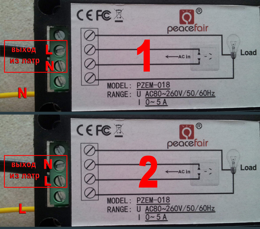

The goal here: to start voltage measurements from 0V. So I could see full range of my variac output.
There might be an easier solution... see the video below.
The video references an image at https://i.postimg.cc/hPwdXhV7/image.jpg -- It takes a long time to load so I attached it below. Here is what is said about the picture in the comments:
:( I forgot to add the diagram to the video: https://i.postimg.cc/hPwdXhV7/image.jpg There are two options for proper connection. If you mix them up, it's not dangerous; only the wattmeter's supply voltage will change depending on the position of the meter's knob.
The Russian text in the pic says "Output from the LATR" -- LATR refers to the autotransformer. If you look carefully you'll see that the black cable carries connections to both screw terminals labelled "AC in". The yellow wire is the one soldered to R15 in the video.
Disclaimer - I have not done this mod. I'm just trying to describe what's going on in the video.
