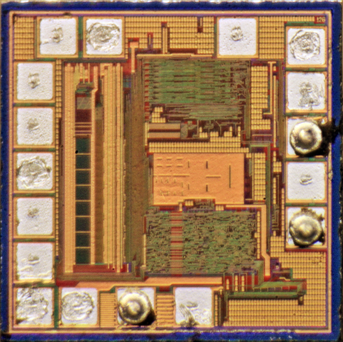

just out of curiosity I did a teardown of a low-cost game console (15€, "Tchibo Retro-Mini-Spielekonsole").
Most parts were no suprise. Unfortunately I wasn´t able to identify the controller.
But one thing really puzzeld me: It seems that there is a kind of security chip on the board. Why the hell would a 15€-console need a security chip?  :-//
Perhaps some experts can give me a hint:
- What kind of controller works in this console?
- What might the unknown chip do?
- What kind of chip might the unkown chip be?

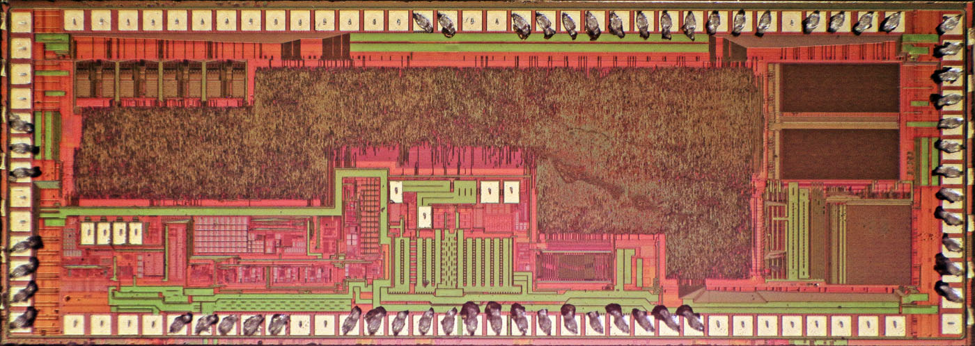

The blob in the middle contains the controller.
The lower SO-8 is the interesting chip. Supply, ground and three "logic lines".
The mystery chip.
Backside of the mystery chip.
So what´s happening here?
After startup the controller fetches 8kB from the flash.
1,3s later the mystery chip is adressed for the first time.
Then there is a lot of data between flash and controller.
Every 95ms (in the menu) or 63ms (in a game) the Controller talks to the mystery chip. Every time only one short "hello".
Clock for the flash is 16MHz. Clock to the mystery chip seems to be 33kHz.
First communication contains "two impulses", all the other communications contain only "one impulse" always at the same location.
Without the chip the game is dead.

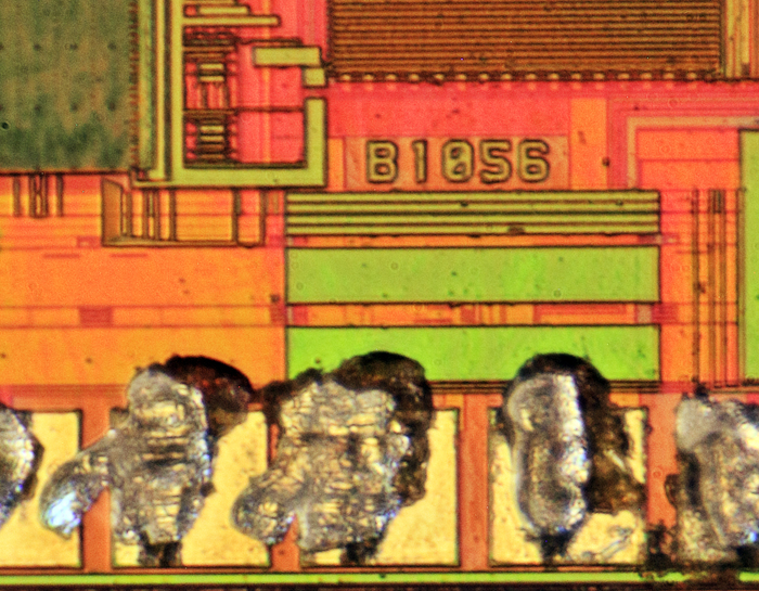

Controller-Die
B1056  :-//

  • Posts: 16394
Re: Game console - security ic ???
« Reply #7 on: December 30, 2019, 09:17:35 pm »
Looks like an EEprom, with that load of glue logic, one monster of an on die capacitor and 8 blocks of what could be flash, and with a pretty beefy set of transistors to generate the erase and program voltages. Probably writing game state regularly as it is limited in RAM, storing the scores between game sessions, or put there as a deliberate way to fail the game when the EEPROM wears out, and get the punters to buy a new one with the new games on it.
Offline NoopyTopic starter

  • Posts: 16394
« Reply #9 on: December 30, 2019, 10:00:41 pm »
It is a custom chip, with all that unused area, and all the unused cells of logic in it, but it is definitely programmable, and there is a lot of EEprom there. Might be doing some decryption key for the main chip to prevent cloners from cloning a cheap game, or just doing some housekeeping, but I do not really know. A key for each section of the game is likely, so the manufacturer protects the IP of their game ( probably "borrowed" from a big player in part or entirely) from being similarly appropriated.

Where do you see the big capacitor which you descriped earlier? The big plate in the middle? I thought that´s only a screen to shield something, perhaps a secret logic block...
