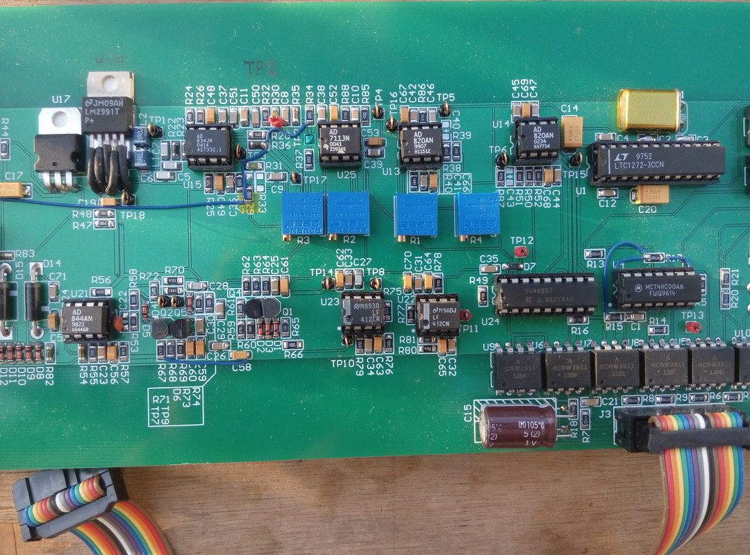

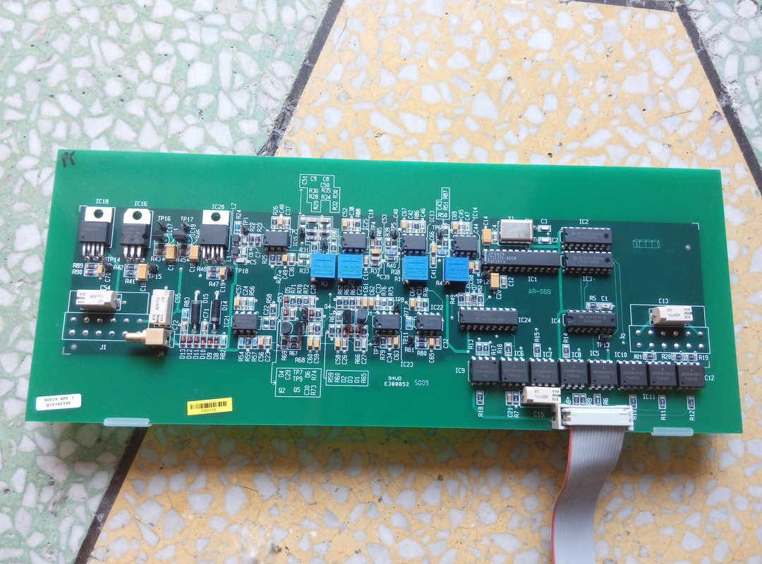

Hallo ,every one。
I copied the following circuit,When I adjust the offset voltage to zero,I will connect TP1 and GND,Adjusting the R3 potentiometer,Let TP2 and TP3 display zero position.After completion。
Adjust R2 so that TP4 also shows zero position.Continue adjusting R1 so that TP5 also shows zero position.Finally, adjust R4 so that TP6 also displays zero position
During the process, I found it difficult to make TP4 display zero position,What I mean is to keep TP4 always showing zero position,Because I wait for a period of time after completing, the zero position after completion will shift again with the extension of time,After TP4 is offset, TP5 and TP6 will also be offset。
I tried many times, but every time it was the same, I don't know where the malfunction occurred,Did I purchase a counterfeit operational amplifier chip.If you know, please let me know. Thank you

I am not going to search for the data sheet for a random IC, U15, to find out what it is.
I am not going to try to reverse engineer your circuit to guess what you want it to do.
However, it looks like you have electrolytic capacitors and ceramic capacitors C8, C50 in your signal path. You should be aware of leakage currents, dielectric absorbtion and non-linear C-vs-V effects.

R37 doesn't exist in the datasheet suggestion for nulling, though I can't intuit how relevant that is.
Also multiple pots to null the same thing is just asking for problems.

Component tolerances at the first (differential) amp will generate offsets beyond the opamp trim range.
Are you operating outside the CM range of the 711?

If you have R2 trimming the DC balance, there's no point in adding R3 nor I suspect R1 or R4. Invest in a good multiturn pot for R2.
Loads of trimpots are never a good thing.
The 6V supply to the 834 output bias resistors must be regulated for stable gain and offset trim.
You might do better to use regulated 5V for Vcc and -5 for Vee.
Squaring circuits of this type have a very "bouncy" response with unscheduled DC making an ugly appearance. See attched with a solution for this.
The Leyden Jars C50 C51, what value are they? Don't use electrolytics here, they leak like hell creating more DC offsets, some MLCCs or film would be better.
Capacitance tolerance of C10, C11 will badly mess up the ac CMRR of your diff amp.
You have to make the diff amp inputs with identical AC and DC characteristics.
The CMRR will be made even less accurate without precision resistors.
I'd separate the lowpass from the squaring output circuitry if you can.
I've got an idea sketched out here that might make life easier. Do the DC bal at the bias resistors and then use the diff amp.
You can also go a step further by taking the difference of currents instead the difference of voltages. Both untested circuits provide 1V fullscale.
That is 1V when there is a 4mA difference in current at the mutiplier outputs.

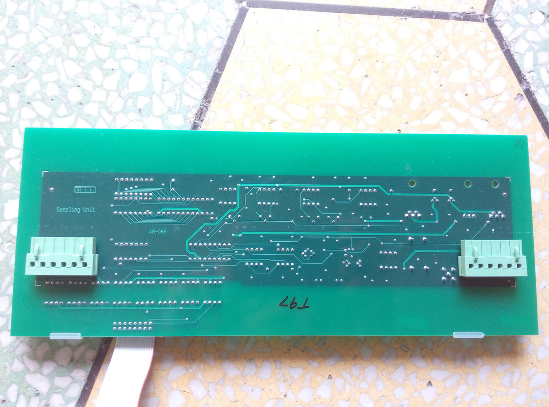

Before measuring the circuit, I will send one physical image and one original factory image respectively.
I copied the circuit 1:1,It seems that the original factory used 4 layers of PCB, while I used 2 layers of PCB for production.
R2, R3, R4, and R1 are all multi turn potentiometers of the same model as before.
I also copied the same circuit for output 834, but I didn't modify it.
C50 and C51 were originally empty and not installed, so I did not install them either.
I also chose the same capacitor for C10 and C11, please see the picture
Clear images here-->https://we.tl/t-WuXzjOnIkn

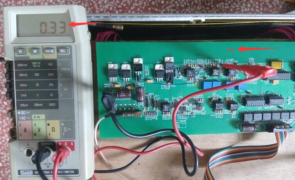

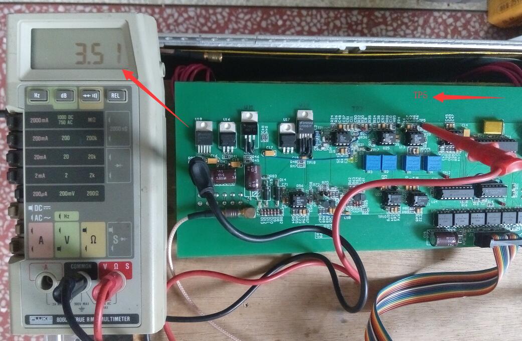

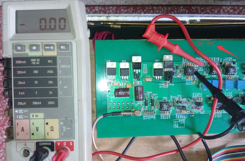

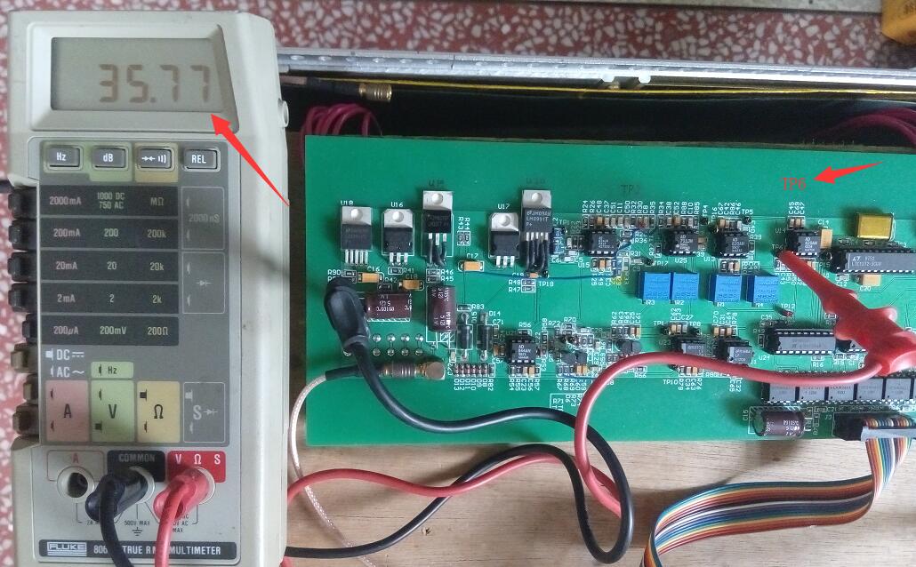

This is my measurement data
TP4 always experiences offset after a period of time,I don't know what caused the change in TP4.

Those trimpots say BOURNS but perhaps they're fake? Drift has been a known problem with the fake (and closely-named) ones. Measure their resistance over time:

Do you do your measurements with input closed (short-circuited)? Because input IC has quite large frequency range and will always gather some signal.
Offline daisizhouTopic starter
  • Posts: 1854
  • Country: cn
Re: Help, offset voltage cannot be reset to zero
« Reply #21 on: September 23, 2023, 07:44:21 am »
Yes, I will connect the TP1 position and GND together.Because the calibration manual clearly states.
I will connect the AD834 input and GND together every calibration
daisizhou#sina.com #=@

« Reply #22 on: September 23, 2023, 10:27:47 pm »
There is no big problem with BOURNS adjustable resistors。
TP2-TP3 has always been stable.
Changes started with TP4,That is AD711JN.
