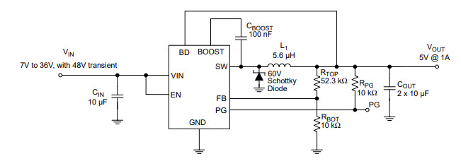

This looks like the best thread of several for this Q.
I am building a 10-35V to 5V 1A PSU using the MCP16366:
https://ww1.microchip.com/downloads/aemDocuments/documents/APID/ProductDocuments/DataSheets/MCP16364-5-6-Family-Data-Sheet-DS20006969.pdf
In front of the above circuit I am putting an LC filter, with 10uF on the input, and 6.8uH driving the above circuit. So we have 10uF on the actual input, then 6.8uH, then another 10uF which is the Cin you see above. Actually I plan to have 20uF there, for Cin.
IOW, a PI filter, of which above Cin is a part.
And I got stuck in to the Middlebrook stability stuff. In simple terms, watching the video which a number of people have posted already, the Zin of the PSU needs to be much higher than the Zout of the filter before it.
But how can this be calculated when Cin participates both in the Zout of the input filter, and Zin of the PSU?
The video gives a simple estimation formula for the Zin but that clearly ignores Cin (it takes in just Vin, efficiency, and power out). Yet every SMPS must have a Cin otherwise the conducted RF would be massive. In fact it would probably just not work at all. The formula it gives for Zout of 10uF and 6.8uH produces a value of Zout which is much much lower than the Zin, so it should be OK.
The circuit given by Microchip above will almost certainly not meet any CE standards, so I am putting in a bit of money into a decent input filter :) I am actually using the spread spectrum version of the chip... and everything will go into a shielded case, on a 4 layer PCB, so shielded on all six sides.
Normally one would put all of Cin on the "source" side.
It's actually somewhat arbitrary where one draws the line between source and load. Though if you put that line in odd places (like between the input filter inductor and the Cin directly on the buck input), then the middlebrook criteria will become overly constraining. Keep in mind the middlebrook criteria is a sufficient but not necessary condition for stability.
I don't see any formula given for Zin in the video, but to be conservative one could assume the DCDC is an ideal constant-power load with infinite bandwidth, in which case you can estimate Zin from just Pin and Vin.

I've done some more digging. Claude also seems to know this well :)
The whole issue appears to be the negative resistance of the PSU input (which is inevitable - that is how switchers work) in conjunction with the Zout of the filter (or whatever is driving the PSU).
The negative resistance of the PSU input is thus nothing to do with Cin (unless Cin is absolutely massive). So Cin needs to be considered as a part of the filter; in the proposed case a PI filter.
The PSU Zin crude formula is Zin ≈ Vin² × η / Pout, where n is the efficiency.
So the above PSU, 5V 1A, min Vin of say 8V, yields Zin=10 ohms. Well, minus 10 ohms but that's irrelevant.
For the filter Zout ≈ √(L/C) = √(6.8µH / 20µF) ≈ 0.58Ω which is way less than 10 ohms...
The Middlebrook criteria are trivially met with a PSU which inputs a reasonably high voltage e.g. 12-24V and generates a low power e.g. 5V 1A. It is much harder if you are inputting say 3V and outputting say 0.9V at 40A. Such a switcher will have a very aggressive negative resistance.
The videos and the printed stuff I've read all fail to explain it in a simple way. Probably because none of them understand it and just copy stuff from each other, to get clickbait. That's certainly what most "tech" websites do.
√(L/C) is the so-called characteristic impedance Z0 of the LC filter. The actual |Zout| can be much higher (depending on the Q of the filter). The damping of the LC filter reduces Q, and therefore reduces the peak |Zout|. When the filter is critically damped, preak |Zout| will be roughly equal to Z0 (depends on the specific damping circuit used).
Right, but how is this practically applied, and is it relevant in the above actual case?
