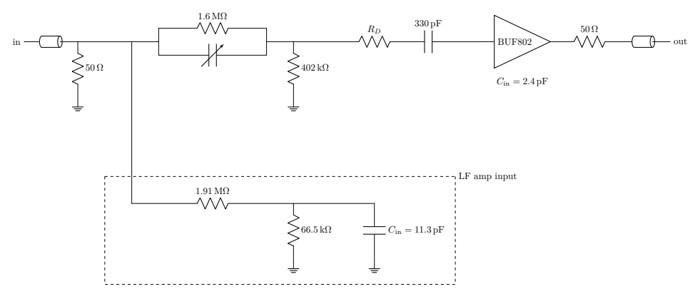

After shelving it for a bit, I've resumed my active probe project using the BUF802 chip. I'm running into a lot of problems trying to tune the input to the BUF802 because of parasitic effects. I made a board that terminates the input and feeds it to the BUF802 with a /5 divider. The minimal stub trace after the termination and shared ground plane should be nearly an ideal tip and ground connection with super low inductance. I packed everything as close as possible with 0402 passives. There's a secondary input path for DC accuracy using an opamp that brings the overall input impedance to roughly 1 MΩ || 1 pF. Here's the overview schematic and testing results of the frequency response:

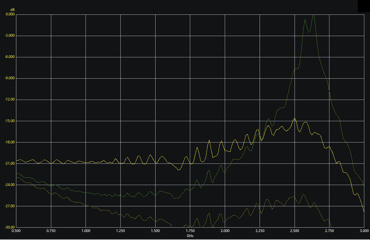

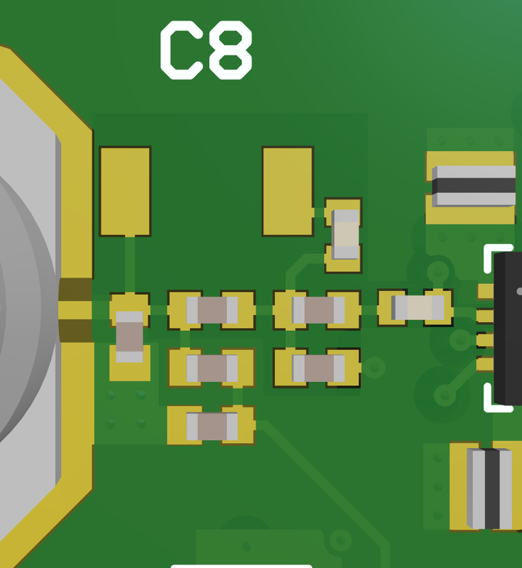

So what I've got so far is the transfer frequency response is the yellow trace. The green trace is moving \(R_D\) between the input termination and divider - even worse. The brown trace is with increasing the value of \(R_D\) in the original position. There's a resonance near 2.5GHz that won't go away even with huge \(R_D\) that tanks the bandwidth. The datasheet for the BUF802 has this to say about S21 peaking: "keeping the trace length minimum is of prime importance to ensure no peaking occurs in the S21 transfer function of the BUF802. The trace inductance can form a resonant circuit with the input capacitance of the BUF802, causing peaking in the S21 response. Add a small resistor in series with the DC blocking capacitor to dampen the LC resonance created by the trace inductance and the input capacitance of the BUF802" ... which I've done my best to follow. With 0402s, the total length from the termination resistor pad to the BUF802 input is about 7mm:
I'm a little stuck:
1) a lot of times I work backwards from lab measurements, try to add parasitics and see if I can get a simulation to look like the bench result. But after adding an L in series with \(R_D\), what else could be the source of the parasitic inductance that's causing the peaking in the frequency response? At 1-3 GHz, this part of the circuit seems electrically small enough not to require transmission line models & EM simulation, but is there something in between LT-SPICE and Sonnet (which I can't afford anyway) I can use to model the physical parts of this layout?
2) what's up with the oscillations (about every 90 MHz) in the frequency response? Is this a reflection (from what, though)?

You have what looks like  a reasonably flat response out to 1.75GHz which is pretty remarkable. The input is quite high impedance, the 1.6M/Trimmer cap/402k, if I was looking for parasitic effects that is where I would look especially the trimmer cap. You could try replacing it with a small, select on test, cap to see how the response varies, just a thought.

Shouldn't Rd be behind the blocking capacitor?
If you can accept a not precise factor gain, why not go pure capacitive divider for the BUF802 path and use resistive trim on the LF path to get that flat with the HF response. Minimum components in the HF path.

The ground plane needs to be removed from the high impedance circuits.

Removing ground plane below the input is something I want to try next - this moderately increases inductance but sharply reduces capacitance on the pads and tracks, yes? I wish there was a way to simulate this easier and more mechanically. I just used a trace impedance calculator to manually add elements for every pad and trace and it started to mimic the tested result, but really litters up the schematic with a ton of trash. When I adjusted the numbers for no ground plane on layer 2, it's much flatter.
I tried a capacitive divider earlier and it didn't work well. The compensated resistive divider is easier to analyze and tame. I also tried bodging a fixed capacitor in place of the trimmer (C8) but the change was pretty minimal.

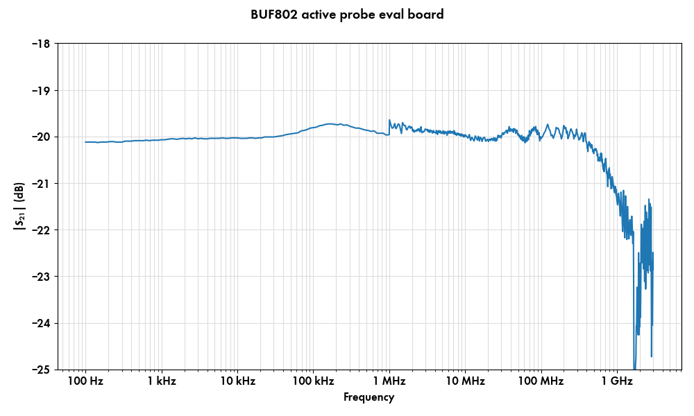

« Reply #8 on: June 28, 2023, 10:31:08 pm »
Removed the ground plane below the input path ... definitely better results! There's a resonance at ~1.7 GHz which could be some residual stray capacitance that could be improved, but this is a good result after so many tries. Frequency response is nice and flat (the jump at 1 MHz is where I switched from oscilloscope to spectrum analyzer).
Next step: remove the termination and input coax coupling and try things in a more pencil-shaped board using pointy tips.

Forgive me if you've already got this but its not on the schematic.  The input to the BUF02 needs some kind of DC path somewhere.  The input Z is 50G, a high number but not infinity.  See Figure 6-25.  Your schematics don't show supply for BUF02 but input bias current depends on CM.  The test circuit shows a 10 meg R going to "in bias".  Without this R,  the input FET's will find their bias based on the leakage current differences between the two input diodes.  Your schematic don't show where these diodes clamps pins go either.  The test circuit shows them reverse biased to Vcc and Vee with 1k R's.  Maybe nothing.
Offline jmwTopic starter
  • Posts: 297
Re: Modeling parasitics in active probe input
« Reply #10 on: June 29, 2023, 03:43:23 pm »
Yeah, I left off some of the plumbing for clarity. They are present, mostly unmodified from the reference designs.
