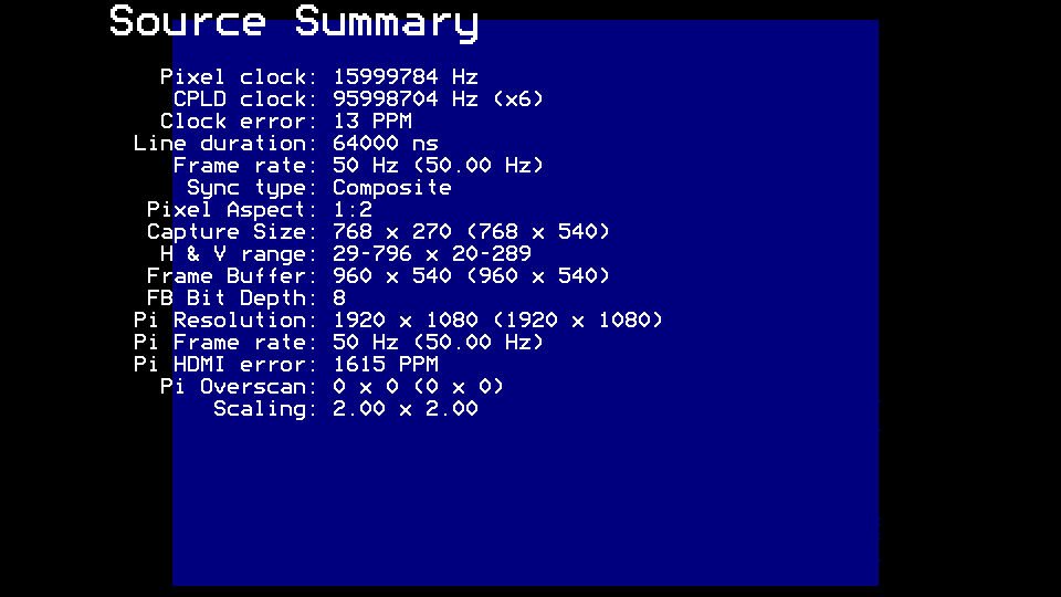

As far as I understand, you need a VGA scaler that allows to crop an zoom at the pixel level a 4:3 image to an LCD display.
Even though I'm not involved in that subject, I know that retro-gaming afficionados have similar predicaments because CRT production has completely stopped.
VGA signal is RGB, and I would say that for TE, you don't need thousand of different colors.
Maybe you can cobble something to convert analog RGB output to digital RGB (most of the case 16 colors, so 4 bits, or 64 colors : 6 bits) and then use an RGB2HDMI scaler to display on a vanilla HDMI LCD panel. Wiki here.
As you can see on this screenshot, H and V pixel span ('H & V range') and H an V zoom factor ('Scaling') can be adjusted, which would allow to resize the 4:3 image on a 16:9 LCD display without distortion.
« Last Edit: November 13, 2024, 09:37:12 am by timeandfrequency »

Hello @timeandfrequency, couple of words:
 - I don't need anything for the moment, @Tantratron need such a thing for his instrument, I try to assist as good as I can.
- The RTD2660 doesn't have just VGA input, it also has analogue component inputs and composite. the best way to use a scaler is to not use it, at lest not for instruments display and fractional scaling, but the challenge is to find something with a similar size and aspect ratio as the old LCD and with a resolution that is close to a multiple of the original one, most fractional scaling sucks for text and lines.
- Scaling a 4:3 to 16:9 without distortion is IMHO a bit misleading, either a (small) piece is cut, or there are bars, or there is some new geometry that I didn't hear off to do this scaling  ;D.
