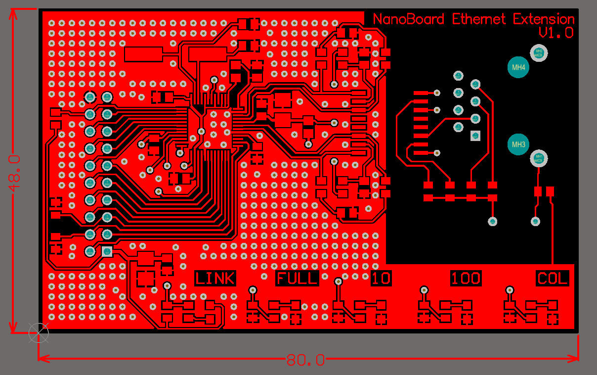

3. Planes and via stiching..
This fragment has loosely placed polygon pours (without vias, like in lower left corner), and I do not believe that underneath there is no ground plane to connect it in several places ;) In other places, they use many vias...
I have also heard different opinions here. Some say that such a plane/pour grounded only in one point becomes a transmitting / receiving antenna itself and you should stitch it wherever possible, like on boards with RF modules (via shielding). Others approach it carelessly and save vias as if every one cost a fortune;)

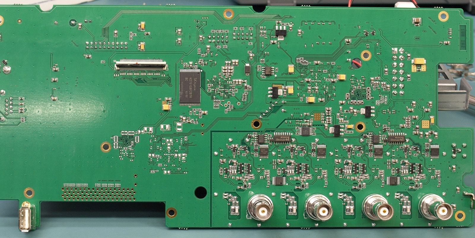

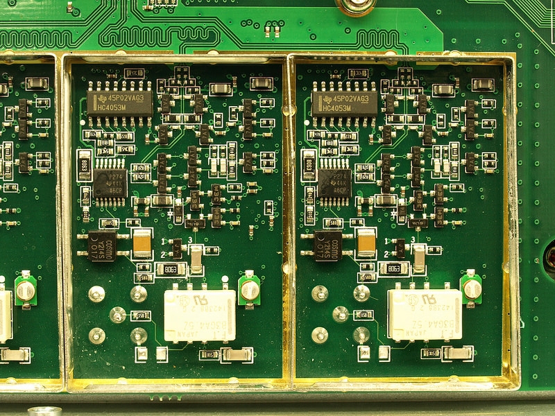

What I find very interesting, there is a magic border... The whole "fast-digital signal area" has no additional ground planes/pours, but it appears below ADC at differential pairs (analog)...
but only above the screening cans. Inside the can, the traces are routed without pours...
However, the other side of the board is all poured
And now be wise here. Does the first side not require ground pours because it is still under the shielding back cover, or is it simply not needed at all?
The additional ground pour does not cost anything, so it was intentionally eliminated. Maybe they didn't want to spoil the traces impedance and increase the capacity on high-speed digital buses.
In turn, there is no metal plate from the front ... visually there are rather slow signals such as switching AC / DC relays on inputs, UART, power supply, etc.

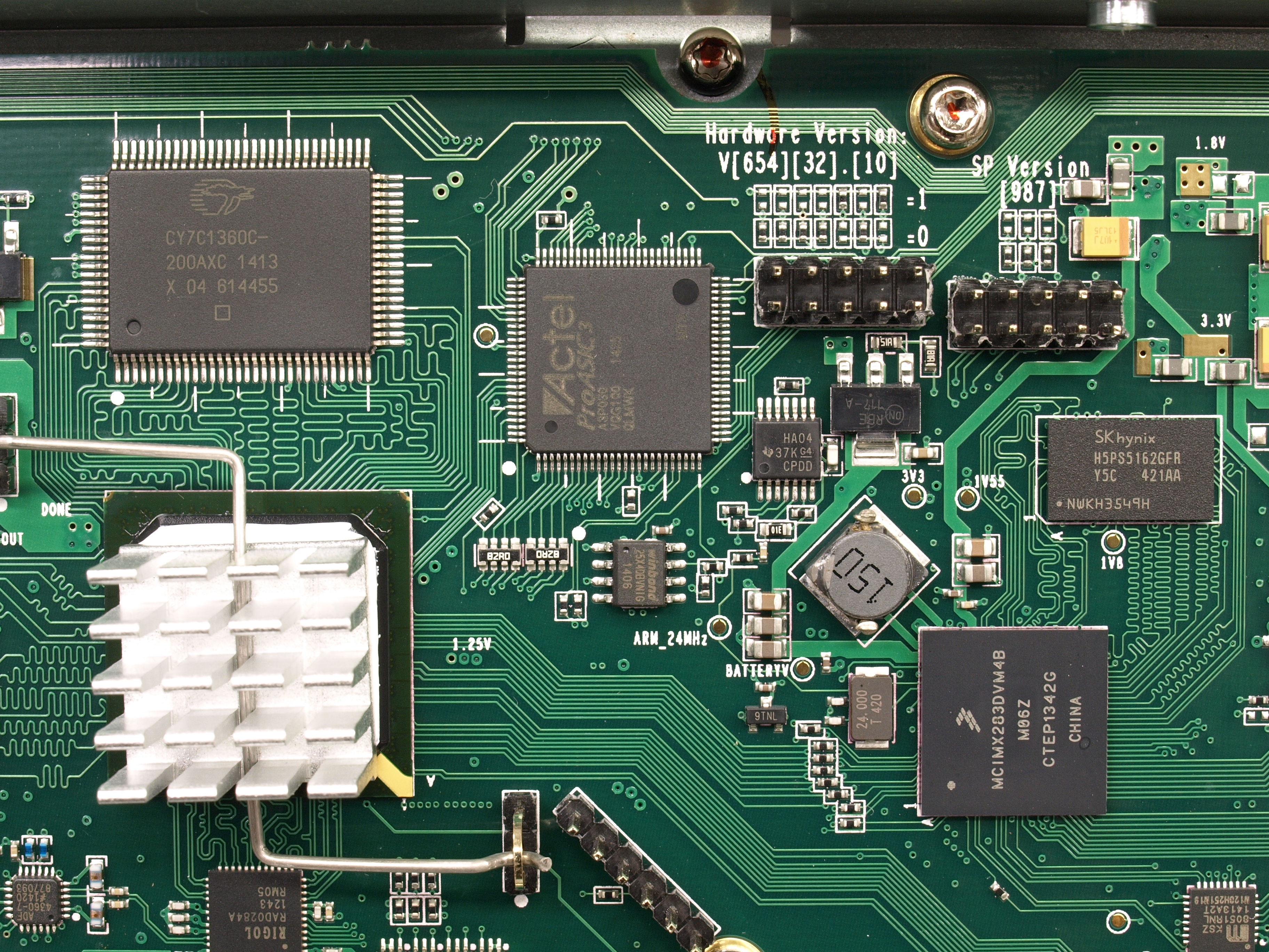

2. Does in the multilayer circuit, where we have power and ground planes inside, pouring the signal layers makes sense?
For example, part of a Rigol DS1054Z pcb doesn't have polygon pours on signal layer...
https://obrazki.elektroda.pl/8796583200_1540851781.jpg
... but another part does ;)
https://obrazki.elektroda.pl/7228270900_1540851827.jpeg
In what aspect adding ground planes (pours) in multilayer pcb will help? Because I know that it can spoil, for example, the impedance of trace when it is too close. Or increase the trace capacity. It seems to me that for these reasons, the ground polygon pours on the signal layer was abandoned in selected parts on the Rigol pcb.
Here is the question for antenna specialists ;) Does a trace above the ground plane form an antenna? Or this plane shields the trace and "spoil" the antenna?
I rarely pour outside layers, partly because I'm almost never working on designs like this, and it's an awful hassle to place components AND vias AND copper on four (or more) layers and resolve connectivity (and good grounding, and good thermal connection if the motivation is more for thermal conductivity rather than EMC performance).
What does it do?  More metal.
Consider one trace over a ground plane.  It's surrounded by metal on almost an entire half-sphere.  That's good shielding already, so the coupling to free space is small.  Yes, you can still make an antenna this way, but the low coupling dictates equally low bandwidth: you have to make a resonator to drive up coupling at one particular frequency.  And then your efficiency sucks because of board losses.
Consider one trace over, and within, a ground plane (i.e., surrounded with ground on the same layer: coplanar waveguide).  It's surrounded by ground on slightly more than a half-sphere, so the shielding is even better.
That's basically all you get.
The change in trace impedance, and increase in capacitance, are just derived aspects of the general case: a reduced trace impedance for a given width.  This can be advantageous as you can use a slightly narrower trace for the same impedance (assuming it can still be fabricated with good yield), and you have ground traces shielding between the signal traces.  The total width probably increases (for a given bus of traces, at the minimum design rules, you've doubled the number of conductors because every other one is ground), but when you need that isolation, it's more effective than simply putting distance between microstrip traces.
So, it seems likely what Rigol was doing, was getting that extra bit of shielding, where they could, basically for free -- no parts cost, no shield cover, just PCB fab -- and where it was easiest to do so, i.e., where nearly no components are present.  Whereas, under the RF shields, there is a ton of components, and even trying to pour ground between them would be a waste of time!
Personally, I stitch at no more than ~2cm between vias, near circuitry.  (Far from circuitry, I don't really care, and I'll sprinkle a few in, particularly at corners and long stretches.)  That's probably overkill for most, but would be marginal for power switching, higher speed (say 74LVC family and up) logic and RF.
Via density is proportional to upper cutoff frequency times desired attenuation.  You might need a dense, multi-row via fence to ensure adequate isolation between traces in an RF mux (>100dB isolation), but digital logic isn't going to give a shit if you route microstrip together (trace separation ~= height above ground plane giving maybe 5% coupling, not even enough to screw up a logic threshold -- assuming it's not a timing-critical clock trace or something, mind).

Not by any means an expert, but I think the general idea for the scope you're looking at is: flood fill around the analog parts for improved shielding, none near the higher speed digital stuff because there the parasitics could actually degrade signal quality slightly (all that copper capacitvely couples to the signal lines).  You can see that they never leave the ground planes floating, cause that can cause reradiation issues, and the via stitching is more dense when close to analog sections, especially when operating at low levels (before input amps).  Given that the planes and via stitching are pretty low impedance, they are unlikely to be significant reradiators when grounded, but if you don't have many vias or the ground path is long (higher inductance and resistance), then you could get a high enough impedance of that 'stub' of a ground plane to act as an antenna at high frequencies.  These extra ground planes can also add a bit of capacitance to your power rails, which can be useful in reducing noise, but since they add capacitance in the same way to signal lines, the extra attenuation is probably not desirable on the low level front end path.  As for using the bottom and not the top, it could just be that the power plane is closer to the bottom of the stack, so to get the decoupling benefits it was better to put there - or maybe they just didn't have too much on the back layer so a fill could have fewer interruptions and be somewhat more effective as a direct low impedance path.
As for crosshatching, it's sort of gone out of style.  It doesn't really do as good a job of shielding as a solid plane and doesn't offer the extra current carrying capacity for a really low impedance ground... but there are some potential peripheral benefits.  It's physically lighter, when using a design where that matters, especially with thicker copper layers (maybe if you're very concerned with the amount of copper used?), and it has lower thermal mass, so it's easy to solder on pads directly connected (but thermal relieves do a fine job on regular flood filled planes).  Since it doesn't have the same physical surface area, you don't get the capacitance benefits, so it sort of falls into a category where it has small benefits, but not as many as a flood fill... so most cases you'd consider it, a flood fill offers the same plus some extra, and otherwise it doesn't perform like an area left empty.
I think a lot of the design you see is just a result of good practice rules and whatever the layout designer's experience has told them would likely work.  I think you could probably design the same board with very different fill areas or crosshatching and still get pretty similar performance, but if the cost is going to be the same and there are potential benefits of using a ground plane as added decoupling or shielding of sensitive areas, why not?  When looking at the pours, it's probably worth considering where the breaks in the pour are - you can see that the analog frontends have 'their own' area of the ground plane - it still looks continuous, but the path has been directed away from, presumably, some of the higher speed digital sections.

Ok, so if I get it right, polygon pours on signal layers have more to do with supressing crosstalks than with shielding outside world.
Here I am not so sure. For me it looks like plenty of space. With CAD soft available nowadays you only draw the outline and software does the magic. Add some vias to ground plane and voila, you are ready.
I think under the cans there is plenty of things to avoid for high bandwidth small signals. Any polygon pour influence could ruin your design performance and it seems to be easier to avoid pours at all than keeping them in spec. Differential tracks outside the cans are already low-impedance outputs of front-end op-amps so can handle additional capacity easier. And grounded polygon pour supress crosstalks between channels here, I think.
If it is 4 layer board you may be right. TOP layer high-speed tracks are over ground plane for controlled impedance so power plane is deeper in stack, which means closer to BOTTOM.
BTW. I wonder where front panel USB differential signals disappeared ;) On top side only power and ESD protection can be seen, on bottom side there is only USB connector and ground plane. Are they routed on power plane? Interesting.
