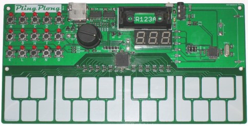

Usually my designs looks a bit nicer like this:
or
