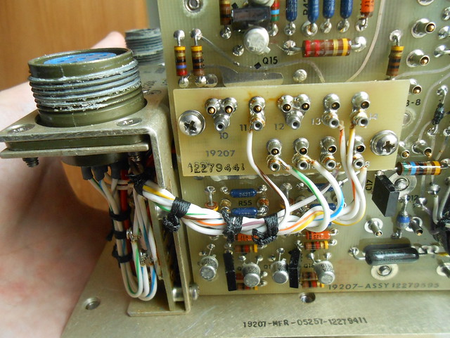

Here's an interesting item where I got lucky (thanks to a permissive seller) with an extra-low offer on eBay.  This is a fire control computer from an M1 Abrams tank, designed to do complex ballistics calculations for hitting a target that take many environmental factors into account.  The particular unit I have was built in 1984, but the official National Stock Number (https://www.wbparts.com/rfq/1220-01-076-6745.html) dates from 1979, so this was likely designed at some point in the late 70's.  The manufacturer is Computing Devices Corp. in Canada, which is now part of General Dynamics.
My photos aren't great, and it's hard to convey just how heavily-built the enclosure is: the whole package is about 30 lbs (14 kg) - I'll discuss one possible reason for that later.  Let's look at the cards inside.
...and the set of very nicely twisted wires that run between the connectors and the backplane:

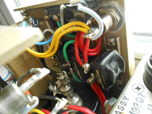

Power Supply
This takes in 28VDC and produces a regulated +5V, plus an unregulated pair of bipolar analog supplies (roughly ±19V) for the circuitry we've already looked at.
Physical layout
Here's what the power supply looks like with the cover removed:
I like the 3D-style construction, with 3(!) separate boards with wires running between them, and some magnetics and a bulk capacitor placed in between the two metal heatsink plates:
Overview
Electrically, the power supply is arranged as a buck converter, followed by a self-oscillating push-pull converter which drives a transformer to produce the (isolated) multiple output voltages.  Here's a schematic:
The 3 boards are split up logically as...
The buck converter:
The black box sitting on the "floor" between the two boards in one of the photos above is the buck inductor.  The buck diode is one of the stud-mount diodes mounted to this side's heatsink plate, and the buck power transistor is a TO-3 package mounted to the heatsink plate too with its leads sticking through the board.
The push-pull converter:
The large metal box hanging in the air between the two boards is the transformer driven by the push-pull converter (T3).  The output terminals that feed the +5V and ±19V outputs are on the top and have wires attached, while all the other terminals are pins that poke through sockets in the board as seen above.
The output diodes are stud-mount devices that can be seen mounted on the heatsink plates in earlier photos, and the two power transistors are (like with the buck converter) TO-3 packages mounted to the heatsink plate.  Next to the power transistors on the heatsink, not visible here, is the power resistor in series with T2's primary, and the thermal switch that gates the buck converter's control power.
The output capacitors and crowbar SCRs:
The metal box directly underneath the input connector, at the bottom of this photo, is the input EMI filter.
