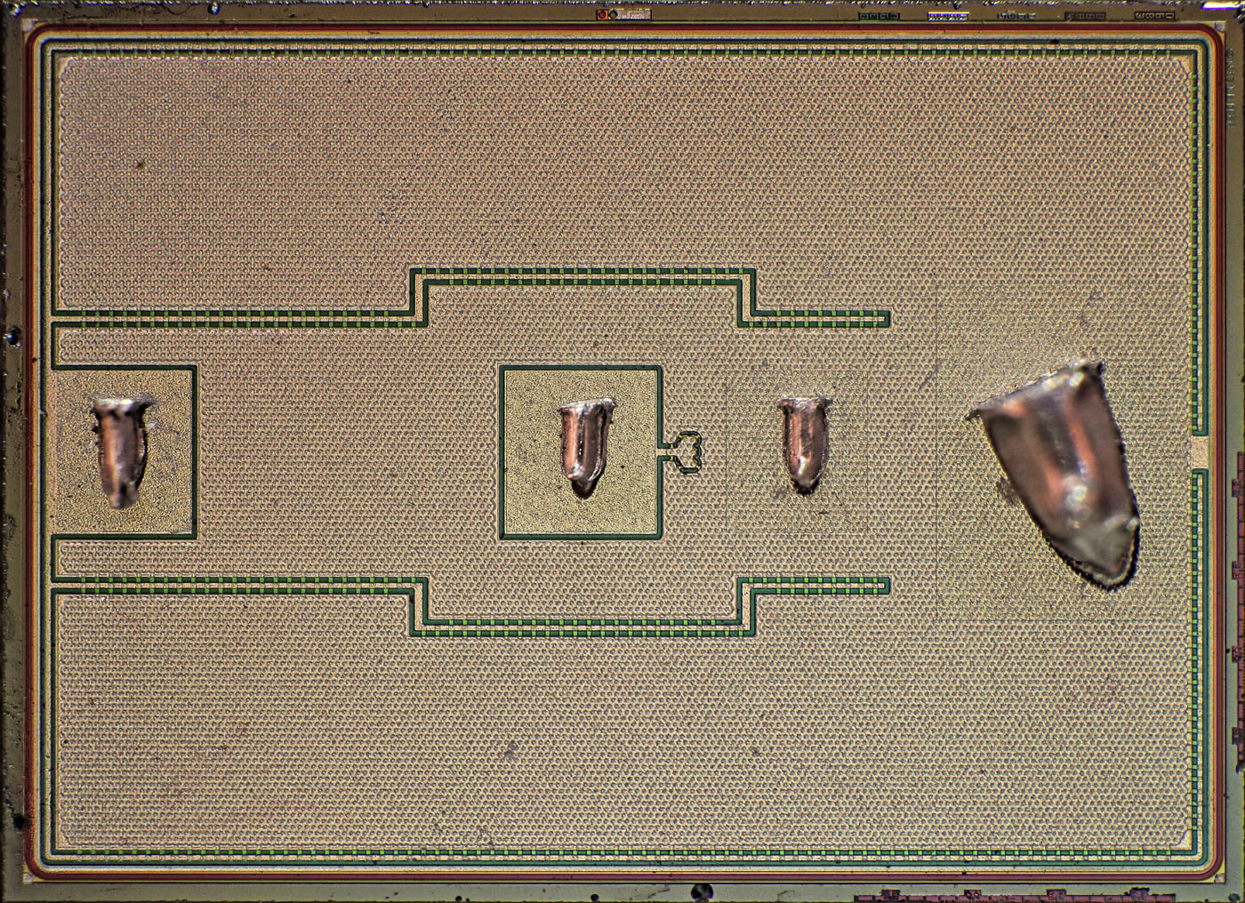

The package contains a die with an edge length of 4,6mm x 3,3mm.
As usual with a MOSFET, the large metal surface represents the source potential. The gate potential is contacted on the left and gets distributed into the surface of the transistor via a surrounding frame and two stubs. The source contact for current measurement is located in the centre of the die. To the right, the Kelvin contact allows an unloaded contacting of the source potential. The International Rectifier Application Note 959B emphasises that it is important for good current measurement that the Kelvin contact is placed close to the bondpad for current measurement.

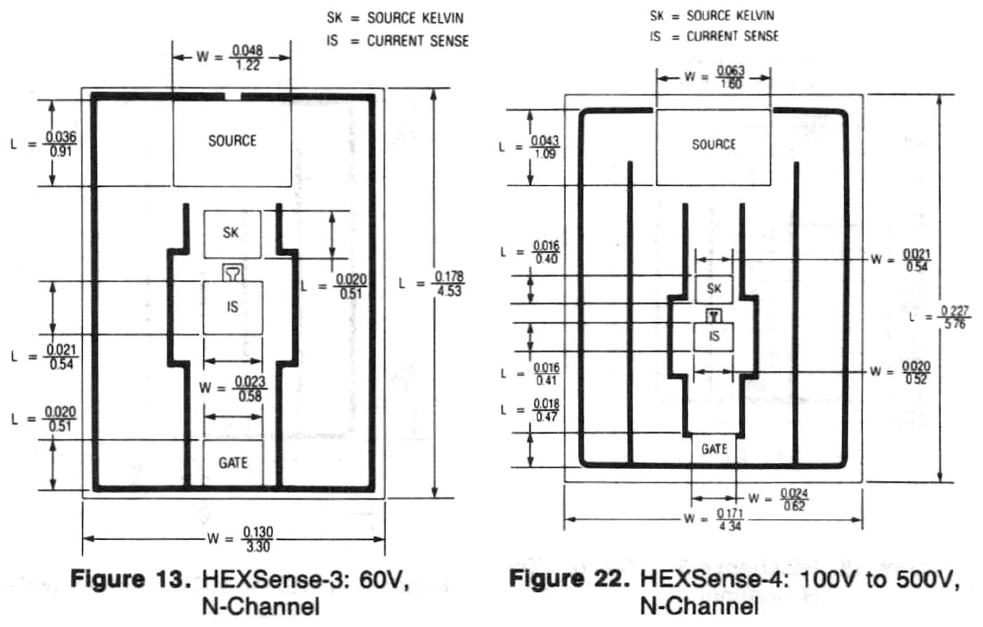

Here it becomes clear that these are counterfeit parts. The International Rectifier Application Note 964D shows how the different HEXFET generations are constructed. Both the dimensions and the structures correspond to those of a HEXSense-3 MOSFET with a reverse voltage of 60V. It was therefore originally an IRCZ34. The IRC540, a HEXSense-4 MOSFET with a dielectric strength of 100V, would have a significantly different structure and the die would be 1mm longer in both width and length.
The IRCZ34 shows typically a slightly lower impedance than the IRC540 (50mΩ / 77mΩ) and allows a slightly higher current flow (30A / 28A). However, with 60V the dielectric strength of the IRCZ34 is significantly lower than the 100V of the IRC540. In an application designed for the IRC540, the forgery would fail quickly.
The typical hexagonal structures of HEXFETs were already recognisable in the overview. The International Rectifier HEXFET Databook shows how the structures are organised in detail.
As is usual with MOSFETs from International Rectifier, some masks are shown on the upper edge. On the right is the copyright and a reference to the year 1987.
The contacts of the individual MOSFETs can be seen through the metal layer. The distance from centre to centre is approximately 24µm. The gate potential, which surrounds the contacts and thus controls the current flow, is fed in at the side.
The International Rectifier Application Note 966A contains a detailed picture of the structures of the third HEXFET generation. Compared to the previous design, the structures have become slightly smaller.

It is noticeable that the gate potential is not simply conducted into the active area with the lowest possible impedance. In contrast to the right edge, at the left edge there are no connections at all to the metal layer with the gate potential. Where the gate line describes a step, the gate potential has also only been connected to the active area at selected points. The steps were apparently created due to the current sense bondpad, under which there are no active structures.
The source potential is connected to the frame at the right edge. There is probably some potential control there in order to optimise the electric field distribution.
The source contact for current measurement contacts only 12 cells. Here, too, you can see that the gate electrodes have been carefully contacted. The gate area has been broken up and only partial contacts have been integrated between the two areas.
The datasheet describes a current ratio of 1:1.410 for the two transistors of the IRCZ34, whereby the manufacturing tolerance alone is already +/-70. Added to this are the fluctuations in drain current, temperature and gate-source voltage. If we calculate with the ratio 1:1.410 and assume that the current distribution corresponds exactly to the distribution of the individual transistors, the load transistor should be constructed with 16.920 transistors. In fact, there are 18.145 transistors, which is slightly more than you would expect. The current is probably not distributed ideally and the slightly different ratio compensates for this.
A test structure is shown at the top edge, which allows the alignment of the masks to be checked against each other.

« Reply #804 on: March 30, 2024, 10:23:04 am »
Even after seeing many examples, it still amazes me that it is possible to bond the heavy source lead without destroying the fine underlying structure.
Creating reliable bondwire connections is real magic.  :-+
And if you think of the speed and the yield they achieve today it´s just insane.
