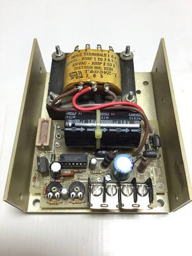

I must be old.  I find I much prefer old school linear power supplies, in all their hot, inefficient, low ripple gloriousness.
Linear power supplies are mostly obsolete in modern equipment.  So where do you obtain extra linear supplies for your new electronic projects?  Do you have a stockpile?  Or maybe you don't build much, thus your availability of linear power supplies will last you for a while?
FWIW, my go to supply are 19V laptop power bricks.
oh contraire
linear are still up to the game,  smps, phase controlled or other technologies are good too,  depends of your needs,
some do not handle  capacitive or inductive loads and can or could blow up,  even a cheap short circuit can play some trick, or overloads (response times)

Be careful with linear supplies, if the pass transistor(s) fail you end up letting the smoke out of your project. Switch mode supplies are generally "fail safe" but for expensive equipment I still use an over Voltage protection board using an LTC-4368 and a power MOSFET, details attached for those interested.
I have a few surplus switching supplies that have originally been phone chargers (pre the USB-C days) and some 12V and 15V laptop supplies with barrel connectors that are easy to change.
