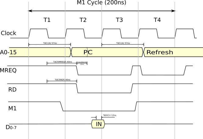

Sadly one of these wish list items falls pretty much at the first hurdle - no wait states in a 20MHz is probably impossible, at least with banked memory. The problem is that the timing for the 20MHz part sucks a bit.
As usual we start with the M1 cycle which has the tightest timing - here it is  with some of the "worst case" timings for the 20MHz part filled in.
For reference the data sheet with the full timing diagram is here on Mouser See page 20 for the diagram and 31 for the timings.
The Z80 samples the databus with the rising edge of the clock at the start of T3 and needs 12ns data set-up time. The start of the read cycle would normally be based on the falling edge of MREQ - that is referenced to the falling edge of the clock in T1 but the data sheet says it could be up to 40ns after the clock edge - which is 15ns into T2. Thus we have 50-(15+12) or just 23ns to complete the read cycle.
OK, so fast, half meg RAMs can be had without difficulty, although I was trying to avoid SMD package adapters (I can't find a 36 pin one anyway). However it's not that easy.
First off I can't find a E/EE/P or FLASH ROM which I can program and which has a 5V supply which also has an access time of less than 45ns. Yes I could get around that by building a ROM-less system and have something else load up the RAM with boot code but I wanted to avoid that.
Second, any gate delays associated with MREQ or the address lines are going to eat into 23ns pretty quickly. In fact it's worse if you look at the official figure for the address set-up time (TdA(MREQf) - address valid to MREQ fall) it is given as -15ns! so the address bus might not even have stabilised by the time MREQ falls - that would reduce the time available for the access cycle to 8ns!
Sadly I decided to just add a wait state to the M1 cycle, that will stretch the needed access time so I can use much more friendly 55ns SRAM and 45ns flash. Just slowing the M1 will have a fairly minimal impact on performance and, to be honest, extracting the last MHz of performance from a Z80 system is a bit like wanting to be the world's tallest dwarf.

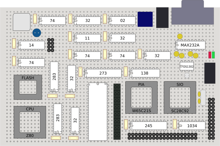

After some thought this is the current state of the design:
I've previously built systems using two 74F189 TTL RAM chips to make a fairly flexible mapping based on 4k pages which will allow access to 1M of RAM. Sadly the 74F189 is no longer available new.
So I have used a different scheme here. Using two 74283 4-bit full adders to make an 8-but adder the upper part of the address bus is formed by adding a fixed base address (specified by writing the base to a latch) to the top three bits of the address bus. In this way the 64 address range of the Z80 can be used as a window into a larger address space. In this case I am going to make it 512K.
The top 8k page is forced to the top of physical memory to provide a common page - this is exactly how CP/M 3 wants to set up banked memory.
Using a 512K RAM gives 504K or 9 banks of 56K exactly which is a nice fit.
32K of ROM space is provided - this is mapped into the low 32k of memory when the ROMEN signal is active.
On reset the ROM is enabled and the bank base address set to 0, the boot code can then copy code up to the top of RAM and then jump there which can disable the ROM.
Memory timing is still dodgy. If I use 74F283 adders the propagation delay for each is about 5ns, plus 6ns for a 74F32 OR gate making 16ns in total for the address manipulation. If the address really is not stable by the time MREQ goes active an extra 16ns delay with a 55ns RAM is too tight (58-16 = 42ns, oops). Ideally one would design to worst case not typical (or even best case) timings but I think I should be OK. In fact I will probably be OK with 74ACT parts which are only very slightly slower than 74F so I'm going to go for those first as 74F is a bit power hungry (up to 55mA per chip for the adder).
I still have to do the serial and CF card interface. The "easy" cop out of using the Z80 peripheral chips is actually not available as they do not (as far as I can see) exist in 20MHz speed. Also common UART chips like the 16550 are actually a bit slow on their data access times for a 20MHz Z80, even given that the IORQ cycle is slowed with a CPU generated WAIT state.
More when I have finished the I/O design.

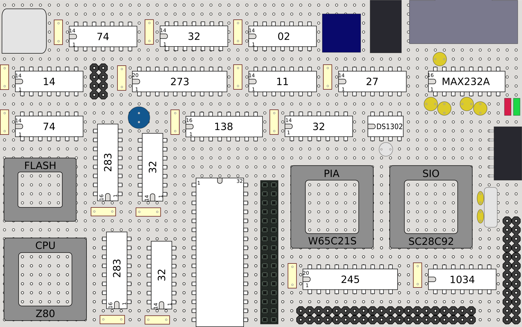

OK, continuing the design for my Z80 SBC I have found time to decide on and draw out the I/O schematic, plus a couple of tweaks to the port decoding (see diagrams in 1st post)
Why no Z80 peripheral chips? I hear you ask (OK, maybe I don't) - basically because there were never 20MHz parts, I suspect that the more highly integrated chips overtook the faster CMOS CPUs. Maybe the 10MHz ones would overclock but I'm trying to stick approximately to device specs.
I wasn't originally going to bother with a PIA but it quickly became obvious that a 44-pin PLCC package would cost less board area than the latches and buffers necessary to talk to the RTC chip so it went in - in which case I might as well bring the unused lines to a connector. Ditto the spare general purpose lines that the SIO provides.
At some point I might try to design a VDU board for it so I've brought enough lines for I/O port expansion onto a header.
Everything looks like it will fit:
"All" I need do now is order the parts I don't have - most of the TTL will need to be ACT (or maybe ABT) to keep propagation delays down and sit down and put it all together.
« Last Edit: March 28, 2017, 09:26:42 pm by grumpydoc »

I wonder if you can use some 5V CPLD in socketed PLCC package like EPM7128 or the like. That would replace the sea of standard logic and make your wiring easier.

So, quick update.
I know building Z80 systems is a minority sport but I'm enjoying designing this so I hope that you don't mind indulging me.
I thought I'd finished the layout etc. but when ordering parts realised that I had made a small mistake - I had used a 3-input OR gate to generate chip select for the ROM but placed a 74xx27 which is a 3-input NOR gate. Turns out that there isn't a TTL triple 3-input OR gate, there's one in the original CMOS CD40xx set but the fastest available is HC(T) which is probably a bit slow for this build. So I'm going to have to cascade 2 x 2-input OR gates to do that.
That meant I could take a package off the board and looking at the layout again I realised I could squeeze a couple more in if I was a bit less conservative about leaving space for power rails.
Consequently I have room for a hardware single step and thought it was worth showing how this works - I can't claim any credit for this as it is totally ripped off from the Nascom 2.
This is the circuit
It works as follows - following reset FF1 is clear so the default state is with the STEP input low and the Q output of FF1 also low - in this condition M1 pulses are applied to the clear input of FF4 hence \$ \small \overline{NMI} \$ is held high. The set inputs of FF2 and FF3 are held low hence their outputs are high and input clock pulses to these two flip-flops are ignored.
To step a single instruction the code sets up all the registers with the stored contents from the last breakpoint then executes the following
   push    af
   ld      a,8      ; Toggle the "STEP" line high
   out     (0),a
   pop     af
   retn
The timing is then:
NMI is pulled low with the rising edge of the first M1 cycle of the target instruction, the falling edge of NMI resets FF1 and allows M1 to reset FF4 with the next low pulse. The processor takes the interrupt at the end of the target instruction.
It's quite neat.

Final (I hope) layout
This would be so much better on a PCB although I want to make sure that it works first, I need to have another go at learning some EDA tool, not sure which though. Free Diptrace is probably too restricted (this design is well over 500 pins, for instance), I tried KiCad and could not manage the odd UI and I wasn't that impressed with gEDA though did stick with it for longest as I managed to hack some of the PCB layout tools a bit.
Does anyone have any suggestions?
All the bits now ordered. That was rather...................... expensive, much more than I'd anticipated.
Partly because I always order at least twice as many items as I need on the basis that "they will be useful in the parts box". I'm slowly realising this is mostly a fallacy but the odd thing does prove useful once in a while so it's hard not to do it. The problem is figuring out which 5% of what I bought but did not immediately need will turn out to be useful.
Partly, some items just were quite steep, especially the PIA and SIO.
I also keep forgetting just how much saying "I'll use some nice turned-pin sockets for this projects" adds to the cost, not to mention headers, batteries, etc which are really not that cheap in small quantities.
With luck I should find time to put it together after Easter.
